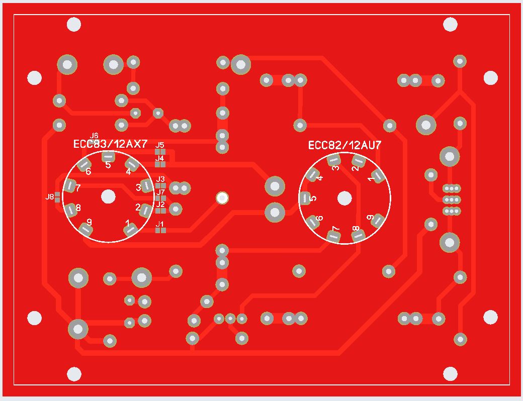

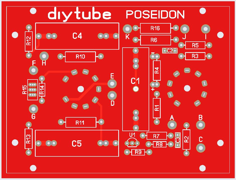

Hi, knowing that pcb's are no longer available, i will do a point to point poseidon circuit based on that design.
Planning on using LM334 for constant current source the 12AX7 input tube.
I saw that 12AU7 driver could be subt. for a 12BH7A, any mods I have to look for this driver stage?
Since Poseidon designer does not sell or follow??? theses boards or circuit, is there recent mods I have to take to before start installing and soldering parts???

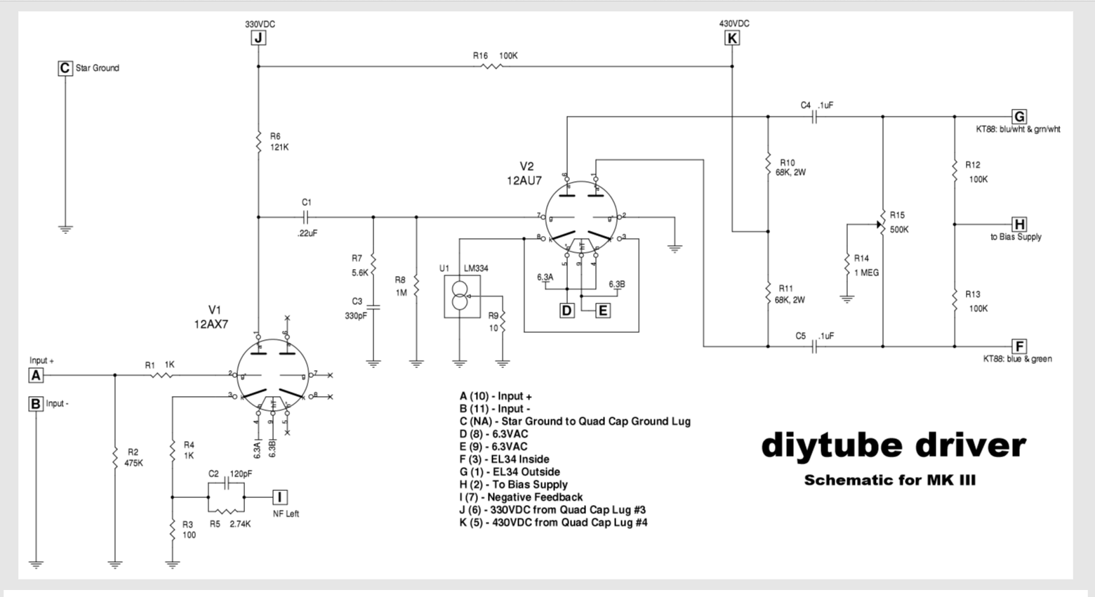

No, the driver stage 12AU7 pins 3 and 8 where U1 LM334 is current source.

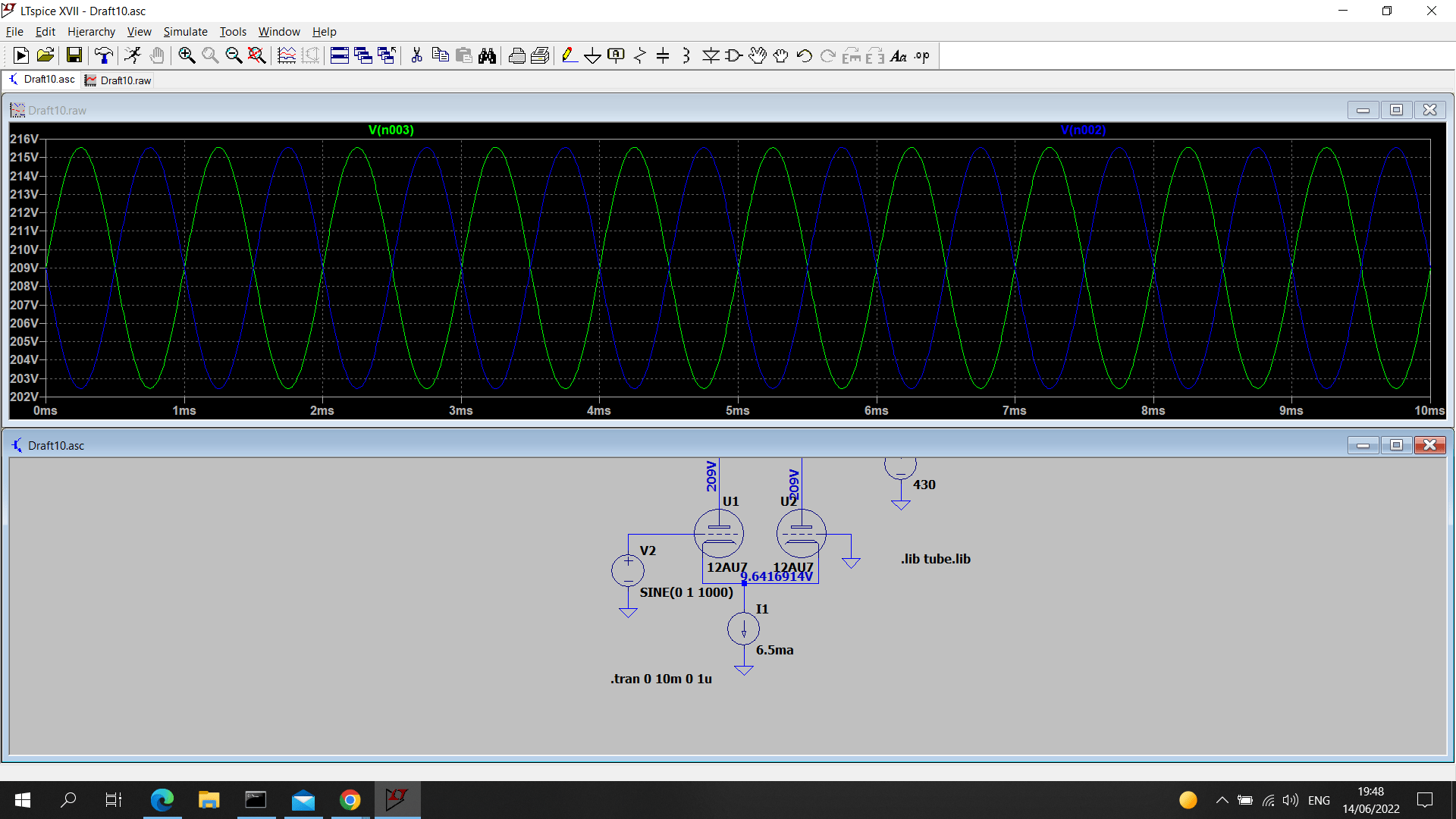

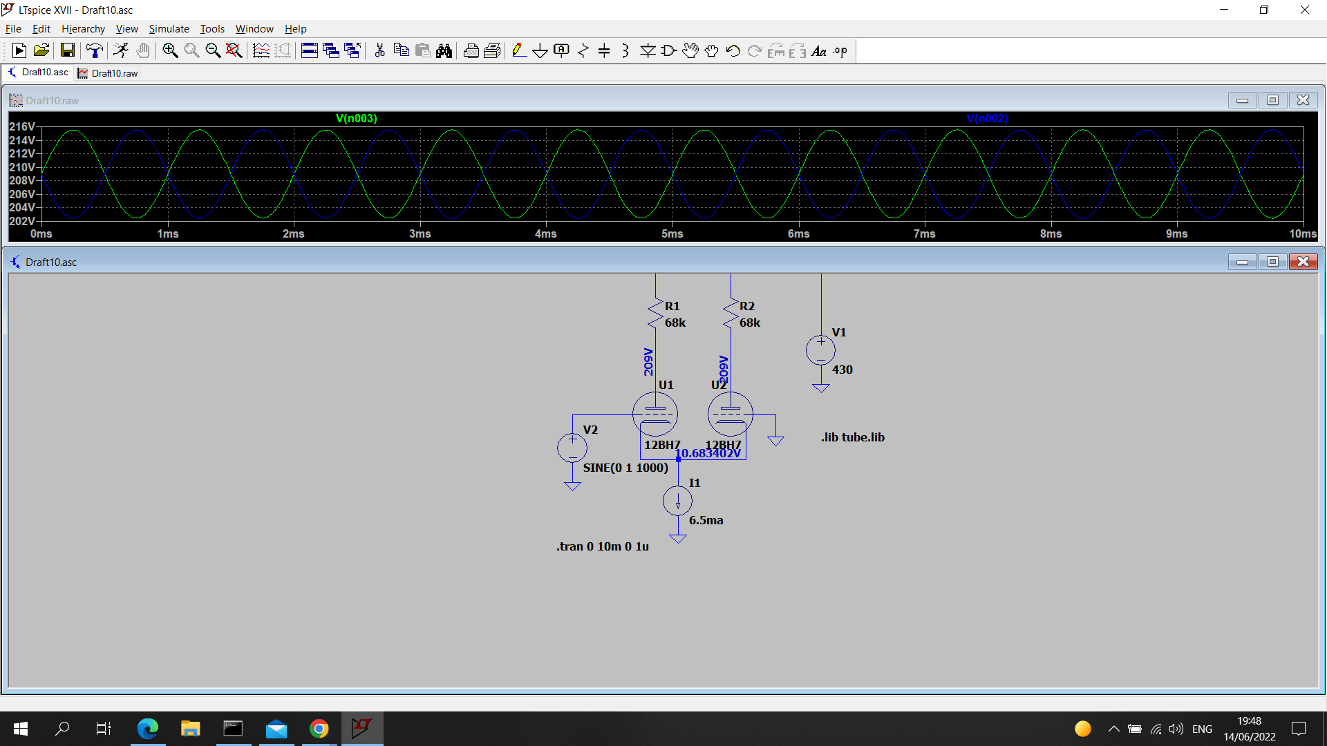

A 12BH7 will work just fine in place of the 12AU7 the DC plate voltage is not determined by the choice of valve (as long as the grid does not go positive) but by the CCS and the 68K. Gain is not much different. Heater current is double however.
