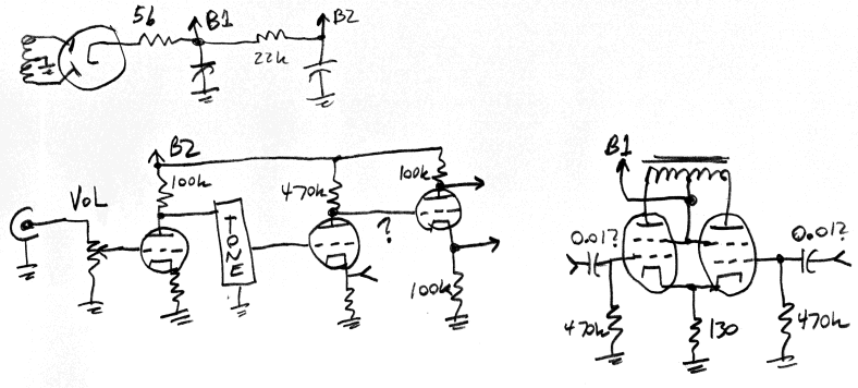

Frank:
It looks like the 22k resistor goes to the EL84 screens.If the resistor is smoking, one or both screens are drawing too much current. Possibly an internal short or a gassy tube.Change out the EL84 tubes.
I Tried 3 different sets of know good EL84's, I also took the original tubes to a known working amp I own to see if my tester is giving me false readings.
The Tubes are confirmed good on both my tester and my other amp.
Heres rough start on the power supply schematic, Im going to try to continue drawing it out as I go.
Schematic
No (I think). Rectifier feeds through 56 ohms to lower-left main cap lug. That feeds both screens and the OPT CT. It also feeds the 22K to the top-right main cap lug, which runs left over an orangish wire to three resistors in the preamp/driver area: 100K to 6C4, 470K to right side of 12AX7, 100K? to left side of 12AX7. Perfectly reasonable values.
Pull the little tubes. In that condition there should be no voltage drop on the 22K. If there is, then cut the orangish wire. If the 22K still shows drop, the top-right unit of the main filter cap is leaking all to heck.

Right Now, I am transferring the circuit off the chassis into a schematic/drawing or at least trying.
I am hoping to remove the electrostatic related components entirely from the unit if possible.

OK, Don't laugh to hard at my pieced together artwork here.
Its at least an accurate rough draft of the PS + components in the output area.
The 22K is indeed 1/2 w and honestly that has to be well under rated. I am actually surprised it lasted the past 40 odd years.
But then again, I guess the real question is why has it smoked now.
I can understand the 56 ohm frying due to the old old electrolytic cap, ( Both have been changed)
But Now, I have the 22K replaced. I Have not applied power however for 2 reasons, #1 I would like someone's second opinion on its wattage rating, & # 2 No sense burning a second resistor needlessly.
Also, I would like to remove as many of the components as possible from the circuit for the electrostatic tweeters as I have no plans to ever use such devices.
Here Is The Rough Draft Schematic
Leave them. The twin capacitors and two 2K7 resistors form a Zobel across the plate winding. It may not need it, but it sure won't hurt the music, and just might be part of the frequency compensation.
Well, no, that can't be right. The output stage fed through the 22K ????
The attached is what it has to be.
Rectifier, 56 ohms, 40uFd, feeds 6BQ5 plates and screens.
22K from there to another 40uFd feeds all the little tubes.
I'm unsure how the 6C4 grid meets the second 12AT7 plate. I don't know what the 12AX7 cathode resistors are, or if they are bypassed. I do think the second 12AX7 cathode must get some feedback from the speaker winding.
If you really have the 22K feeding the 6BQ5 plates or screens, it is wrong. Maybe some previous repair was confused which main-cap lug was which.
EXACTLY!!!
I just rewired it to do so. YES it now is dead silent, and D@mn loud!!
Clearly this baby must have seen a service job that missed slightly, Its no wonder the power cord was cut off. Perhaps the previous owner had been planning on a repair but sadly never got to it.
No matter what, THANKS for your help, It is now fully functional!
Gene
Best of all, 20 minutes and Sniff Sniff " No More Smoke"
