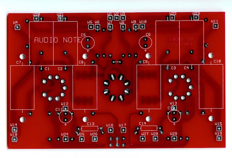

what you have probably saw was a double sided board.
when the circuit is more complex, it is usual to use double sided pcb's. You just have track on both sides, that it!
see this board:
u can see the tracks on the silk screen and a shadow of the other side tracks.
see this board:

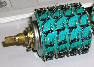

What about those? They are cheaper than Alps and way better. You could install them at the input of your preamp. Check my post: http://www.diyaudio.com/forums/showthread.php?s=&threadid=3279&highlight=Electroswitch
I think for BOSOZ, it asked for either 10K (input) or 5K (output) and as you probably know, I have searched all over the web for a 4-gang pot that's reasonable price and value but so far no luck. Higher K pot are easily obtainable though.
After I build my BOSOZ, I found out that there are a MILLION ways of doing the volume control ... which drives me nuts .... in the sense that how does a newbie know what is a reasonable good value pot for a reasonable price ... not to mentioned that there are stepped attenuators, series & ladder attenuators, 2 gang pot, 4 gang pot, etc, etc ....
