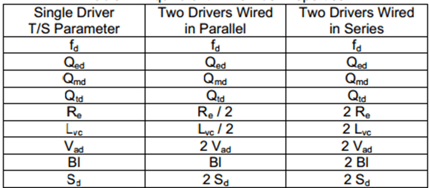

For a dual driver TL, double the Vas. Fs, Qt remain the same. Zd should be set the average position of the drivers.

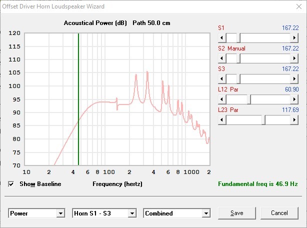

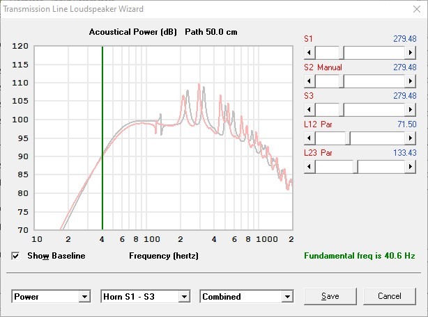

The Seas unit does a pretty good job. The TLDesign tool gives convenient starting options for the sizing of the enclosure if you don't already have something in mind. Longish line length can be reduced by a reasonable taper. The ripple can be modelled and smoothed to taste.

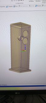

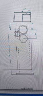

Would two "woofers" design make sense with dual Alpairs 10.3... ?
Im thinking something like this:
crossover at approx 2k
Jim's MLTL design but double volume to account for second driver, all centered like normal and as close together as possible, tweeter on side same as close as possible.
all drivers connected in parallel.
Measurments are in metric mm, used MDF 38mm to add weight and it should be easier to build / paint (+cheaper in CRO then 18mm ply...)
Thoughts ?

yes.. i realize it makes little sense since they are true fullrange (in proper box ofcourse)..
But i already have them (4pcs) and i want to use them all together and jims design and measurments are very impressive to me in the low range, if paired with good tweeter it could be very nice, not ideal but still.
Does this arrangement work as per photos?
