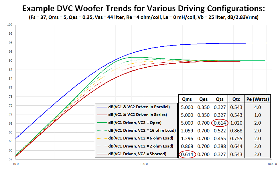

Wow…this thread kinda went off in the weeds.
But it’s an interesting modeling challenge and not discussed often, so figured I might as well post some info taken from my notes on past DVC investigation.
Surprisingly, a lumped parameter model for DVC woofers with individual VC inputs is not easy to find, if at all. A bit of reading (Olson, Beranek, etc) and it is easy enough to work it out for yourself. I can post if anybody is interested, but perhaps a few response trends would be more enlightening than a circuit diagram.
Attachment #1: Comparison of responses for different DVC configurations ignoring VC inductance
- Ignoring Le for the "first look" improves clarity with regards to damping and sensitivity changes.
- Series connection of VCs results in identical frequency response to parallel connection, but -6dB SPL reference level. If input voltage is doubled, the SPL and power dissipation would be the same as for the parallel connection.
- Driving a single VC with the other VC shorted results in the same frequency response and SPL reference level as the series connection, but requires twice the power dissipation.
- When driving a single VC, note that Qts for the open VC2 case is the same as Qms for the shorted VC2 case. This is not a coincidence. In both cases, the electrical damping from one VC is being lumped together with the mechanical damping. Whether parallel, series, or shorted VC configuration is used...once you get electrical damping from both VCs combined with the mechanical damping you wind up with the same Qts. In the lumped model all damping resistances are in parallel. It’s just a matter of T/S parameter book keeping whether electrical damping from one of the VCs gets combined with the other VC damping(Qes for the series and parallel configs), or the mechanical damping(Qms for shorted VC config).

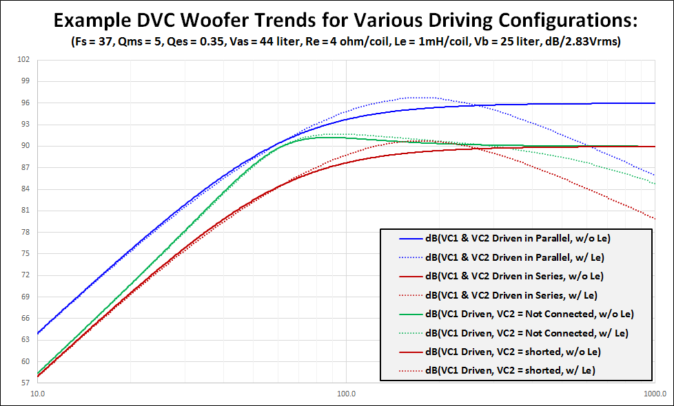

Attachment #2: Comparison of response for DVC configurations with and without VC inductance.
- All observations for Attachment #1 above still apply.
- No change to high frequency response with shorted VC compared to series/parallel configurations.
