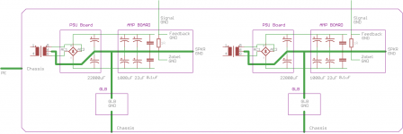

So does the following layout make more sense?
The changes are:
(1) One aluminimum flat is used as the PSU common.
(2) Speaker negative wires go directly to the PSU common (and the Zobel).
(3) Earth is connected directly to the chasis below the power socket.
(4) Single wire from PSU common connects to the star which is connected to the circuit common, interconnect shields and the chasis.
Since 2 bridge rectifiers are used so the centre taps of the transformers are not connected to the PSU common.
With both PSUs in the monoblocks sharing the same aluminium flat would it introduce more cross-talks? What about the circuit commons share the same star?
Bill
Seems to be reasonable for me.
There is still room for detail discussions, but more
detailed analysis is difficult for me as long as I do not
sit myself in front of the particular amp.
Cross talk due to the shared aluminium flat should be uncritical.
...(as long as you don't need more than 90dB chanel separation)...
Good luck
Markus

the only ground wire that needs to be bigger than 24awg is the interconnect from PSU common to power ground.
Remember to take ALL your speaker returns and decoupling caps and Thiel(Zobel) networks direct to the power ground.
AndrewT, can you comment on this? Shouldn't the zobel ground go to the same star point as the speaker and signal grounds, rather than the power ground? The power ground is the dirty one, and since the zobel is connected on the other end to the output of the amp, it is thus RC-coupled to the negative feedback of the amp. My thought is that this could inject noise if the ground reference of the zobel is not the same as signal ground.
the dual polarity PSU has three terminals:
+ve supply
-ve supply
Zero Volts
You take three wires from the PSU to the Amplifier PCB.
On the Amplifier PCB you have three power terminals:
+ve supply, -ve supply and Power Ground.
The Zobel does not pass Audio Signals.
The usual frequency roll-off (F-3dB) is >100kHz and often around 200kHz.
These HF currents need to be returned to the low impedance of the Power ground as close the the decoupling ground as you can get them.
What surprises me is that I was talking about this over 12 years ago and still many Builders take their reference back to the PSU smoothing capacitors where the charging current pulses dominate.
I think we might be talking about the same thing. Do you agree with this diagram?
............. the currents through the zobel come directly from the output transistors,
and thus the Zobel currents must retyrun to the source in this case the output transistors.
so I would think the return currents are wanting to return to the same place as the speaker and input references.
no. The Zobel has to use the lowest impedance route back to the source of the current. That lowest impedance route is via the HF+MF decoupling ground through the HF & MF decoupling capacitors to the output devices.
The HF+MF decoupling ground is the Power Ground of the amplifier.
Then analyse the route the speaker current takes from the output devices.
this drawing does not use best practice.
