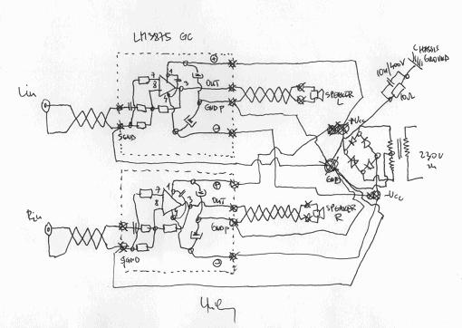

I finished my GC yesterday and it sounds incredible through my KEF speakers. My problem is that when both input cables are plugged into CD player, there is a slight but annoying 60 Hz hum. When only one or none are plugged in, the amps are silent. I'm using a single torroid PS and two seperate amp cases. CAses are plastic w/ foil lining. I have no attenuator and am going to place a 47K resister and 100pf cap across inpot to signal ground although, I believe this only avoids problems when no input is present.

Can you draw an actual diagram of your ground arrangement? Please include all parts from your amp that should be grounded.
Until now all cases here from people complaining on hum could be traced to an incorrect (loop) star grounding.

sounder said:I'm using a single torroid PS and two seperate amp cases.
David
Hey David,
Sorry to give you the bad news, but that doesn't work.
If you have a single PSU for both channels you have to run a very short (and thick) wire from one channel's star ground to the other.
Impossible to do with two separate boxes.
In your implementation you have a huge ground loop.
Or put the two channels inside one case or buy another toroid and use an independent PSU for each chanel.

Thanks for all the input guys, I have reconfigured the amp wiring twice since I posted this. I'm beginning top see the light now and there IS a huge ground loop from one star ground through the two outputs at the CD back to the other star ground. That's why it is dead silent with only one input plugged into the CD. So I'll live with the hum...which actually distorts the lows and mid-low..a kind of rumbling break up. Too bad none of the schematics point this out. What does 47 Labs do with the Gaincard and the standard single humpty configuration?

sounder said:Thanks for all the input guys, I have reconfigured the amp wiring twice since I posted this. I'm beginning top see the light now and there IS a huge ground loop from one star ground through the two outputs at the CD back to the other star ground. That's why it is dead silent with only one input plugged into the CD. So I'll live with the hum...which actually distorts the lows and mid-low..a kind of rumbling break up. Too bad none of the schematics point this out. What does 47 Labs do with the Gaincard and the standard single humpty configuration?
First of all Thorsten's IGC schematics do point out how to handle your star grounds.
Second, I don't see why you have to live with the hum if you have identified the source of it. Why not correct it?
The Humpty supply, as far as I know, is not a complete mono one. But I'm sure they do provide a way to handle likely ground loops.

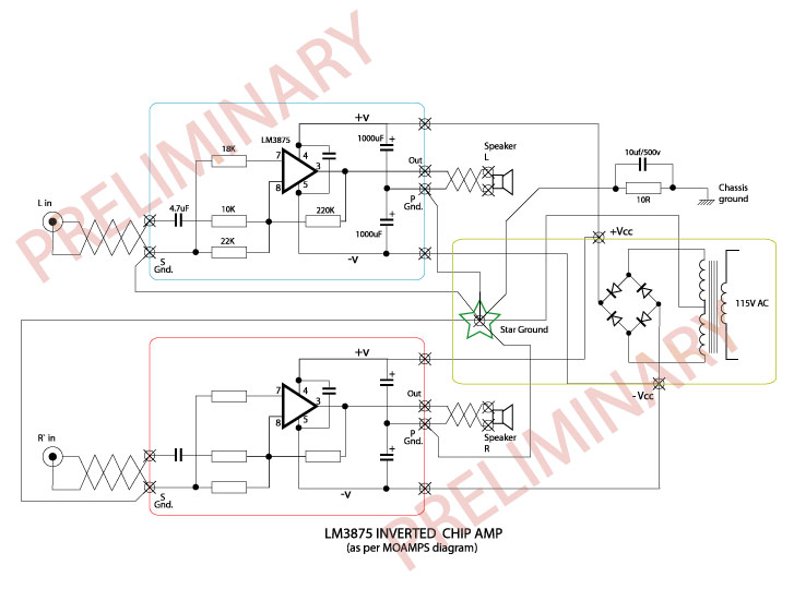

separating power ground and signal ground from monoblocks to PS will help (one more wire for signal ground from each block). IMHO

MOAMPS, Thanks for the time and the input. I layed out your diagram in Illustrator (it's one of the things I do in my other life)and will post it if you don't mind as soon as I figure out how to. Still puzzled at how to attach it so it displays in the post?
Anyway, iIf one uses a seperate power supply case, must the star ground be in that case, and if so, would I run two ground wires from ea. amp to the star ground in addition to the +V amd -V. Is that a correct interpretation of your diagram?
Regards David
sounder said:MOAMPS, Thanks for the time and the input. I layed out your diagram in Illustrator (it's one of the things I do in my other life)and will post it if you don't mind as soon as I figure out how to. Still puzzled at how to attach it so it displays in the post?
I don't mind.
Go to the bottom of your reply page to attach the file.
You've got it.😉

Just realized the bridge rectifer is drawn incorrectly.
Any suggestions or corrections welcome

Take that back ..they check out w/ Moamps diagram.
