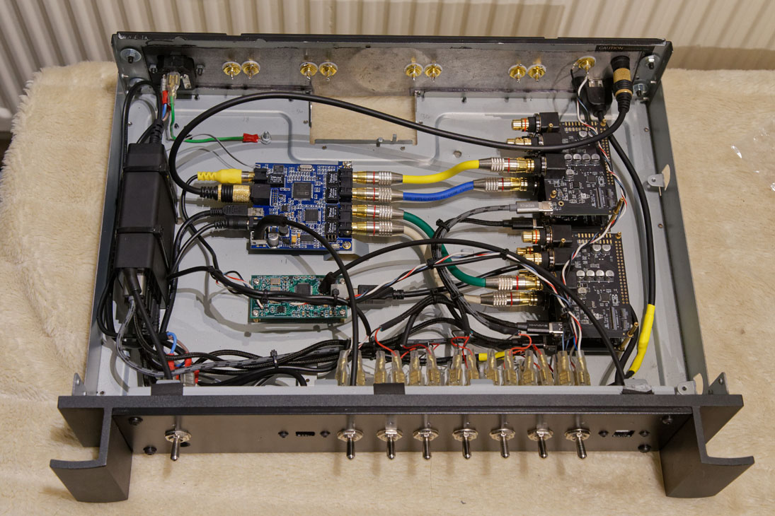

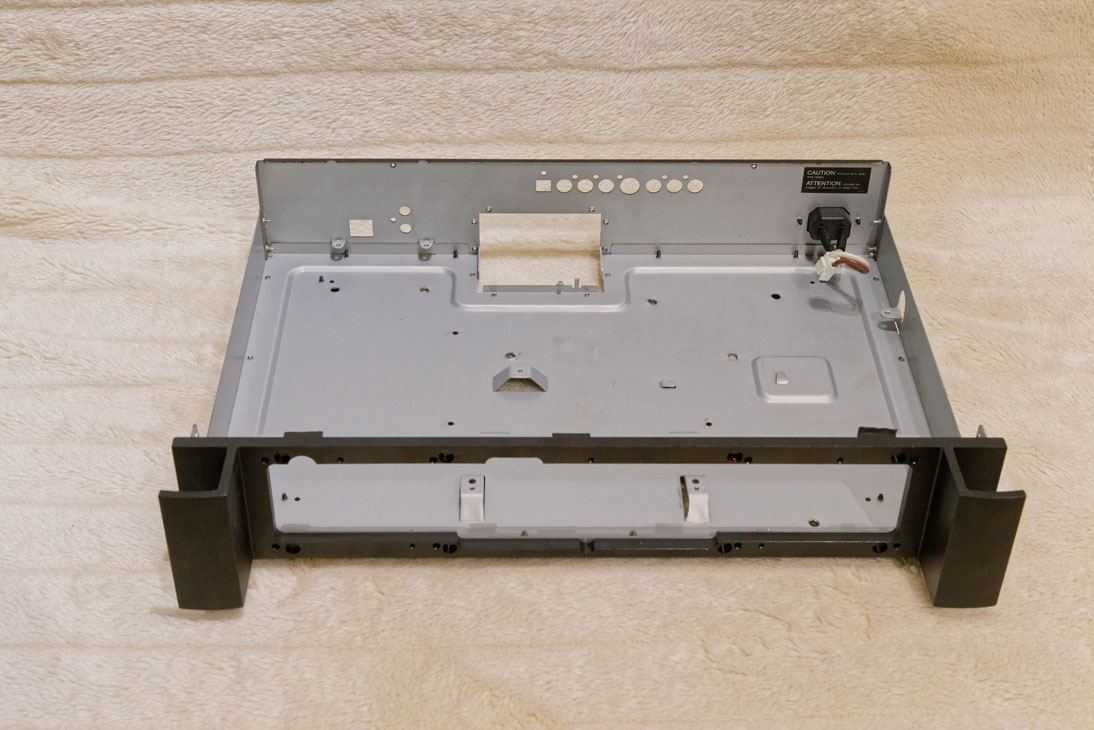

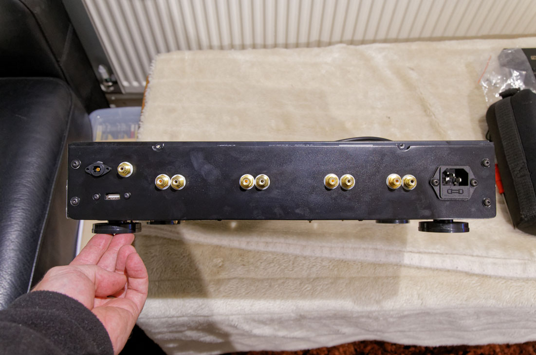

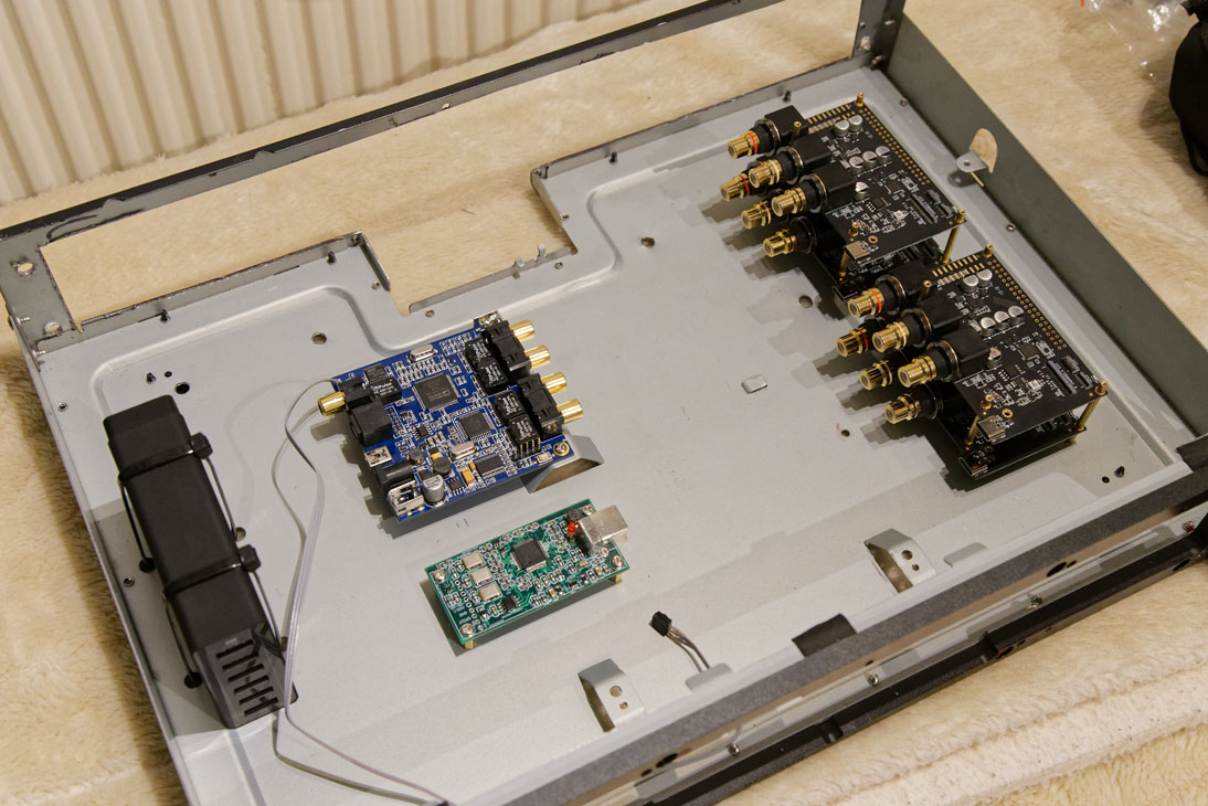

Thought I'd share my DSP project just in case it is of use to anyone. This will initially be used to merge my active monitors and twin subs and sort out room EQ, but when I get some time I plan on using it for some three way speakers.
Pictures below.

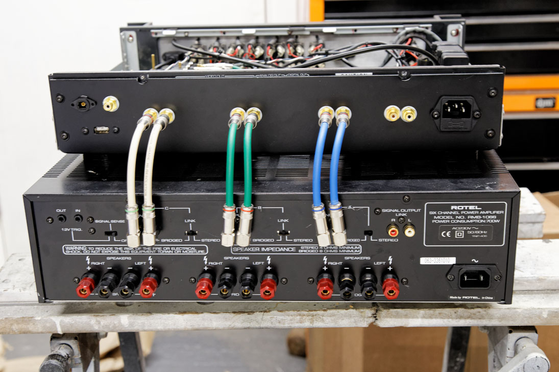

Chassis - I have Rotel RMB1066 6 channel power amps (x2) so wanted something to match (ish) so bought a "for spares" Rotel RDV1060. This is really nice as you can remove the front fascia, tap some exiting holes, add a plate of aluminium and make it look nice. Rear is similar, just chop out the back and add a plate.
DSP - I only have digital sources so got a Minidsp Nanodigi
miniDSP Kits : nanoDIGI 2x8 K
Dacs (x4) - Khadas Tone Boards
Tone Board: Hi-Res Audio Board Designed for Music Fanatic.
USB input - the minidsp does not take usb streaming so bought an ebay XMOS208 input board that had a spdif output all ready to solder
U208 XMOS USB Digital Interface DAC Decoder Module Support for PCM DSD New | eBay
Powersupply - Anker 6 port USB 60W charger - measurements here - Test of Anker 60W 6-port A2123
Anker PowerPort 60 W 6-Port Family-Sized Desktop USB: Amazon.co.uk: Electronics

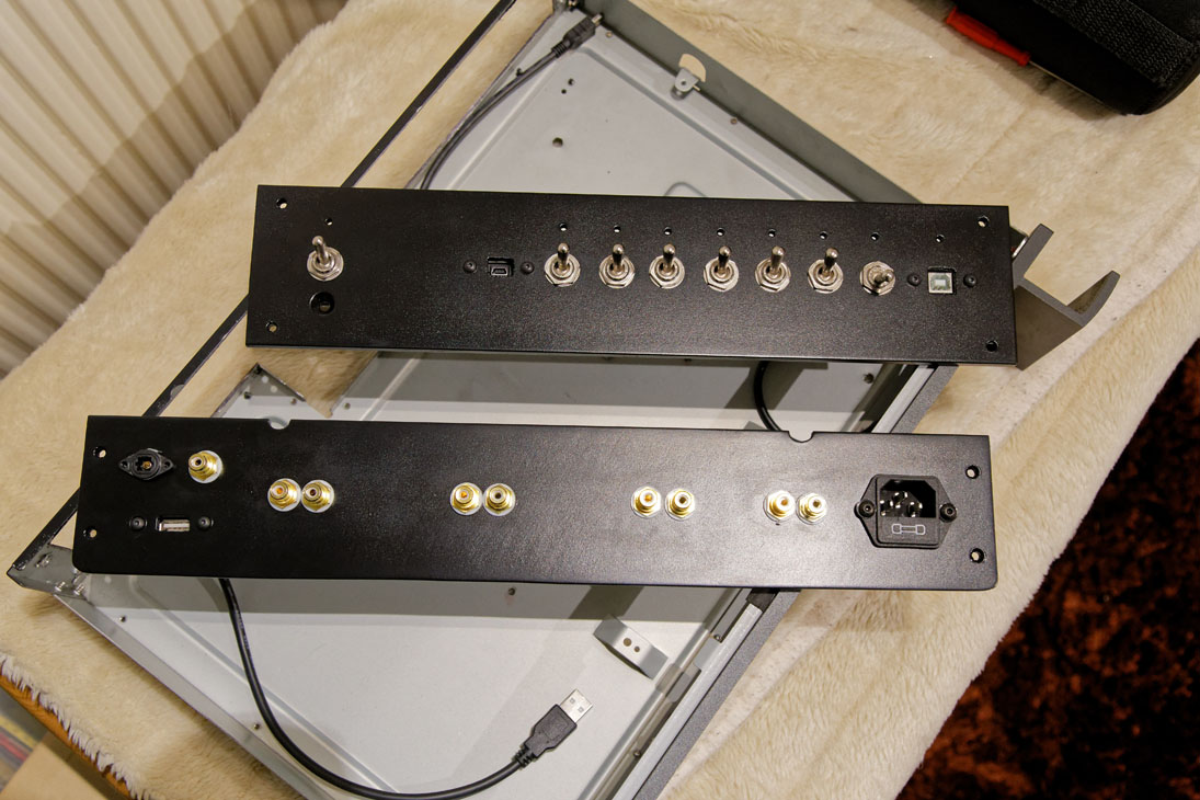

Complications - I wanted to add the following function which have complicated it a bit -
Case done, front and rear panels done and painted in satin black, all switched etc. and main boards mounted. Power connected, coax from DSP to DACs done. Tested Power, DAC and USB - all work fine.
Still to do -
Wire DACs to rear panel
Find a power fuse to fit (seems to be smaller, maybe european?)
Add power indicators
Download and istall Minidsp software and check DSP out.
Ideally I will remake the front and panels using laser cutting but hand made is fine for now.
Anyway, there's my little project, all comments welcome (and no, tidy wiring is not my strong point).
- Rear IEC three pin fused power socket and Front master switch to Anker PS.
- Individually turn the DSP and DACs on/off.
- Switch between a rear COAX SPDIF and the USB SPDIF.
- Rear Toslink
- Space the rear analogue output sockets the same as the RMB1066
- Use the final Anker port for a rear USB power socket (for powering my Chrome Cast Audio).
- Power lights for each item (combination of LED bulbs and fibre optic light pipes).
- Re-route the Minidsp IR sensor to the front panel.
- Front usb port for DSP programming and front port for USB streaming
Still to do -

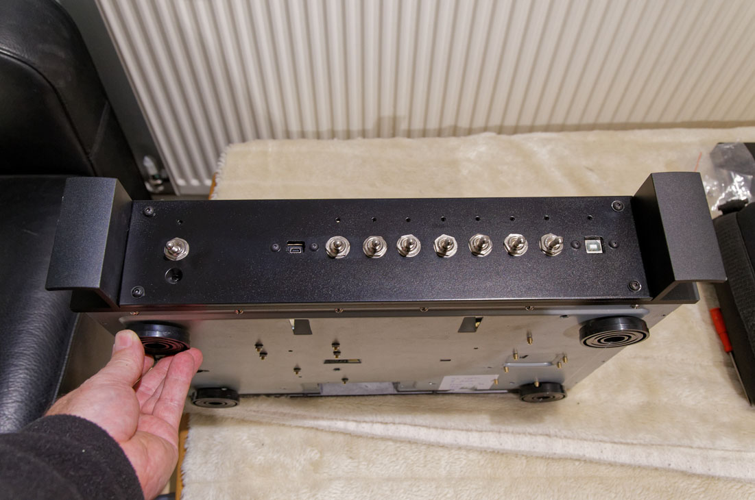

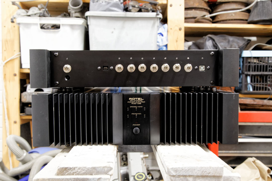

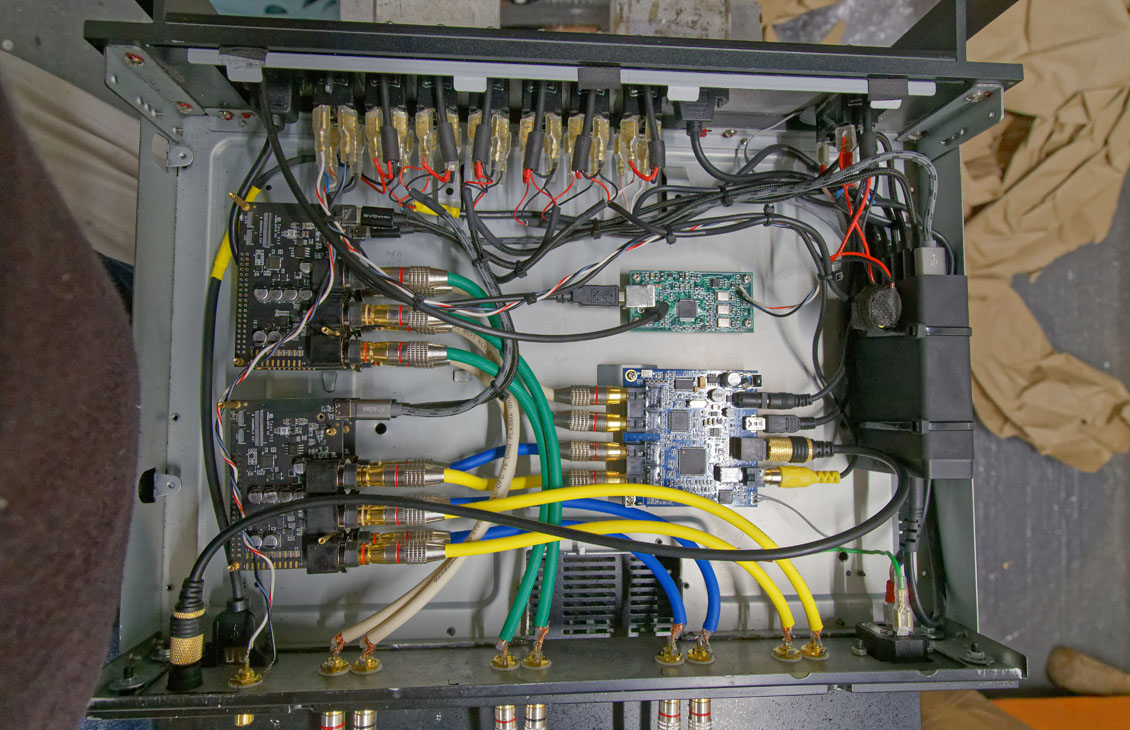

Quick update
Finished the wiring and have added LED light to each of the power circuits including the mains power (small 240vac>5v DC power supply to driver the LED). Also made up some cable to mate it to the RMB1066.
Waiting for the final piece (fuse for mains power), the can start to play with the DSP.
Pics attached (apologies for the quality, garage is quite dark).
All comments welcome.

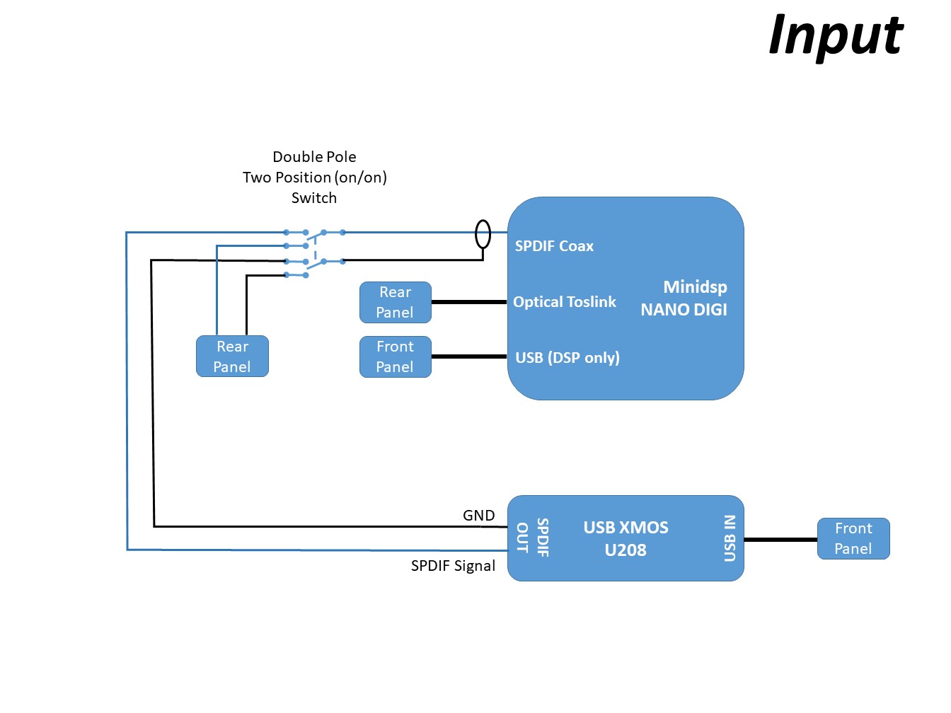

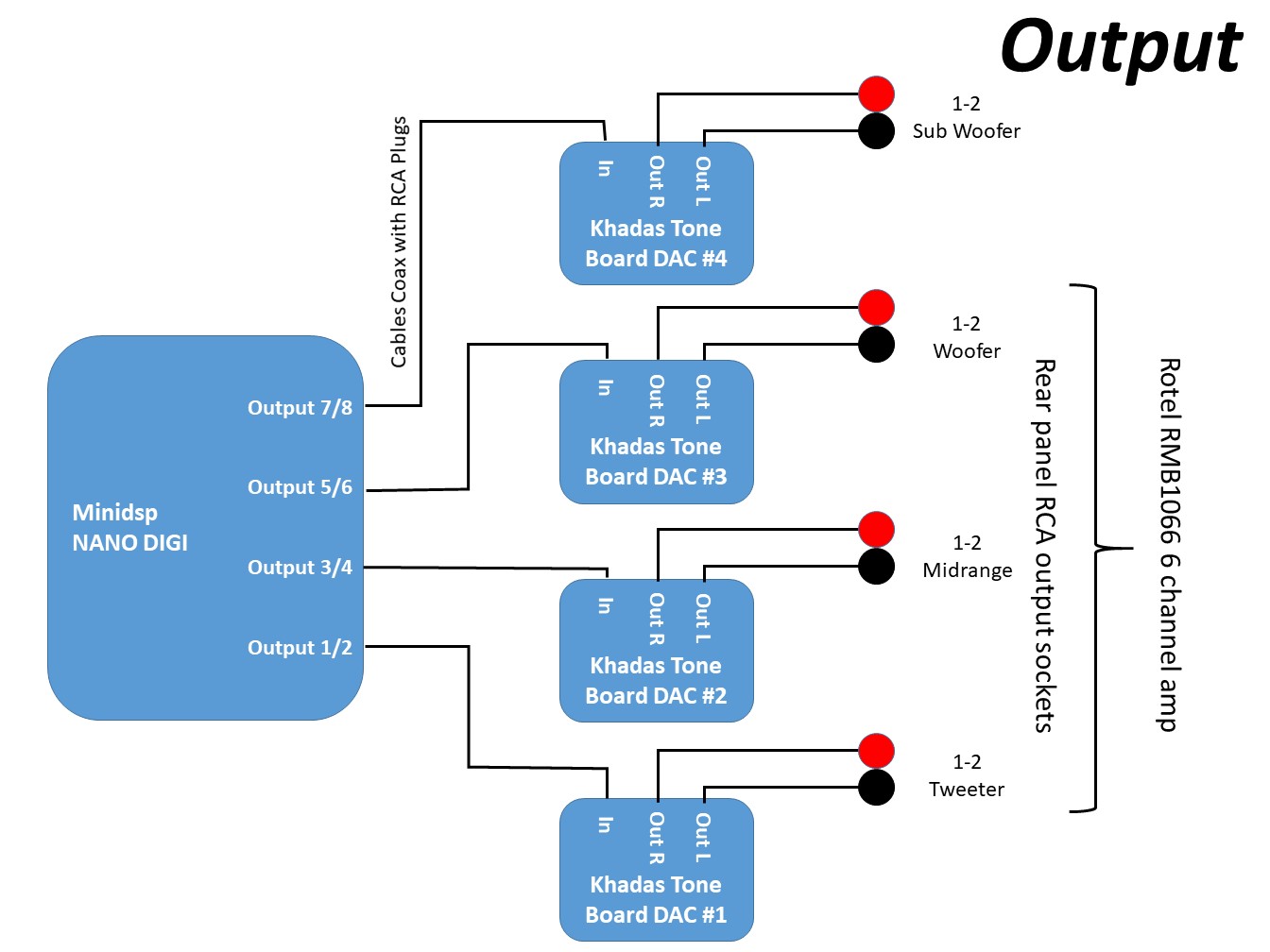

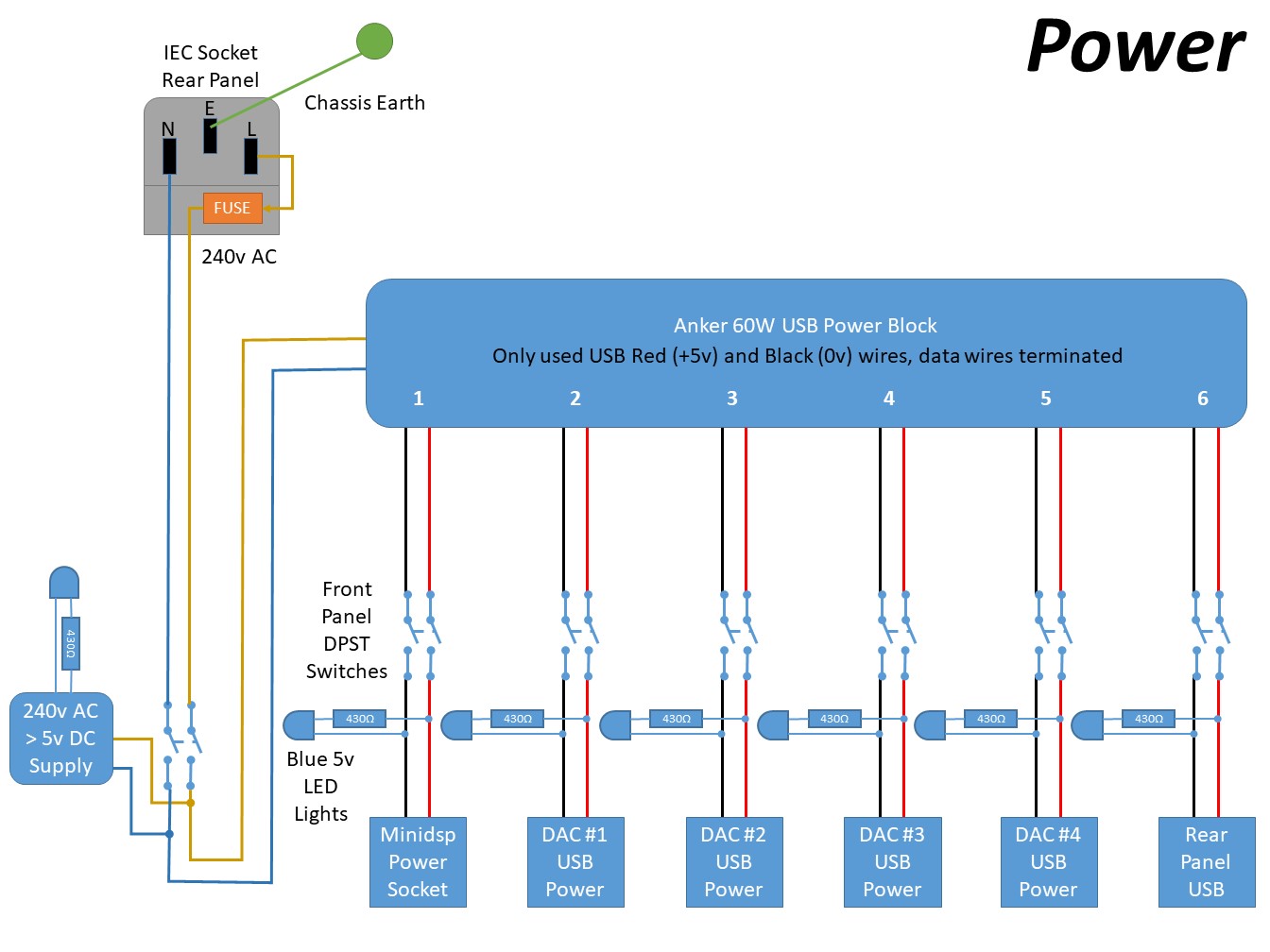

Ugg10,
Can you quickly draw out a SCHEMATIC diagram on how you interconnect all the different parts so that the viewers here can have a good understanding of what you want to how you achieve your objectives?
An explanation of the schematic would also help. Thanks.

Managed to get some time tonight to finish this off.
Attached are the circuit schematics - one for power, one for input and one for output. It was all too messy putting it on one. Hopefully you can follow this and match it up to the photos.
Any questions please ask away.
I'll post some more thought once I have had time to play with the settings (may be a few weeks though, sorry).
Thanks for a brief explanation and schematic diagrams, seem fine with me like they say as clear as mud.

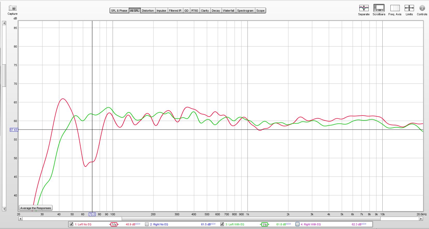

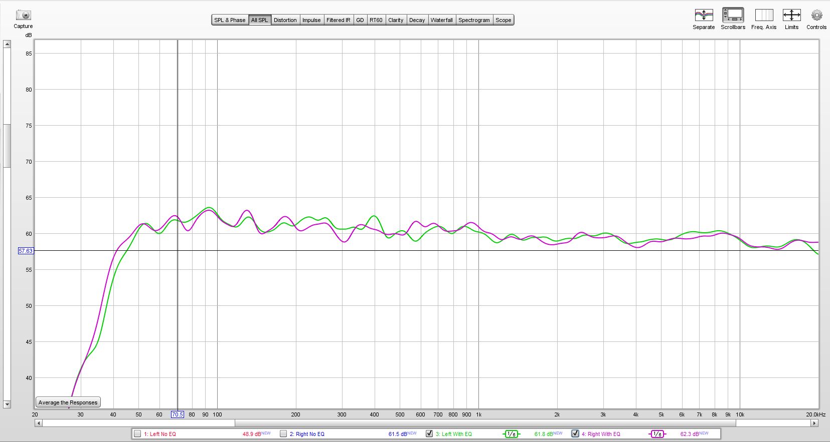

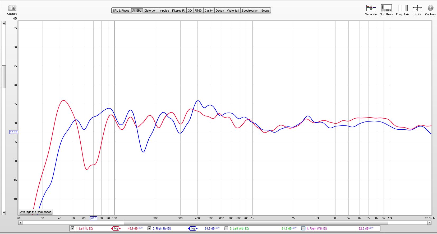

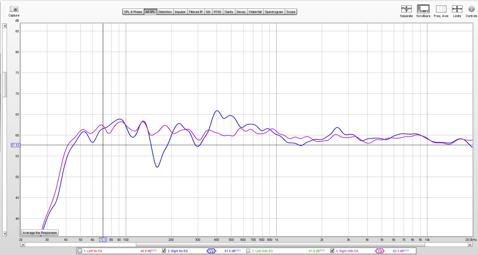

Another update -
Finally got the fuse for the power socket (odd 20mm size) and have been playing with it today.
All works very well and learned REW and the Minidsp software quite quickly (well enough to set a crossover, take measurements and do a bit of EQ).
Using it at the moment with my Mackie HR824 active speakers and two Wharfedale SW150 subs placed under the speakers so in stereo. Therefore only using 4 channels.
Below are a few pics,
1) finished with lights on
2) REW before and after graphs for left and right channels
The sound comparing with and without room eq and a bit of profiling is night and day (had the two versions set up on Source 1 and 2 then volume matched them with pink noise so could compare). With Eq it is clearer, cleaner and has a very dynamic bass plus I think soundstage is better. Happy Chappy!
