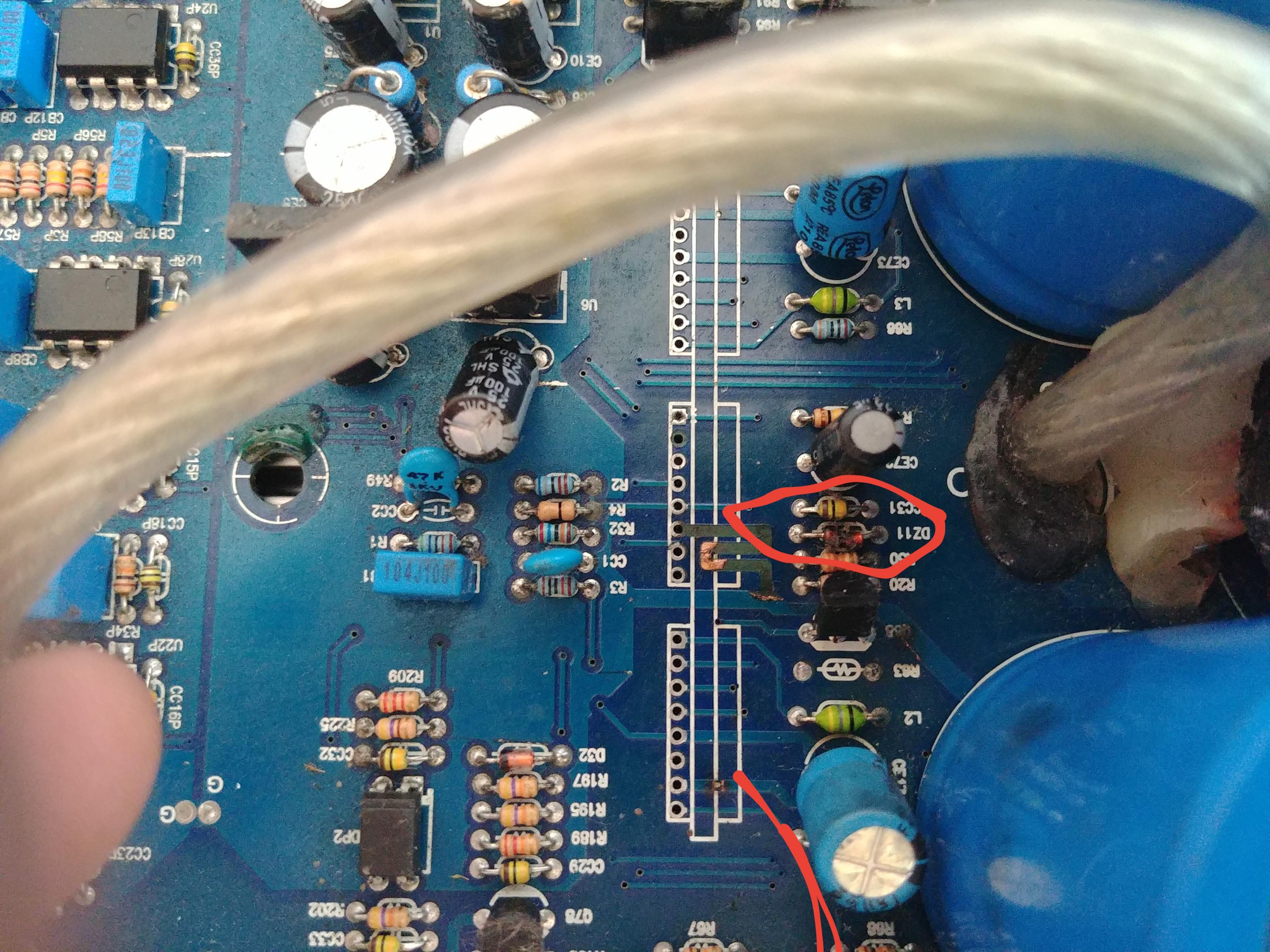

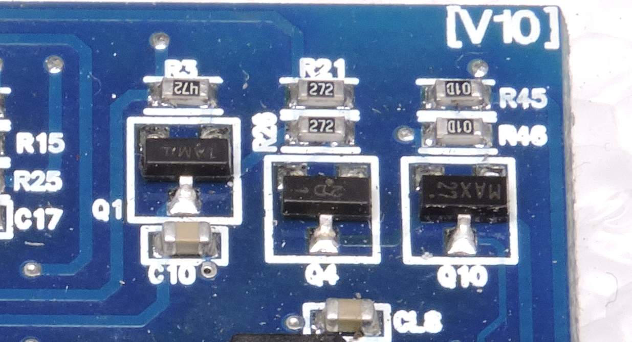

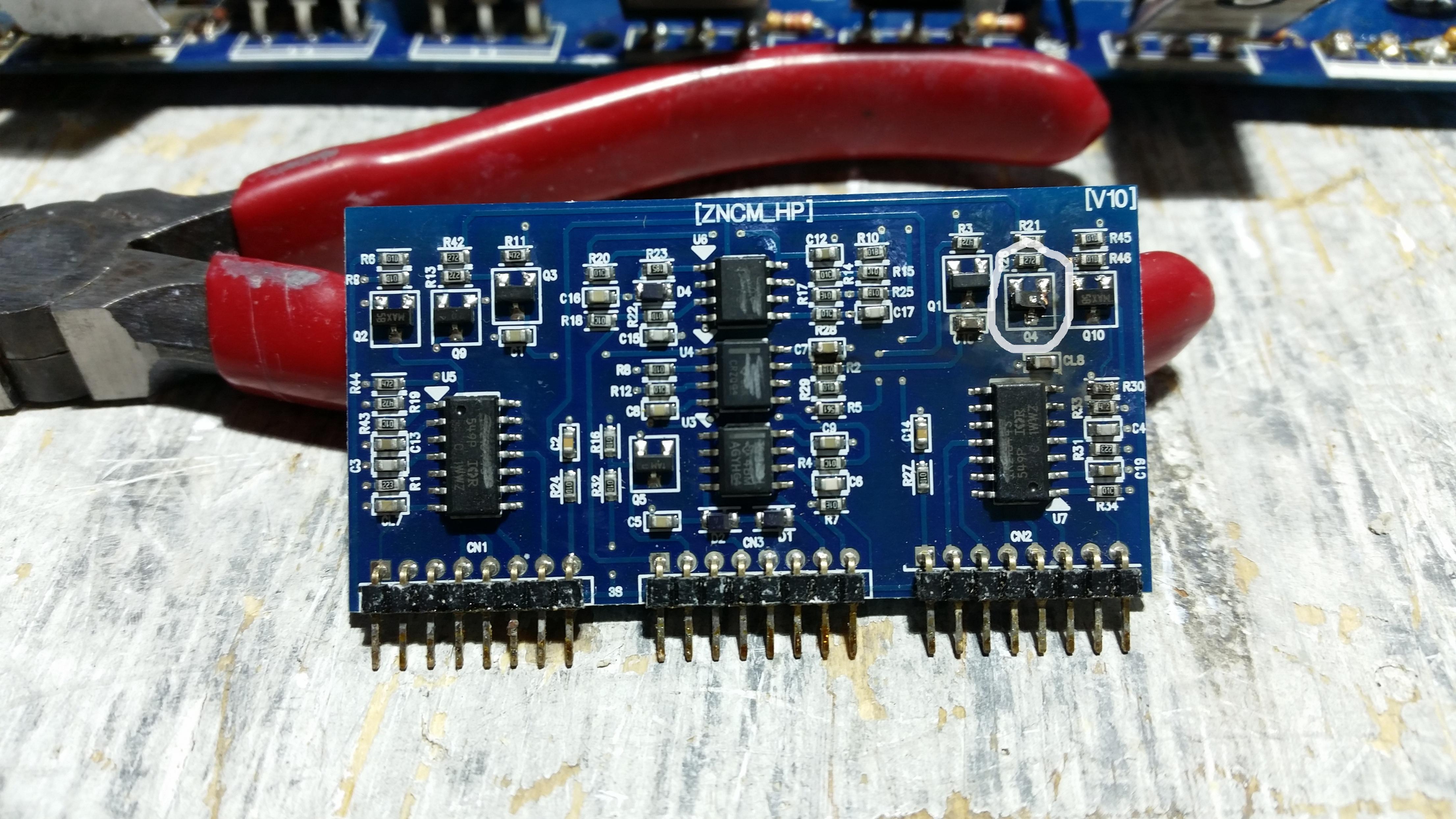

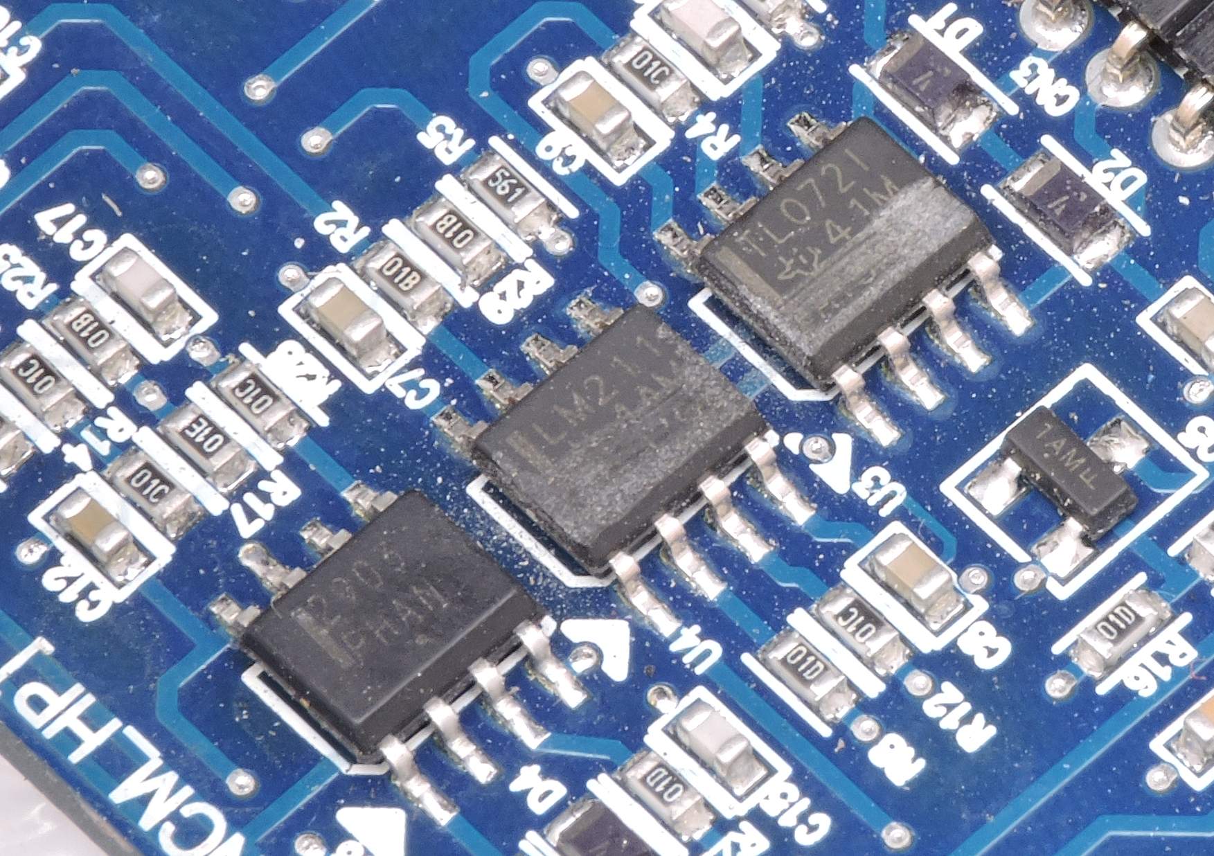

Hello! Please help me to identify the value of a zener diode dz11. A 6kw mono amp. Thanks...pls see attached image.
T thebasser Member Joined 2018 2020-08-27 12:45 pm #2 2020-08-27 12:45 pm #2 Are you still needing the value of zener diode dz11? N nonprof Member Joined 2011 2020-08-27 8:26 pm #3 2020-08-27 8:26 pm #3 Hello! Yes pls! Do you have schematic? Can we trade? T thebasser Member Joined 2018 2020-08-28 2:48 pm #4 2020-08-28 2:48 pm #4 No, I do not have the schematic. I have a similar board the zener diode is a 1n5231B (5.1v). Can you help me identify a transistor on the drive board? Q4 (circled) top right corner between Q1 and Q10 Attachments 20200828_091015.jpg 1,017.6 KB · Views: 122 P Perry Babin Member Joined 2003 bcae1.com 2020-08-28 3:31 pm #5 2020-08-28 3:31 pm #5 See attached. Attachments DSCN9749dvffd.jpg 127.6 KB · Views: 117 T thebasser Member Joined 2018 2020-08-28 5:13 pm #6 2020-08-28 5:13 pm #6 thanks Perry, do you know what U3,U4 and U6 are? Board got hit good, would like to relpace all Ic's. I know U5 and U7 are ir21844s P Perry Babin Member Joined 2003 bcae1.com 2020-08-28 5:21 pm #7 2020-08-28 5:21 pm #7 See attached. Attachments DSCN9762dfs.jpg 338.2 KB · Views: 113 T thebasser Member Joined 2018 2020-08-29 12:54 pm #8 2020-08-29 12:54 pm #8 Thanks Perry, you saved me again Attachments images.jpg 7.2 KB · Views: 88 You must log in or register to reply here. Share: Facebook X (Twitter) LinkedIn Reddit Pinterest Tumblr WhatsApp Email Link Home General Interest Car Audio Ds18 china amps
