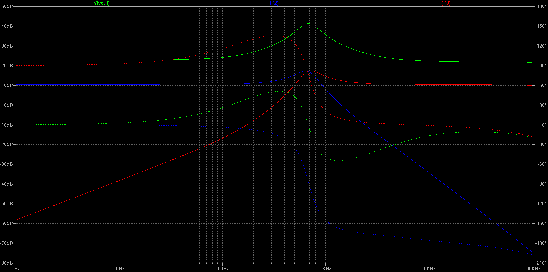

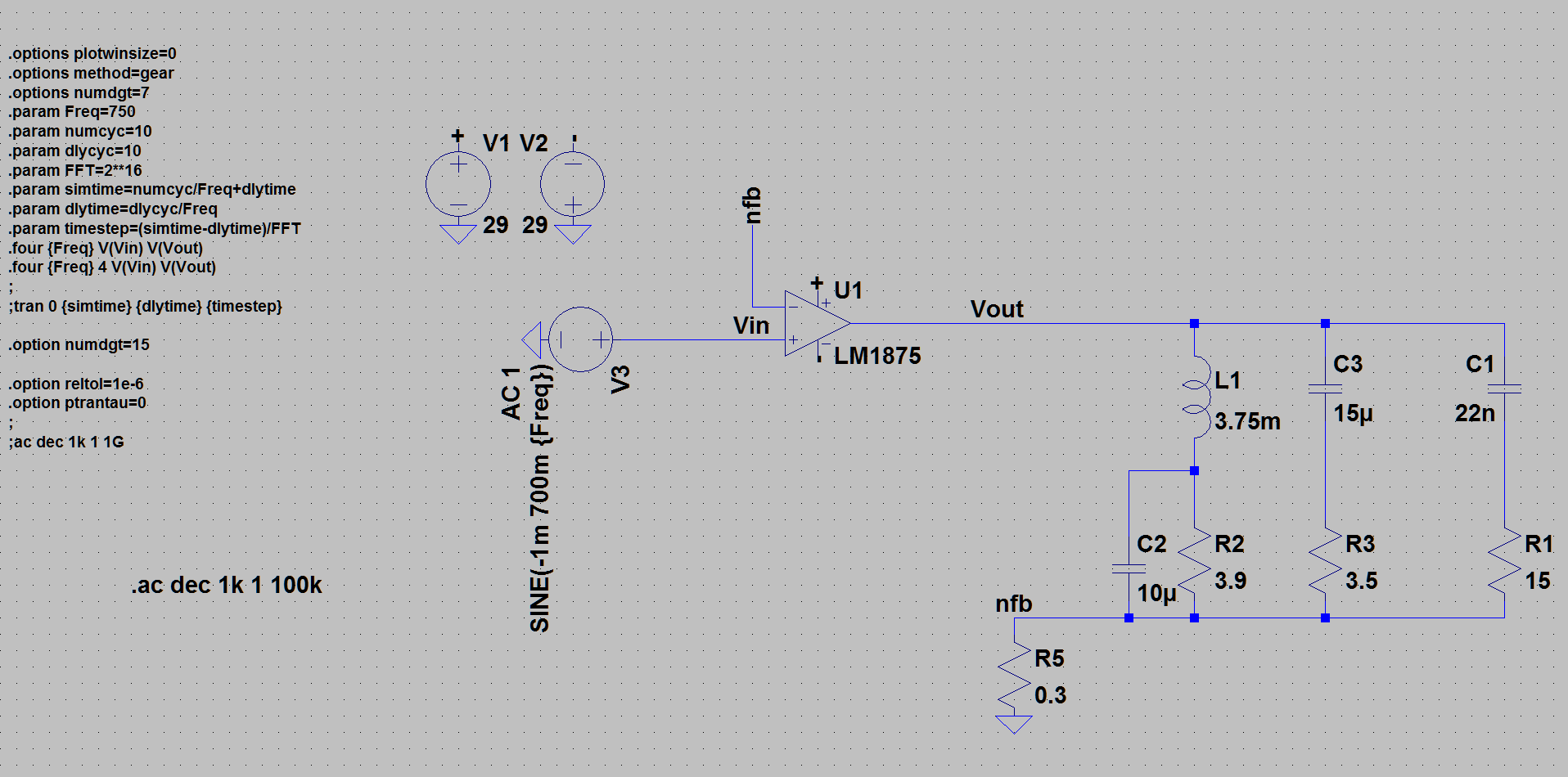

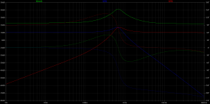

Dear Sreten!
for me, maybe I am wrong, in the case, DF = Zload/Zsource = 8 Ohm/ 300 Ohm = 0,02(6)
for Maggies; 2,7/300 = 0,009 where 2,7 is HF speaker resistance
Regarding those serious issues, maybe it exists but I experienced lots of loudspeakers showing only light sound coloration with transconductance amp.
But why Maggies are playing completely different having flat impedance/phase vs frequency?
I guess that 10uF cap parallel to LF woofer from the crossover has big impact on high output impedance of transc amp?

Damping factor = Zsourse/Zload.
The maggies will be different if the impedance is not totally flat.
rgds, sreten.
No, you have it upside down. Zload/Zsource.
