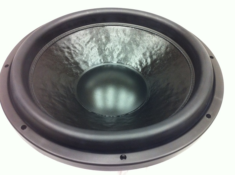

Stereo integrity HT 15" Dual 2/4 Ohm subwoofer
Stereo Integrity HT 15" Subwoofer - Google Search
Thanks for waiting... :D
picked up a 1260W for $49 shipped...that just seems wrong. So cheap. I am going to plug her into winisd tonight. I am going to reduce the volume of my enclosure to 4 cubic feet with blocking and see what happens in all likely hood. With an FS of 23hz I should be able to get an F3 near 20hz if I tune below FS......wish me luck.

thats some serious 13mm xmax.
You'd need a HUGE port to prevent chuffing at higher volumes.
Use a shelf port so it isn't as long as a standard round port (8" diameter maybe by 36.8" long for 2 driver in shared box).
Nice pick of a driver though for the cash.

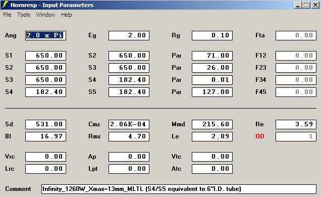

With bracing, driver displacement and port displacement I got my enclosure right at about 4 cubic feet. Here is what I came up with
4 cubic feet
Tuned to 23 hz
4 " port 13" long gives vent mach of .10. I will flare the port
F3 right at 20 hz.....
Not too shabby for a $49 dollar driver. I should have it up and running in a week. I am fairly confident it will sound pretty good.

at what power level ?
Their own paperwork has 1 driver in 2ft3 tuned to 32hz with a 4" port, and you can see the excursion isn't lessened very much at 300 watts. A larger port will lessen the excursion, and it will sound better.
You want to use 2 drivers and tune lower with a single 4" port ?
I don't consider my dual 15" with 8mm xmax (in single box) to have enough port area (4" diameter) for a 27hz tuning................
I've used dual 18's with 4.3mm xmax in a shared box with a 12" port for a 27hz tuning.
But it's up to you.

I am using a single driver. I think the 4 inch port is adequate.

The 1262 and the 1260 are, according to infinity the same driver with the only difference being the dual voice coil. According to my research, they are the same price as well. I could have gotten the 1262 for $50 shipped too.....I got the 1260 for ease of installation...straight 4 ohm.
I built the box, after bracing, port displacement and driver displacement it was roughly 4.1 cubic feet. I used a four inch port 16 inches long to tune it to 23 hz. I stuffed it with 4 pounds of polyfill. I only have 150 watts rms going to it, but it sounds wonderfull and the cone barely has to move to provide substantial output. I think I need a much larger amp. This box is too heavy to move myself is one of the drawbacks tho.
