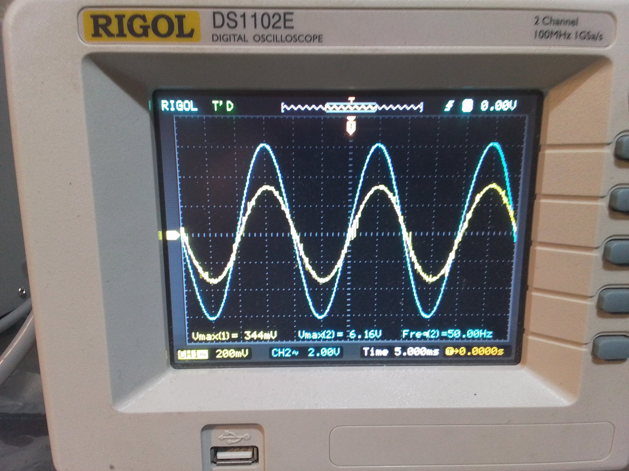

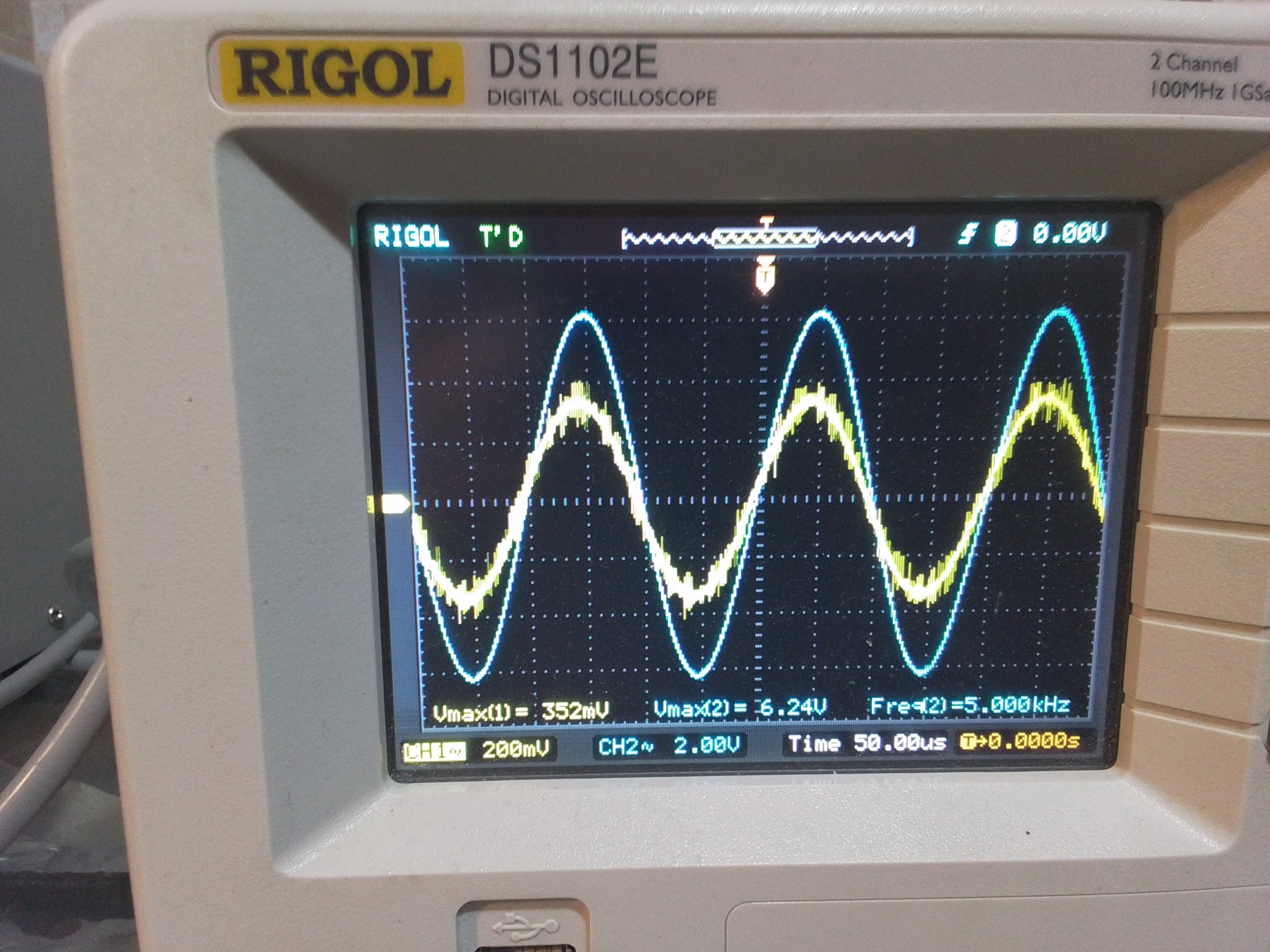

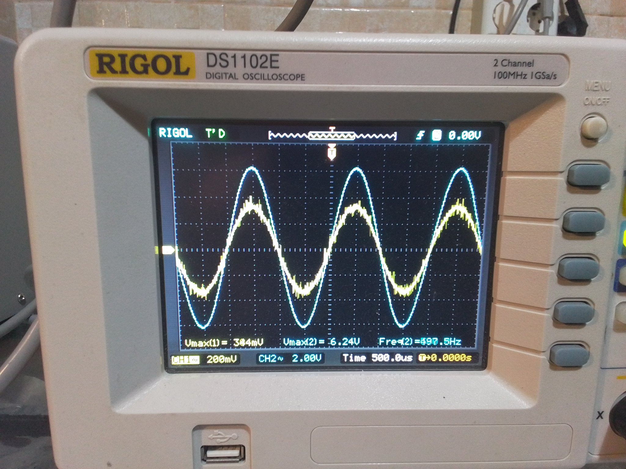

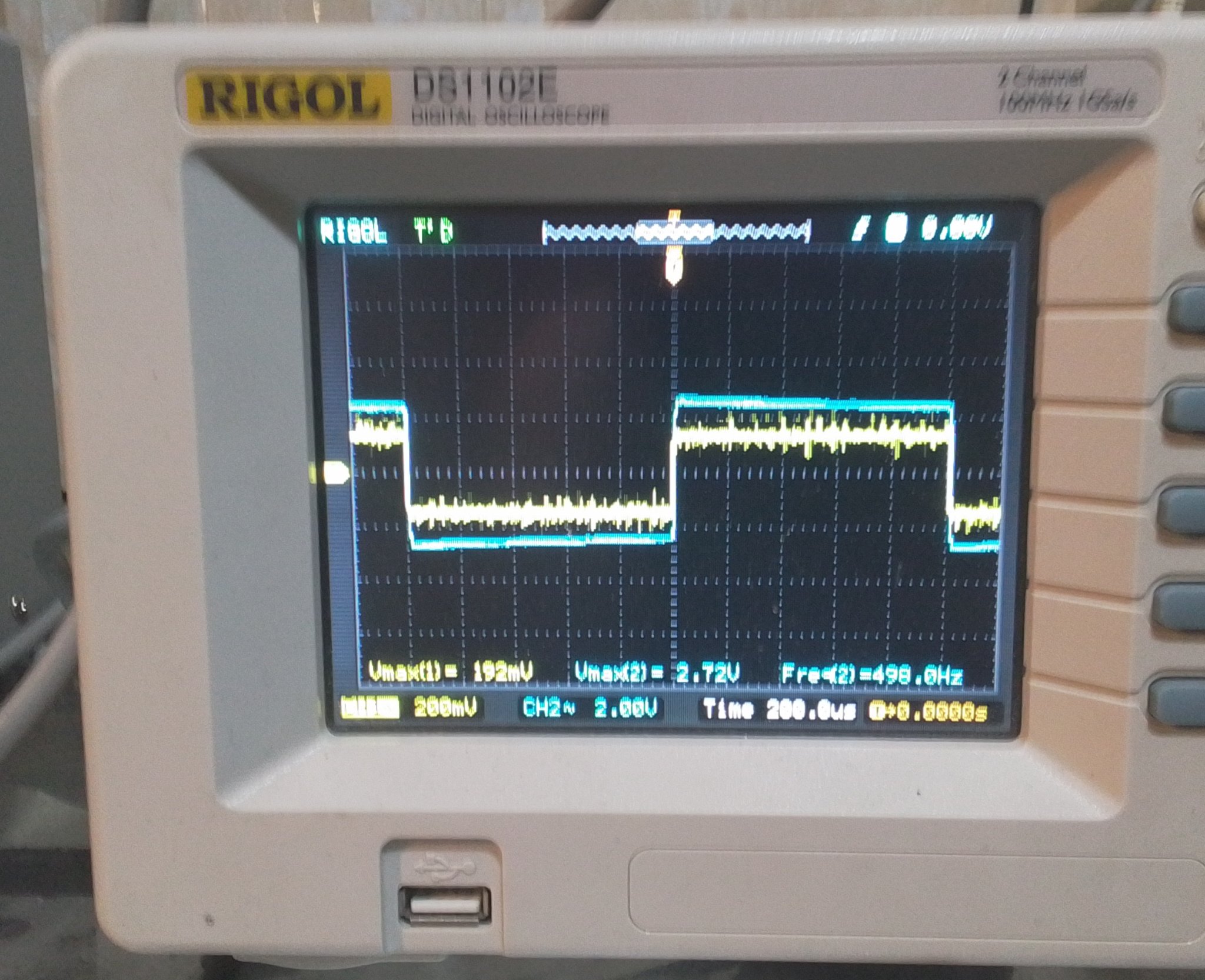

Changing coupling caps from 0.22 to 0.47 get a little bit better low freq response. At least in amplitude it shows consistency.

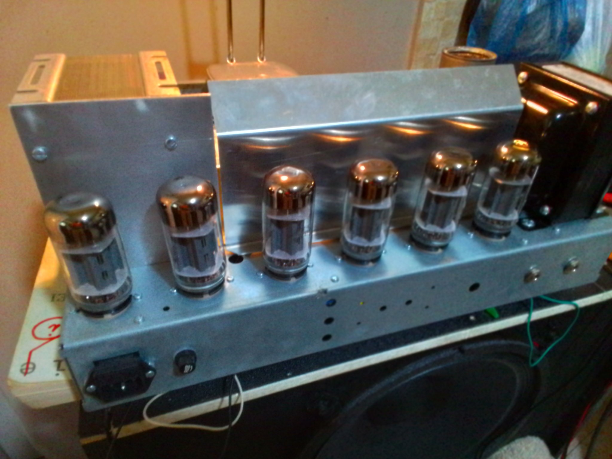

Yes the schematic is pretty accurate : 6sl7 floating paraphase inverter direct coupled to cf ecc99 grids into a shared 470nF/47k rc pole for 3 paralleled output tubes per side..
It was a pentode p-p 6l6gc / el34 project. Triode connected is something I want to try. I don't know if the ecc99 cf driver I have is proper to drive 3 parallel 6l6 triode connected, right now it works with 11mA to each side the output impedance should be a couple of hundred ohms order.

There is not a SE but a P-P circuit using 6 x 6l6gc triode connected. The current is well balanced in output set. Each equally draw 48 mA at 440V for max 21 Vpk into 4 ohm load. 1.9k pp OT used. My actual question regard the driver I should use for ? Just for now I used an ecc99 as cathode follower suplied at 400v with 18k in cathode. It sound well but changing resistor to 10k make a huge difference. 10k in cathode meant 20 mA DC so 4w dissipate per tube section, way to much for 3.5w max specs. I expect now a 6n6p which is bigger power rated but who can tell me what make a good driver for my actual output configuration please ? Thanks.

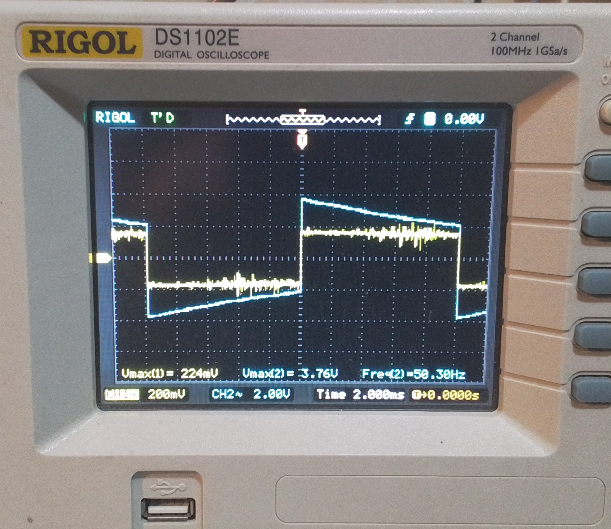

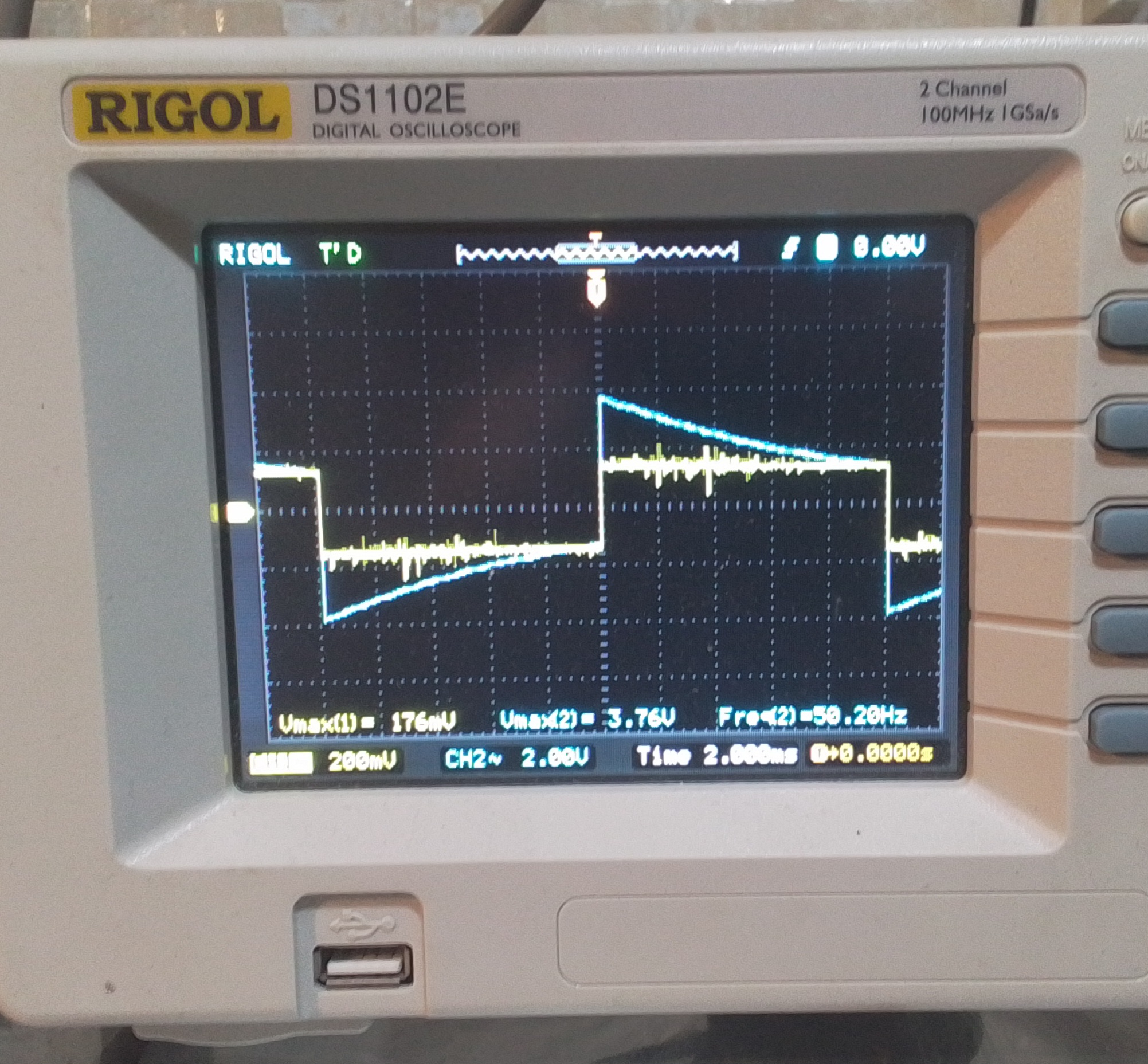

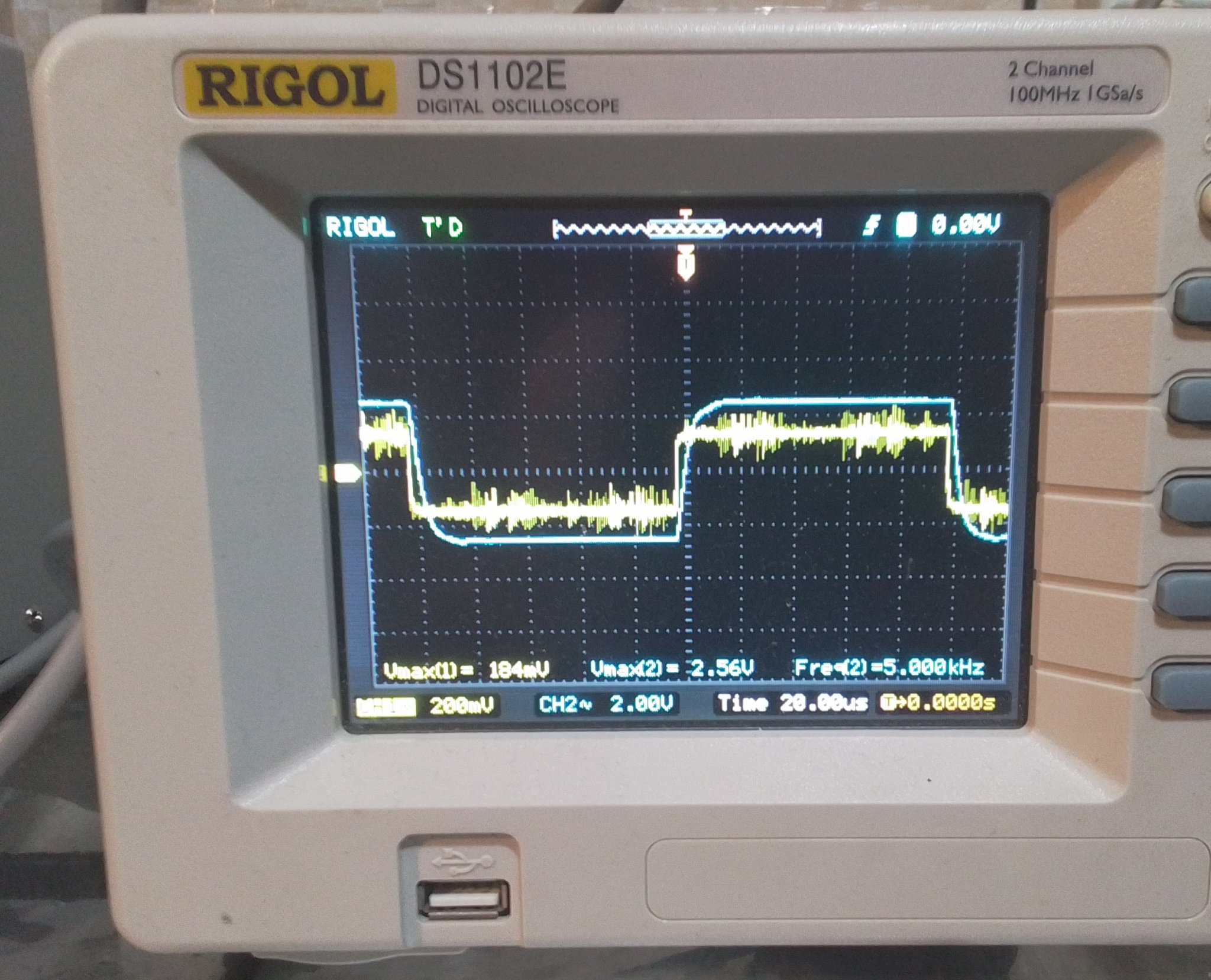

BTW, your square wave response looks about normal.
For a better response you would need a wider bandwidth.
A good square wave (SW) response requires the lower corner frequency of the amp to be at least 10 times lower than the SW frequency, while the upper corner frequency should be 10 times higher than the SW.
The bandwidth of your amp might be mainly limited by the OT.
If so, the only way to significantly increase the bandwidth of the amp would be global NFB.
