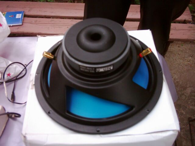

The driver is a Senon (Chineese) and is 12" in diameter, magnet 40 Oz and 2" voice coil.
Here is a picture.
Thanks.
