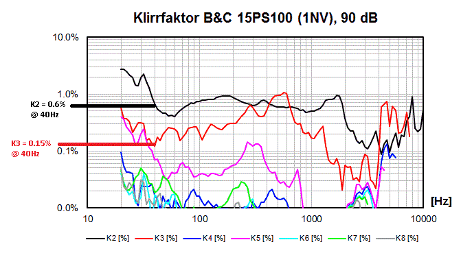

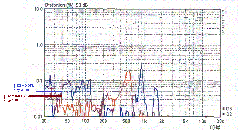

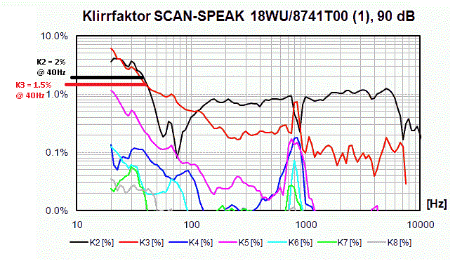

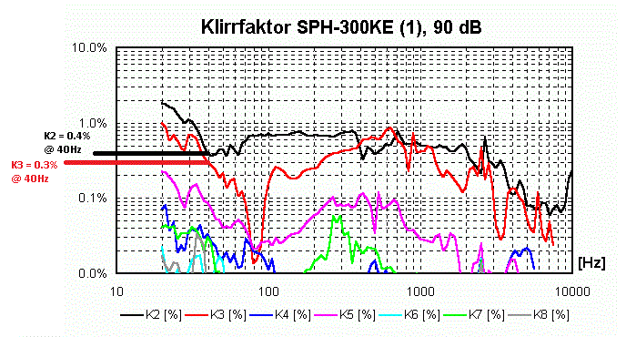

A few measurements collected from here and there
1) ScanSpeak Illuminator 18WU (a well-respected and expensive "audiophile" 7" = 18cm mid-woofer)
2) Monacor SPH-KE300 (a relatively affordable 12" = 30cm kevlar woofer)
3) B&C 15PS100 (a relatively affordable 15" = 38cm woofer designed for "Pro"/PA applications)
4) Fostex FW405N (an expensive, high-end 15" = 38cm woofer designed for Hi-Fi applications)
I'll let you draw your own conclusions.
Mine are:
1) Low frequencies DEMAND a large Sd
2) Within the same Sd class, you tend to get what you pay for
Marco
