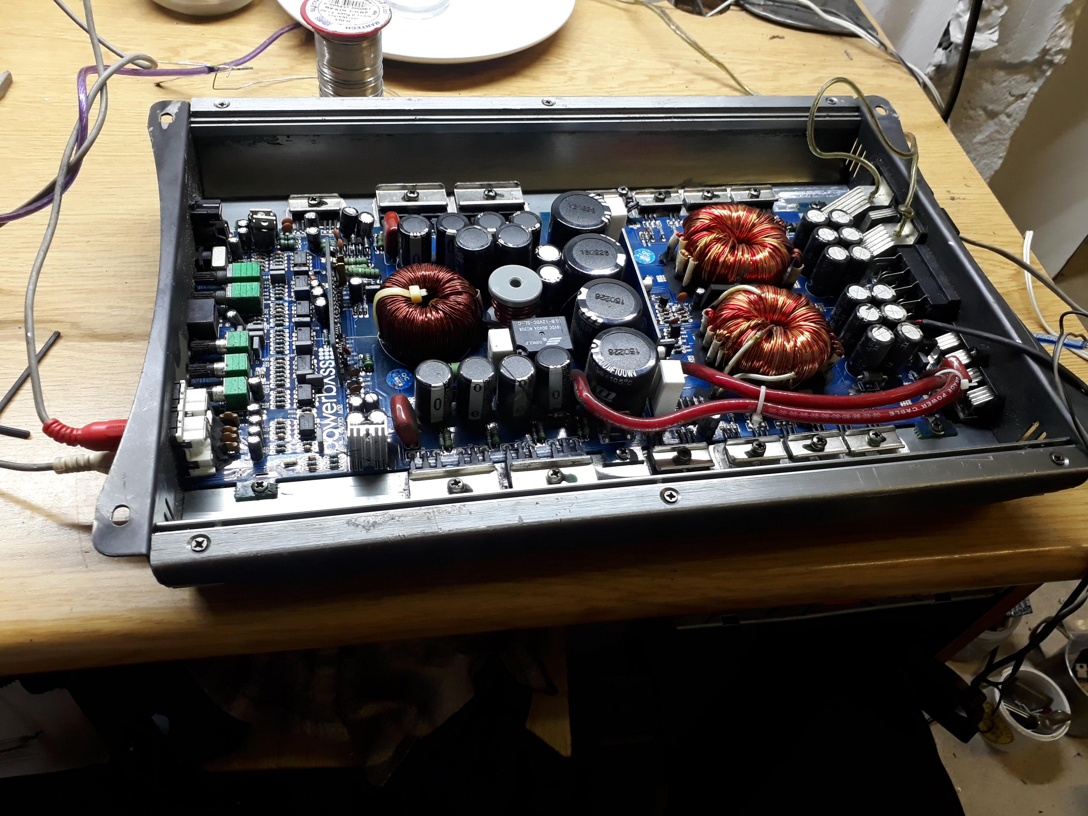

Hi guys does anyone know what transistor goes in q4 of this driver board

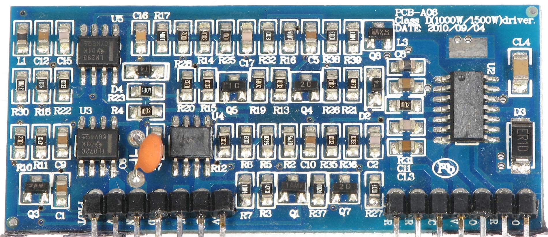

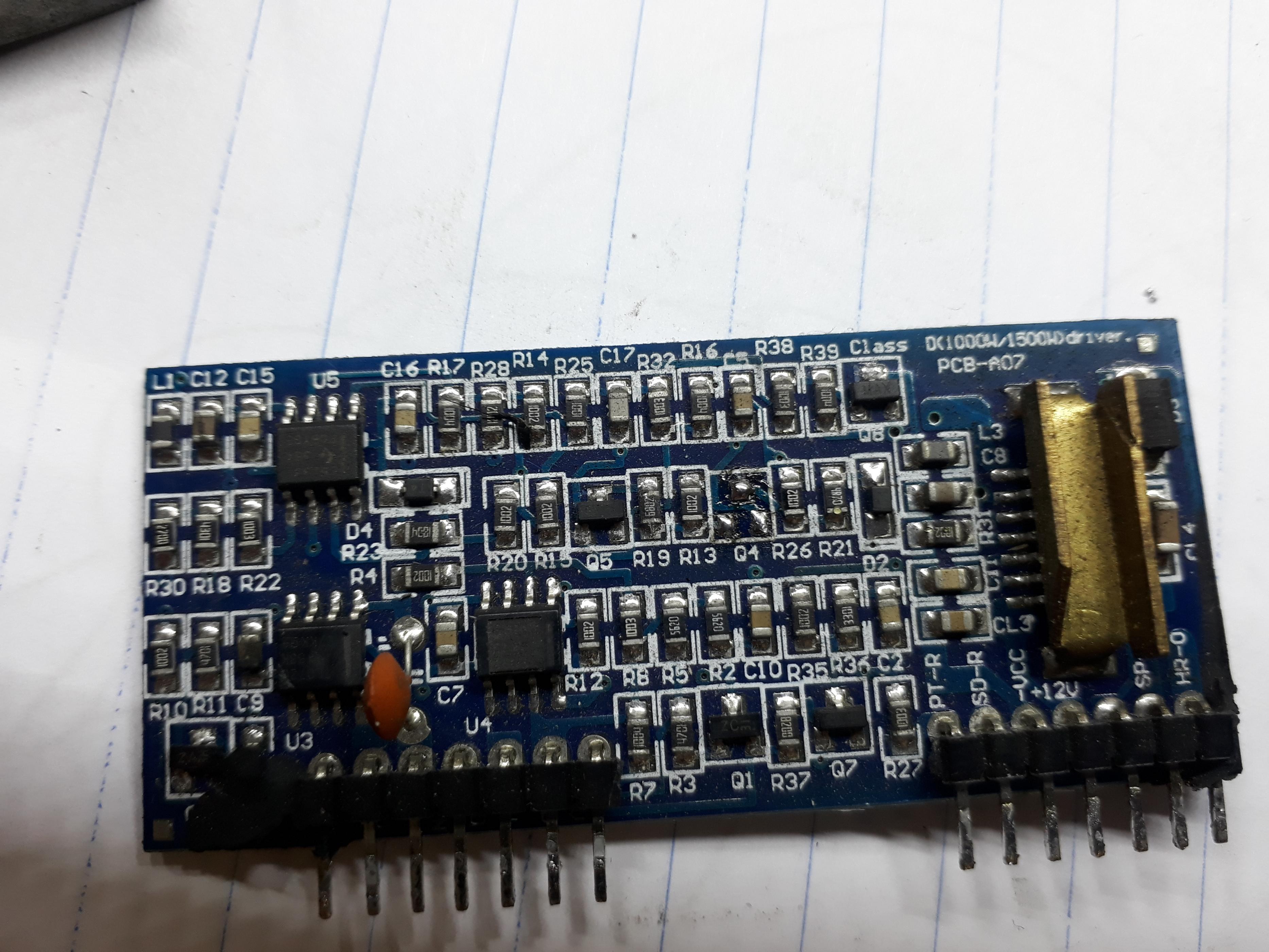

S shanecapetown Member Joined 2019 2020-01-29 6:31 pm #1 2020-01-29 6:31 pm #1 Hi guys does anyone know what transistor goes in q4 of this driver board Attachments 15803225330721845048565.jpg 898.1 KB · Views: 86 ••• More options Share P Perry Babin Member Joined 2003 bcae1.com 2020-01-29 6:34 pm #2 2020-01-29 6:34 pm #2 A similar board. Attachments IMG_3167x.jpg 314.3 KB · Views: 75 ••• More options Share S shanecapetown Member Joined 2019 2020-01-29 6:37 pm #3 2020-01-29 6:37 pm #3 Thank u very much ••• More options Share S shanecapetown Member Joined 2019 2020-01-29 6:50 pm #4 2020-01-29 6:50 pm #4 What is u2 perry ••• More options Share P Perry Babin Member Joined 2003 bcae1.com 2020-01-29 6:52 pm #5 2020-01-29 6:52 pm #5 IR21844S/IRS21844S ••• More options Share S shanecapetown Member Joined 2019 2020-01-29 6:56 pm #6 2020-01-29 6:56 pm #6 Thank u this one gets really hot real quick and it's not giving drive signal ••• More options Share S shanecapetown Member Joined 2019 2020-01-29 8:27 pm #7 2020-01-29 8:27 pm #7 I replaced ir21844s found resistor R21 not reading anything replaced it put back driver board and we have drive.. super Attachments 1580329584578-2070189198.jpg 984.8 KB · Views: 85 ••• More options Share S shanecapetown Member Joined 2019 2020-01-29 8:28 pm #8 2020-01-29 8:28 pm #8 Amp is running 100% thanx perry ••• More options Share Show hidden low quality content Status This old topic is closed. If you want to reopen this topic, contact a moderator using the "Report Post" button. Share: Facebook Twitter Reddit Pinterest Tumblr WhatsApp Email Share Link Home General Interest Car Audio Driver board info
