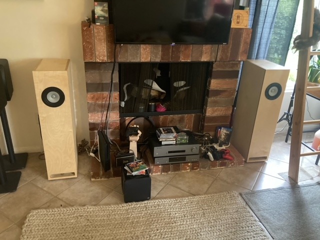

I recommend the CHP90mica, which is 89dB/w.m. but produces a sound that can be used in any genre.
I think the sound pressure is acceptable.
The box should be TQWT or Pensil.
I played it with a 2W+2W bus-powered D-class amp.
For more information on drivers and boxes.
