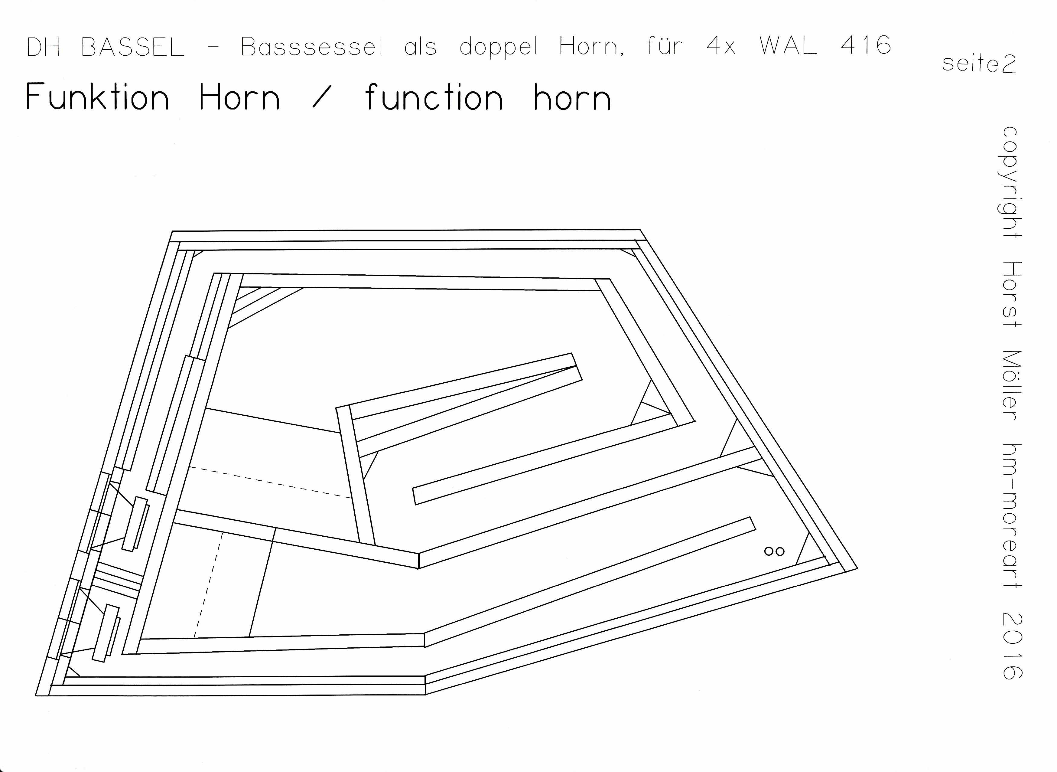

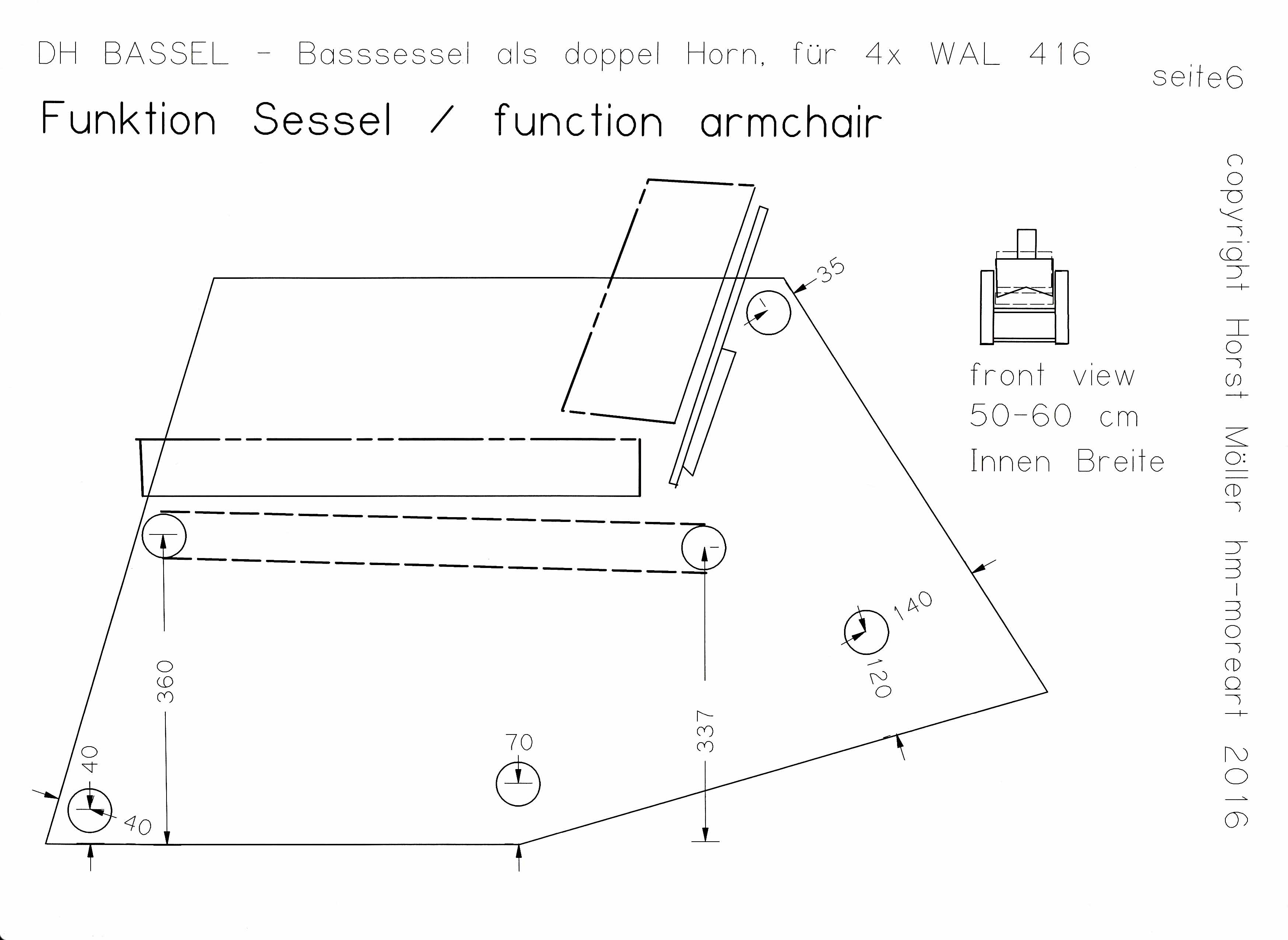

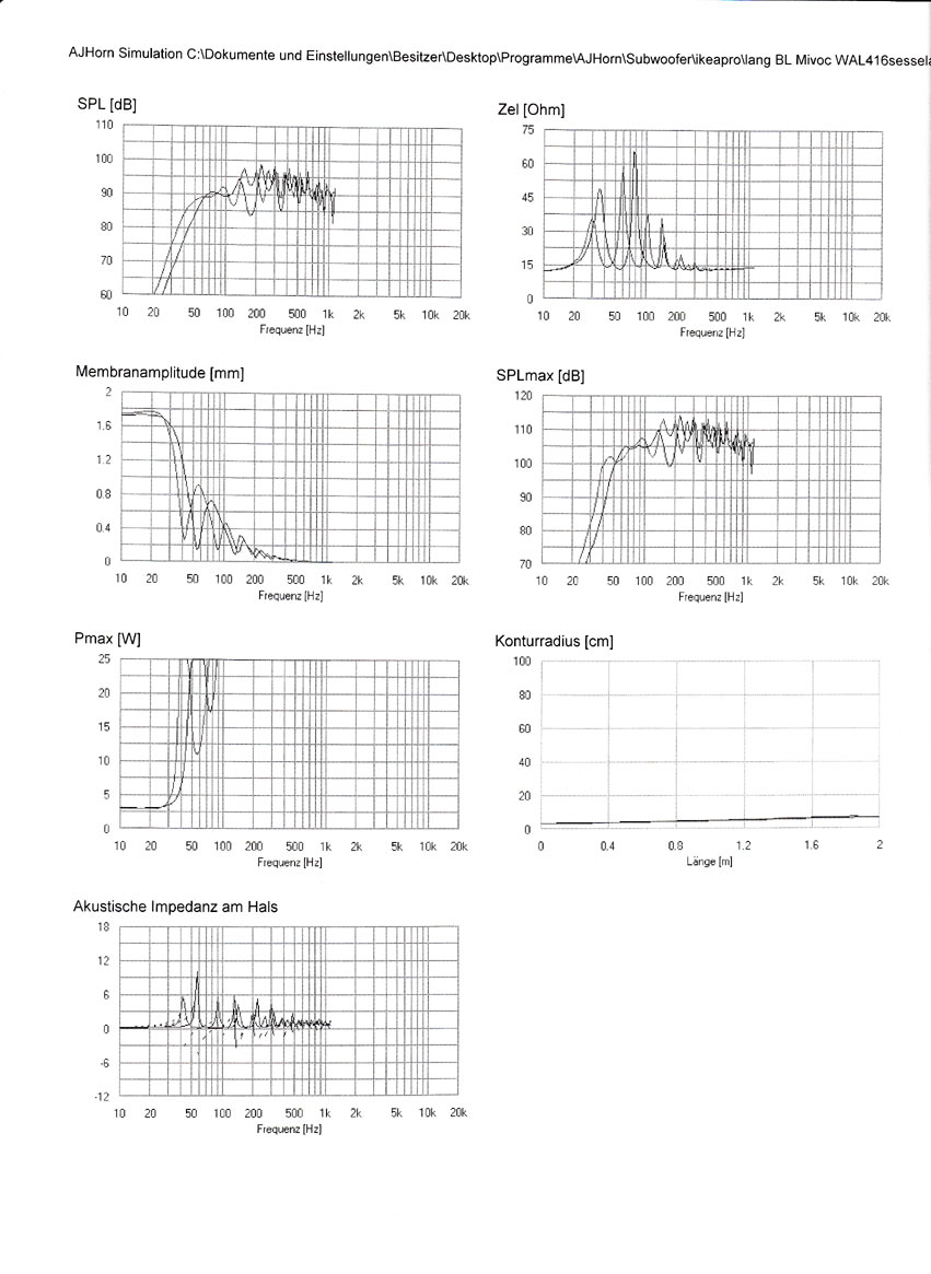

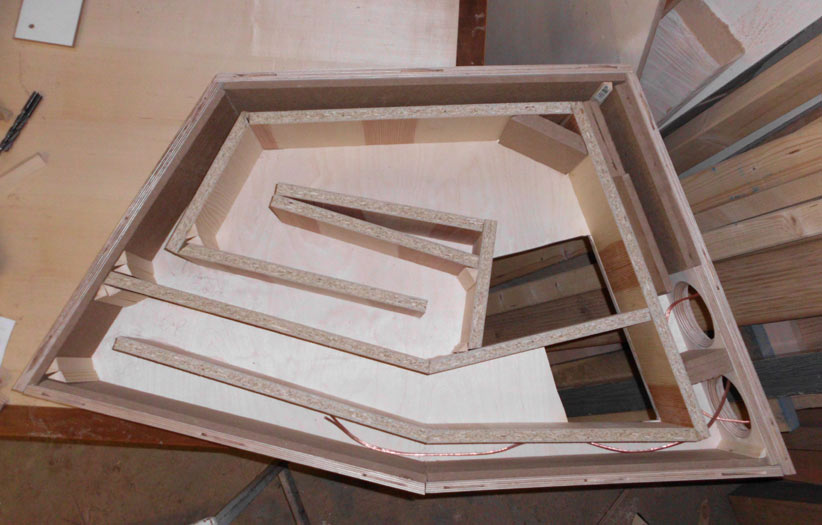

Hello Members,
i construct a double Bass horn as an armchair,
for the Mivoc driver WAL416, 4 driver parallel = 4 Ohm
Aktiv 33-120Hz.
Made for the new DH SAT, or FLUTE, SCHALMEI.
any opinion?

Well drawn!any opinion?
From a maximal use of available space consideration, seems a waste to not use the area under the seat, and the rear portion that is angled up (unless you plan to make it a rocking chair).

Hello,
well drawn - this part was freehand ;-))
you will get a armchair which you can modified for you body largeness,
you get a multi direction radiation left right front, and the experience of the bass is different because the room reflexion chance to direct LS in front of the listener,
i check it out.
The old BASSEL is much more complicated, sound only in front, no double horn.
Bassel
