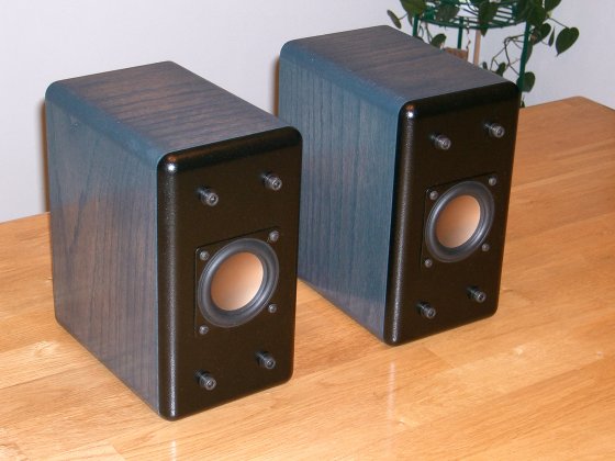

If you decide to heed the above advice, here are some suggestions for good satellite speakers.
If you will be doing most of your listening from a computer chair (as I did). Then you are most concerned with on-axis performance and can get by with a small, inexpensive, and easy to build full-range project. Here is the perfect speaker for that situation.
http://www.zaphaudio.com/audio-speaker18.html
If you prefer to listen in multiple places in the room, rather than primarily your computer chair, you need a tweeter for good off axis high frequency response. Here is a good, inexpensive 2-way project.
http://www.zaphaudio.com/ZBM4.html
These projects are well designed and have been measured and verified to give good results. They make a great entry point into speaker building and will provide a reference for future designs if you so desire.
If you prefer to stick with a wide bandwidth 2-way, and accept that they may not sound the best if you can't place them exactly where they need to be placed, then there are several projects to consider as well, depending on your budget.
David

David gave you really good advice. But if you prefer the simplicity of wide bandwidth 2-ways with your budget, I believe the Modula MT at HT guide or my RS180/27TDFC design is the best option you can find. These two designs use exactly the same drivers. My design's vented cabinet has a bit smaller foot print (8.5" versus 10"). My crossover is more economical. Either way, you'll have very nice sounding 2-way speakers on a budget.
Read my RS180/27TDFC 2-way design page. A good amount of information about these designs is there.

Jay, you read my mind, I was drafting a reply to suggest the exact same build. The RS180 is on sale right now at Parts Express, so I'm tempted to pick up a pair to try this design for myself.
This project will run a little higher than your implied budget. Figure on spending about $250 for all parts (including speakers and crossover); then add in your enclosure costs.
