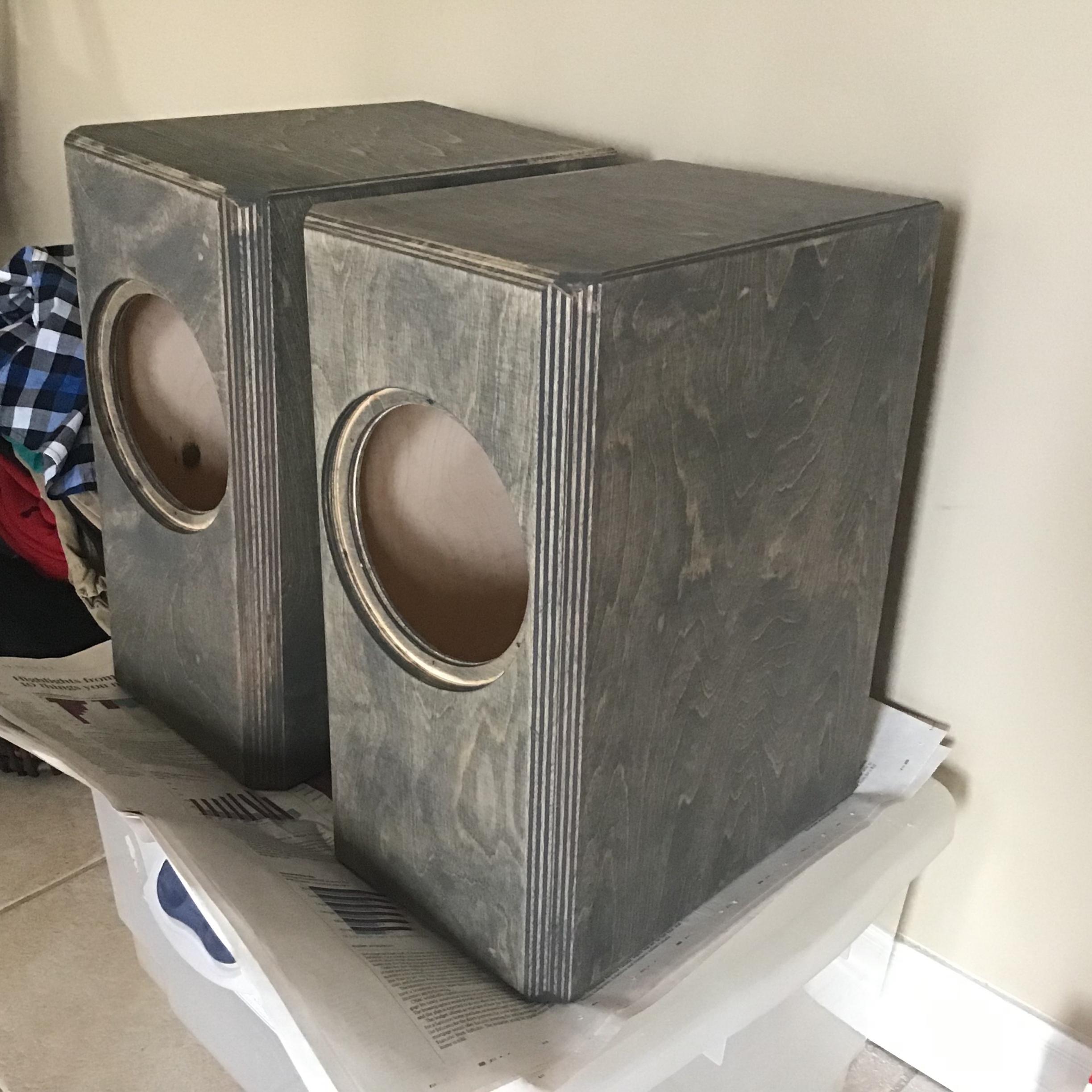

I agree with Jeff.
The A10.3 can certainly go down low and if volumes are modest it may really be able to “do it all”. Imaging is amongst the best I have ever experienced.
I started with Pencil enclosure but recently made a smaller stand mount bass reflex for these drivers. If space is a consideration these boxes would be just the ticket.

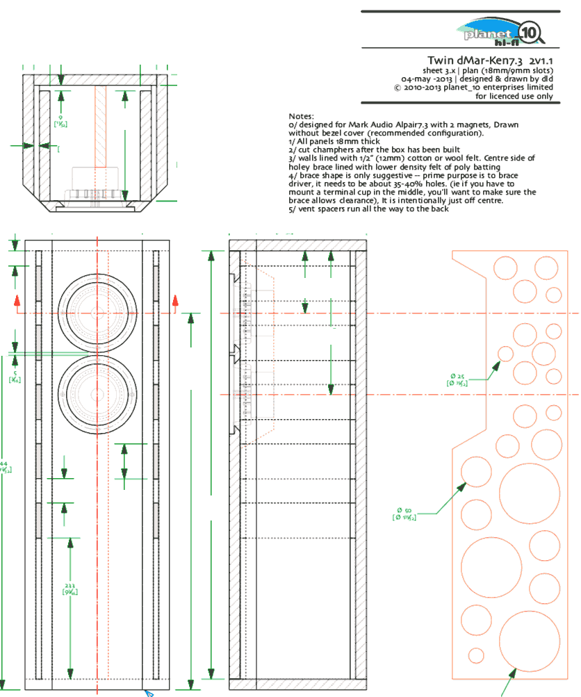

Like this — this one for A7.3 but easily tweaked for A7 (A7 goes lower):
or Twin FH3s — here sandwiched in between Maeshowe and FH3, loaded with a CS MTM kit:

Nice boxes, Bigun.
I do some woodworking in my garage at times too.
I love getting sawdust all over the place.
