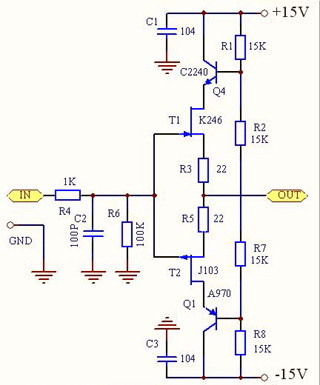

I just got this completed board off ebay. $15 with shipping from China. Wondering if it looks familiar to anyone. Also curious if the design is any good. I'm hoping to use it as an output buffer for my cd player.

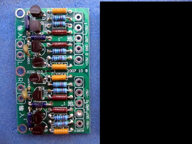

H homemade Member Joined 2004 2008-01-10 12:19 am #2 2008-01-10 12:19 am #2 pic of board. each is 2 channel Attachments 2 channel fetbuffer.jpg 57.9 KB · Views: 180
