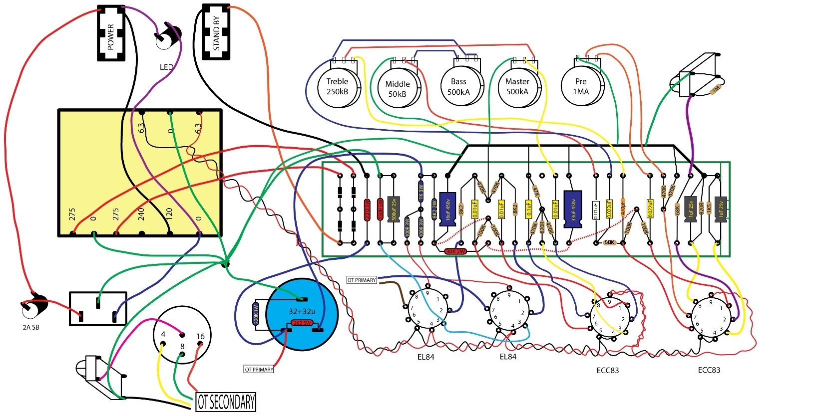

hi good folk of diy.....does anyone know of a schematic for 4 el86's....guitar use of course,or can anyone give me a sketch that will work....cathode biased
I have already made a 17 watt amp using these tubes and quite like the sound but I want to put in 2 more tubes so that the other guys don't drown me out at rehearsals.
4 tubes....running 255 volts to the plates and 195 to g2 with 150r on the cathode per pair settling at around 17 v but howling loud
just cant seem to make 4 work....pull 2 and it sorts itself out....running 2k ohms on the OT

I think JSE was trying to find out what it was that was happening, oscillations with an additional tube set. As far as the tube being similar to the EL84, the EL86 was designed to work at lower voltages but the designers used the EL84 as a starting point. They used the basic structure of the EL84 and increased the current rating and (I think) reduced the distance of the grid from the cathode. Basically it is a EL84 variant.
It would be good to see the schematic of the amp with the four tubes, even a hand drawn one . One thing that would be needed is grid and screen resistors on all the tubes. It would be best if the resistors were soldered right to the socket pin. The screen is an input to the pin and if a resistor is not there you can get feedback.
I drew this up...hope it helps......I must say that I am gratefull for the help I am receiving

No, leave the dropping resistor and cap as is. Add an additional resistor in series with each screen grid mounted right at the pin of the tube. I use 100 ohms, but 220 or so might be a better choice.
I have wired 4 X 6CW5's together much like you have done, without any issues. I used a separate 270 ohm cathode resistor for each tube, but it shouldn't matter.
I have squeezed about 50 watts from 4 X 6CW5's with 200 volts on the screen, about 300 volts on the plate, and a 1650 ohm OPT. The tubes were all used GE's pulled out of old HP audio oscillators. I used the amp for a couple of years before giving it to a friend.....it never blew up.
If you have any feedback connected to the secondary side of the OPT, try disconnecting it.

I seem to be slowly getting on top of it ,changed out the grid 2 setup....2k2 per pair then 150r to each....dropped the voltage about 3 or 4 volts......do you think voltage is lowish ? perhaps change 2k2 to 1k5 or 1k8 ?

the amp itself is very loud,man I triple checked everything.....I have replaced the PI with a 12au7 and put 82k load resistors on PI and V1 and the amp is still roaring changed cathode resistor to 172 ohms per pair on the pl84's and the bass is a little gravelly its gonna sound great when I get it sorted....the second gain stage cathode has been subbed from 820r to 1k5
the volts at V1 are 210v and PI is 250v (I think theyre suppose to be around 270v +/- 10v
I was thinking using smaller coupling caps but would the sound thin out ?
the grumbling bass has been consistant through all changes, but then i'm only a tinkerer...perhaps i'm missing something (a brain ?)
is there too much drive to the power tubes (I cant see it ) or perhaps bad bias in the preamp ?

If you want you could increase the bias resistance on the PI, some go up to 1.5k. The greater the tail resistor the less headroom on the PI stage and the lower the signal to the output tubes. Could also play with that. Otherwise can't see anything others have not done. Could also lower the resistance on the grids of the output tubes to load down the PI if you are hitting them too hot. Or lower the voltage to that stage. Wish I could give more concrete advice. If you could maybe join the 18watt forum.
resist,resist !
I have taken the two 470k's to 220k (for 4 x 15cw5)....
at about half volume i'm getting 215 ish volts on g2 ( amp is pretty loud by now) at 0 volume its around 170 v (with 12ax7 in PI )....the arrangement used for G2 is 255v >2k2 5watt per pair then 3k3 5watt each one
amp is pretty Quiet....only thing bugging me is the bass,it seems to have slight odd order harmonics and its persisted right through the build....on the cathode of V1 I have subbed the 2uf bypass cap with a 25 uf to increase bass response... maybe take it back to 2uf or something middle 10uf ?

output tranny ?
changing 25uf to 2uf did improve it a little,begining to sound damn fine, the distortion is soo smooth.....just wondering ,is this low end bass growl at half to full volume possible transformer saturation ?.......Hammond 1760 j 35watts @ 4k
currently running reflected load of 2K.......16ohm to 8ohm speaker
would running at 4k decrease the load ? and thus possible transformer saturation ?

Give it a try, not sure if it would be saturation but the tubes may sound different with a different load.
