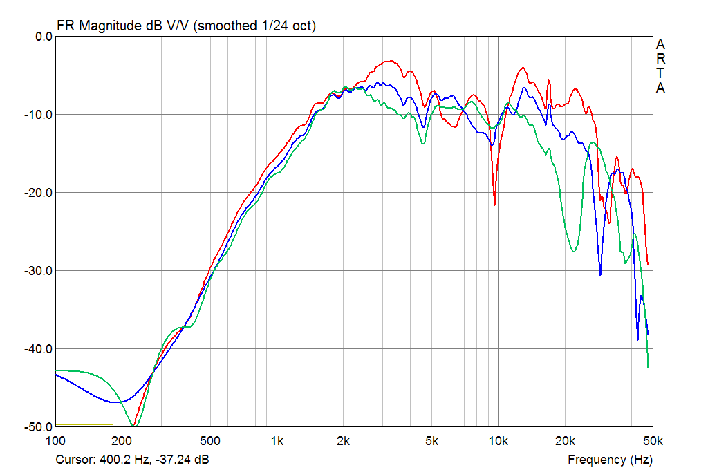

Little teaser intro - I changed the response of my Seas coax tweeter from the Red trace to the Green trace (not actual level, separated for clarity).

The response is below. Traces top to bottom with 5dB separation:
0 degrees (absolutely dead on-axis)
5 degrees
30 degrees
60 degrees
Additionally, below is the distortion at ~90 dB* I applied a 1st order DSP filter at 4000Hz which produces an almost perfectly flat frequency response from 1KHz up.
As typical for large roll surround tweeters 2nd harmonic is slightly raised, but >3rd harmonic is very low. For a small tweeter, this thing could cross low when used in a waveguide like this. It brings to mind the Buchardt S400 with their 19mm dome in a 6” waveguide.
I’ve looked at all the coax drivers on the DIY market and this seems to be the best tweeter performance of any of them. Seas original, SB Acoustics, Tangband all have some nasty diffraction and dips going on in their tweeter response. The mid-range cone from Seas is excellent, of course, since that is their area of expertise.

I simulated the design in AKABAK. As can be seen in the measured response the traces bunch up a little between 5KHz-10KHz. This is due to the cone profile of the MR18. I have put some thought in to designing my own coaxial from the ground up so I can do an even better job, but again MOQ and non-refundable costs are prohibitive and scary for one guy like me. At least offering this upgraded MR18 could ‘get my feet wet’ and perhaps the future would hold more exciting things!

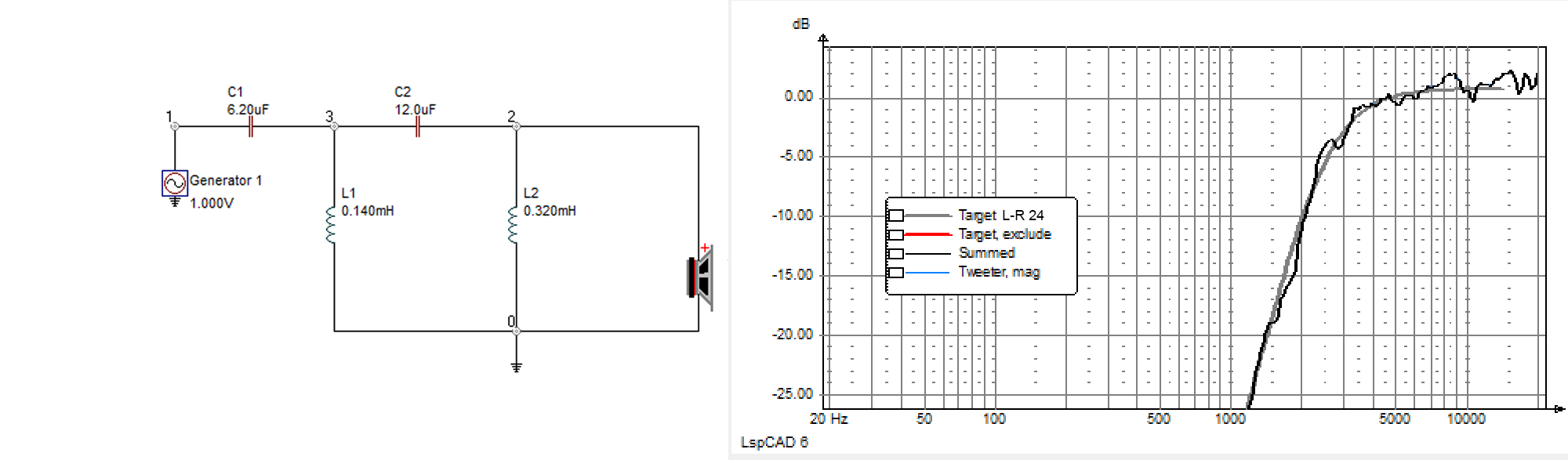

Furthermore, I attach the impedance response and FR files if you want to play. I also include a suggested passive filter that simulation says will give LR-24 at 2.3KHz.

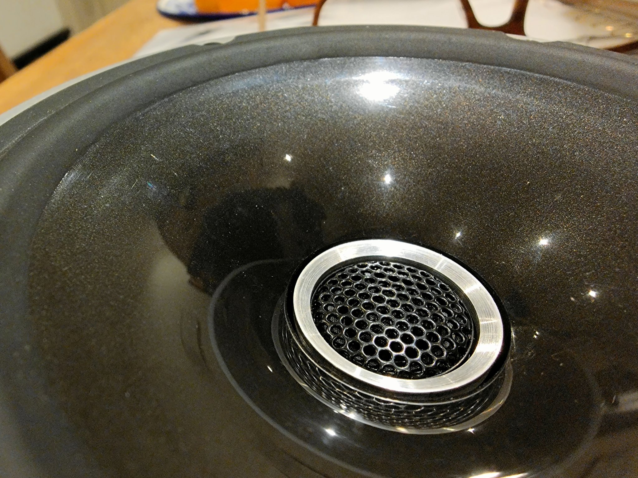

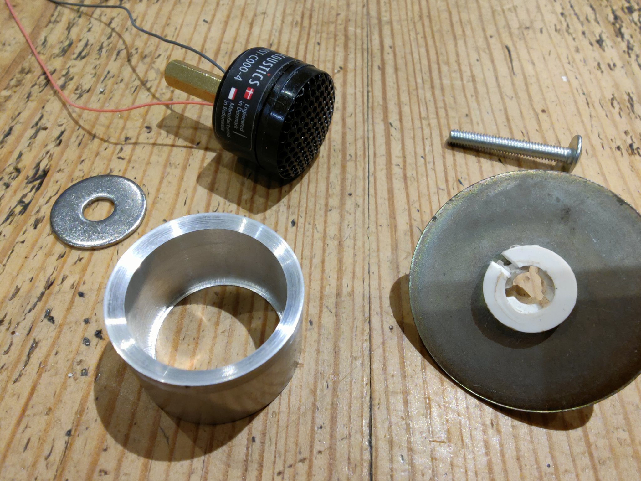

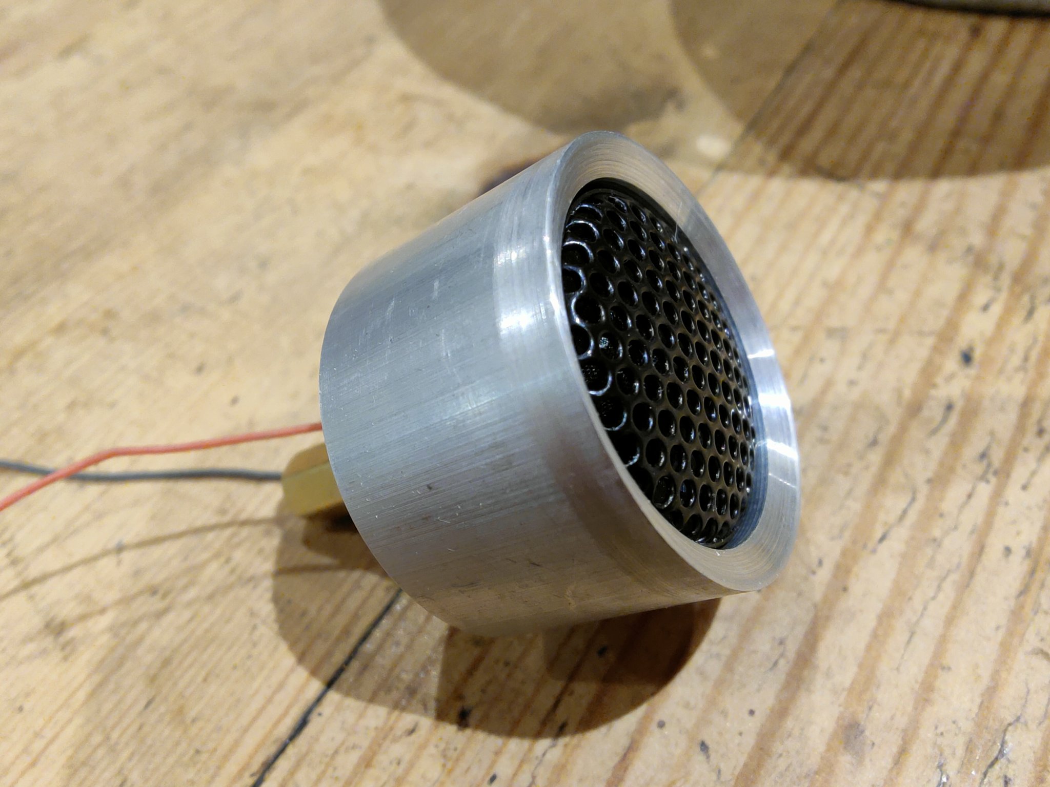

I've played with these Seas coax units before and discovered some small tweaks which make a huge difference without the need to custom machine parts. It does mean dealing with the stock tweeter but they're not so bad if you know what to do with them.
The main thing is to remove as much of the overhanging plastic rim at the surround area and space the tweeter forward with aluminum washers under it. The next thing is to trim as much of the overhanging VC former as possible to clean up the radiating path to the cone, reducing diffraction.
You still have the air gap resonance between the tweeter body and VC edge to deal with, but it cleans up the entire FR and removes most of the cavity resonances you get from the tweeter's plastic edge. The Seas tweeter element isn't that bad and it copes with a reasonably low crossover point. I dont have measurments for you, but the improvements are pretty big. The few millimeters of distance the tweeter moves forward can be compensated with offset crossover filter slopes.
