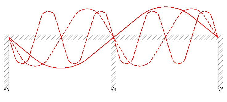

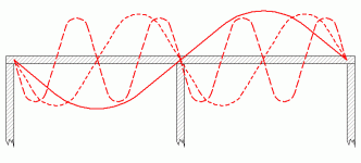

Originally posted by andy2
Where is the most effective place for it then?
Off centre, prefereably at an angle... in the middle of a panel, the brace actually does little to suppress the 1st resonance of that panel -- it can actually enhance it (ie make it worse).
You should also make sure that the cross-braces are not symetrically placed as well, and that they don't brace to create a square sub panel.
dave
frugal-phile™
Joined 2001
Originally posted by BassAwdyO
with the brace in the middle shouldnt it control the 1st resonance, but not the 2nd, 4th, 6th and other even multiples?
Any waveform that has a null in the middle of the panel will have a minimum amount of suppression. Because the wall is clamped at this null point, energy at similar frequencies can feed these resonances as well, giving a situation where the panel can actually be worse after bracing.
dave
