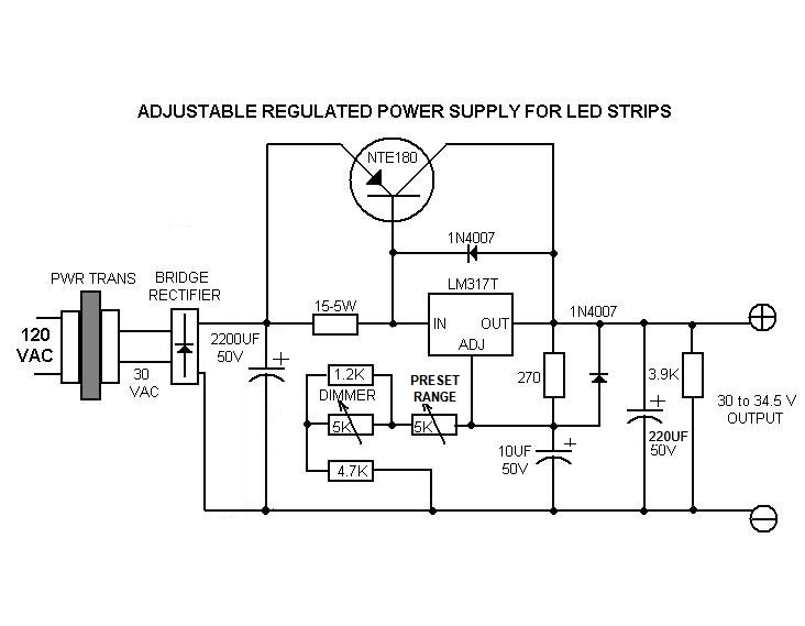

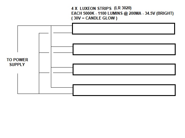

I installed under-cabinet lighting in the kitchen back in May.
4, 1 foot 5000K strips, built my own variable supply (LM317+ T03 booster) with dimming feature - 32-34.5V.
Cost me only about $140 all included.
And it's reliable because it's built by me.
360+ equivilant watts of light now, with only a 36 watt AC draw.
And told it will last 45 years at 3 hours a day use.
Can't beat it.
Hint: Set up the regulator as a variable current source - that's what LEDs ultimately care about. Your dimming must be terribly nonlinear (well, non-logarithmic). I find it a bit surprising that this detail would have eluded you until now.
The usual approach for quality LED drivers is using a switch-mode converter with active PFC followed by a switch-mode current driver (basically the switch-mode equivalent to the linear supply + LM317-ish reg used as a current source). The main advantage of this is flexibility in panel choice and high efficiency over a wide range of line voltages, where a linear power supply has to be sized pretty exactly to match minimum expected line voltage and panel voltage at maximum output current.
At the kind of voltages that larger LED panels tend to need (often in the 30s of V), linear supplies aren't necessarily all that inefficient, and you should be able to hit about 80% or not much less at least if you choose a good-quality transformer. Off-the-shelf LED drivers typically seem to hit 85-90% or so, which is clearly better, but not so much that you would consider it night and day, so the simple and rugged linear supply definitely isn't out immediately.
My analog supply works fine.
Dimming (via rotary pot) is smooth from a candle glow up to full brightness with pure filtered/regulated DC to the LED strips.
With a 1.5A transformer the supply barely gets warm, and is mounted inside one wall cabinet.
