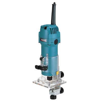

I have two routers - a large Bosch with a 1/2" collet and a small Makita trim router that has a 1/4" collet. I almost never use the large router for speaker building. The Makita does it all and was cheap ($70.00 on sale). You can buy a variety of bits to do most of the things you'll want to do.
