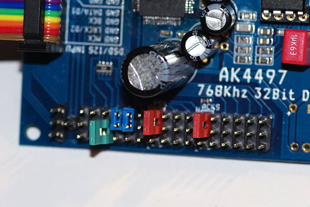

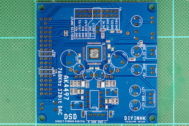

I have a DIYINHK AK4497 DAC. There are a couple of relatively easy modifications that can be made.

In your judgement, is it likely that these modifications will improve the sound of the DAC? Also, which trace would be cut and where?

Looks like the AVDD follows the trace colored red in the pdf file below below. The green trace goes to another power connector so it would presumably need to be cut somewhere before it meets the red trace.
As to whether or not it should be separately powered, you would have to try it and see if any difference in sound quality. If you don't believe there is any benefit you could always solder the cut trace back together and use a single power supply.
That said, you should probably use a really good USB board for testing since jitter there will also affect sound quality. Also use a good amp and speakers. In other words, if any part of your system is not up to par its possible there would be an improvement from separate power, but your system might not be working good enough to make the power supply difference easy to hear.

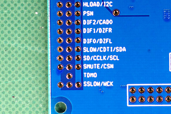

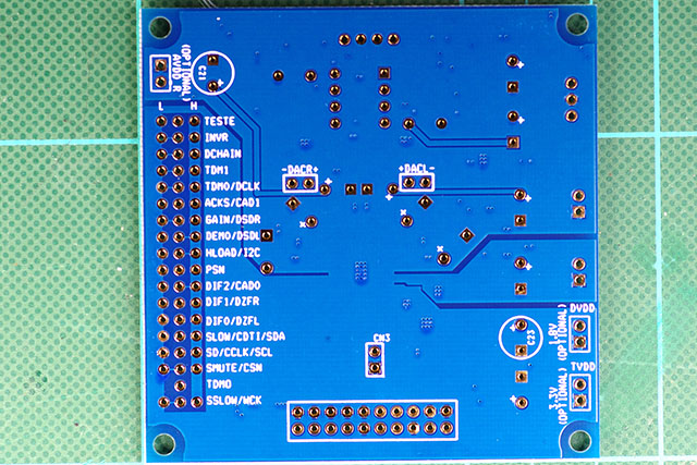

I feel pretty comfortable cutting the trace, but before I do that, I'd like to try and change the filters.
I can see how the SD, SLOW, and SSLOW are marked on the underside of the PCB. I assume I can use jumpers to change the filter but its not clear how.
Could anyone please help me with this?
From the photo in the OP: for each pin there is 3 pads, the centre pad is the pin itself, you either connect it to the right H (High) pad for 1 or left L (Low) pad for 0.
You just need to make connection, jumper are convenient to change them on the fly but you can just a piece of wire.

SSLOW/WCK must be cut, is connected to low by default.
If you want to use super slow roll off filter and low dispertion filter... you must cut that trace..
