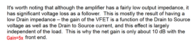

The original "lottery VFET" amps of April 2021, are described in a .pdf by Nelson Pass, in post #1 of (this Forum thread).
Nelson explains that because the VFET transistor has quite a low drain impedance, the VFET amplifier's follower output stage actually has voltage loss, i.e., gain < 1, see attached snippet. The output stage's gain is a rather surprising 0.63 volts per volt (-4.0 dB).
The 2021 lottery front end card using Toshiba+Edcor had a gain of 5.0 volts per volt (+14.0 dB), so the end-to-end gain of the entire lottery VFET amplifier was (0.63 * 5.0 = 3.15 volts per volt), and 3.15x equals +10.0 dB. Alternatively, performing the gain calculation using decibels: +14dB front end, plus -4.0dB output stage, equals +10.0 dB for the entire amp end-to-end. Exactly equal to the end-to-end gain Nelson wrote in the .pdf.

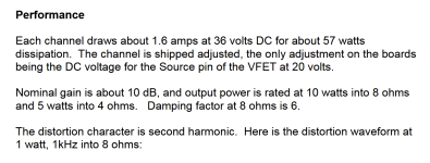

The 25th Anniversary edition keeps the same VFET follower output stage, whose maximum power output before clipping is 10 watts into 8 ohms, snippet below. That's 8.94 volts RMS into 8 ohms.
However, the new 25th Anniversary edition installs a no-Edcor, no-Toshiba front end called "FE2022" whose gain is 10x, set by the resistor ratio R4/R2. In other words, double the gain of the 2021 lottery front end card. By the way, 10x gain equals +20 dB. So the end-to-end gain of the entire 25th Anniversary edition is (0.63 * 10.0x = 6.30 volts per volt). In dB, it's (-4.0 dB + 20.0 dB) = +16 dB.
When the 25th Anniversary edition just barely begins to enter clipping, its output is 8.94000001 volts RMS. Dividing by the end-to-end gain (6.30x) we see that an input of 1.419 volts RMS will start to clip the amplifier. That's 2.0 volts peak (above the mid-line), i.e., 4.0 volts peak-to-trough.
So if you want to get 100% of the available output power of the 25th Anniversary edition, make sure your source can deliver 1.42 volts RMS {when FE2022 is installed} , and/or 2.84 volts RMS {when Bulwark or Marauder or Dreadnought is installed}. Back in 2021, Nelson recommended using a source that can deliver 3V RMS, which is pleasantly conservative.
