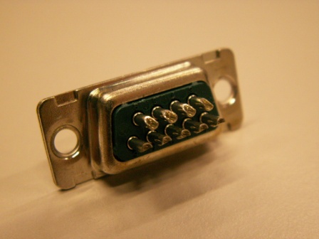

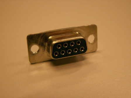

Bouquet
2007-07-30 5:38 pm
A female D-connector provides you with at least 9 "clips" for the cartridge. Tehy are of far better quality as every audio clip that's on the market. And far sheaper. For the wiring you can use stript-down cable of a computer-mouse ; HP mouses use PTFE-insulated wires in PVC sleeving. It's flexible enough to use from cartridge to pre-amp.
The less solder-joints ; the better.
regards
Bouquet
Bouquet
2007-07-30 5:38 pm
patknk939 , KP11520
It's computer stuff indeed , the 9 pole connector on the back of your PC , known as com-port !
The "female" version is the one whith the holes offcourse.
The clips are not for sale separatly , so you have to buy the whole connector. Will cost you USD 2 , or € 1,5 or so !
Buy the soldering version for cable.
The "clips" are secured with a little C-ring at the inside , push out the "clips"or bushings. Some makes are a little to long to use as clips , but you can cut the wire side to a usable lenght.
They are goldplated , spring secured and far , far more rigid as the stuff you buy for a lot of dollars at the high-end shop !
Succes !
Bouquet
" ons bent zunig "
Bouquet
2007-07-30 5:38 pm
Bouquet
2007-07-30 5:38 pm
D-conn. front
