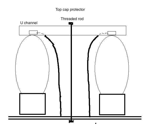

Lateral thinking - you only have to stop the top caps coming off. So you can use a U channel piece of aluminium which goes between and covers both top caps when they are on. This can be secured in the centre, between the tubes, by a piece of threaded rod.
Is this clear or do you need a diagram?
That could work!Is this clear or do you need a diagram?
