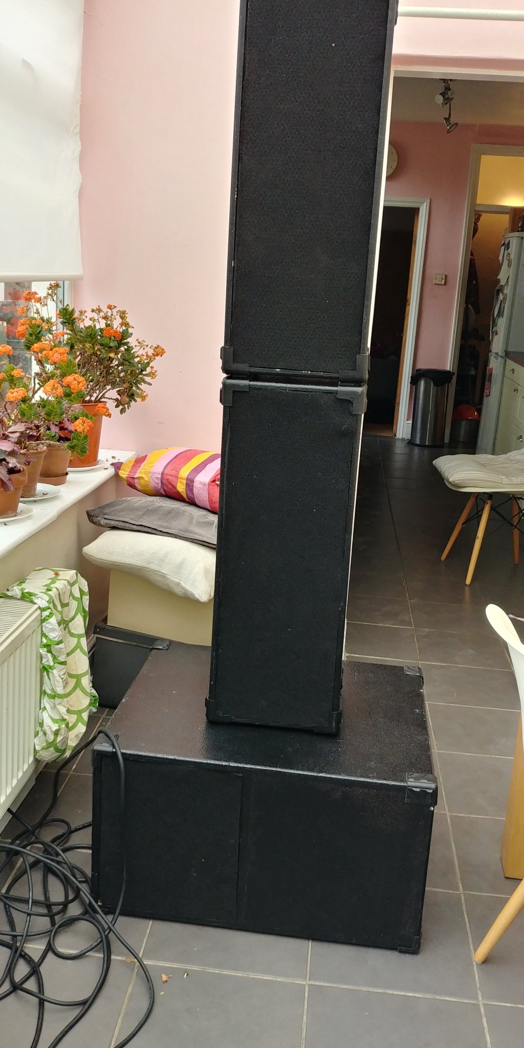

Well. I did end up making a couple of tops. As the places we play have ended up bring quite wide I made a 4 x 8inch faitals with a (sorry!( melded piezo array (6 monacor(. Oddly sounded very clear so pleased with them 525w per side. Had an ex echo and the bunnyman soundman say the rig sounded good. I will look at high quality coaxials as next set up when we need to "aim" sound more as happens in some of the weirder shaped country pubs where you dont necessarily want wide dispersion. Cheers for all the ideas.
Well a lot of gigs with the tops now done. They are bfm sla pros built with actually 6 inch faital pro and piezo vertical array. They are clear and surprisingly loud. Im still going to build coaxials as..
1. The tops only like wide rooms - too much sound hits walls in narrow rooms - unless i can get them well in front of band and toe them in sufficiently. If this isnt posdible a coaxial ( like the faital pro 10 mentioned seems a good call(
2. Whilst a piezo array definitely tames them the top end and is way better than the apt tweeters ( by a long way) they are not as smooth as you get in more expensive tweeters. Its very good for the money spent but not BMS lol!
More gigs to come to make money for next set- will bring speakers appropriate to room layout in the future!

Sorry i dont think ive got pics of build but heres 2 of the tops on the sub ( sometimes just do mono stack- ratchet strapped , here's a photo from when listening at home ) do this if we can only have speakers on one side- like when there's a door that needs to be kept clear. Playing in pubs is fun but sometimes a pain in the ****!

Hi, the tops are 4 x 6inch columns with FaitalPro 6FE200. The piezo array is IIRC 6 vertical piezo (cut and stuck together) these were monacor mpt016). I think the idea of a vertical array of piezos is to smooth the response ( get rid of harshness(. They have a crossover to piezos - ? 2k but none on 6's - tgese just roll off naturally. Theres a few builds described at bill fitzmaurices site of these under sla pro if you are interested.
Have some larger gigs next year - outdoors - not earth shaterring volumes required- need another mth built for this
Im sure there are better speakers! but these were an easy build- and fitted well into car ( big issue!) With all the other kit- just had to spend time carefully eqing the piezos ( using ui24) - did some crude measurements outdoors using pink noise and took out some peaks - maybe have a listen to some to make sure you like them first! Mcklinkys speakers will im sure sound much sweeter! Cheers, Al
