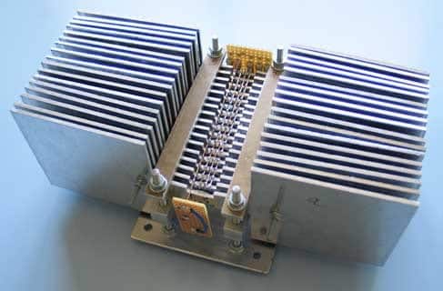

Long time ago I made 16 x TDA1543. One thing is crucial. Heat.
With 8 x You will have huge amount of dissipation. Consider some space for heat-sink. Bigger one. I think that sound is better when chips are cooler as can be. Happy building, and You will be not disappointed with sound, for sure.
I found some old photo of the stacked TDA1543 chips in sandwich heat-sinks. I tested for day and more non-stop in the summer high temperatures. And it was just warm in chasses after opening to check... Power supply active element have to be also on bigger heatsink, transformer have to be good and suficient and more power.
From the datas one chip have at 5V 50mA current consumtion at 8V supply it is 60mA
so count that it will be 8x0.06A=0.48mA these 0.5Ampers (cca.) have for instance drop at the active regulator element of say 5V then disipatino on the active power supply element will be 5V x 0.5A = 2.5W (count heatsink 4 x for 10W disip, if Yoy want to be just warm temp...)
With 16 x dacs all that is 2 x by numbers BUT heat is not linear, rather some exponential increase.

I didn't measure this at that time. Maybe 15 years ago, or more. But it is not worse than one chip used. Anyway it matters the power supply quality and wiring too. And digital bus quality, including clocking signals. Maybe even more. One is for sure, the output of 16X have significantly better "ear" performance, than one chip, and 8x pack.
I can give a tip for not using regulators in power supplies. Just classic (non-feedback transistor or darlington regulator. With shunt ends for digital branch. For DAC power shunt is welcome too - BUT the heat will be tremendous. I think that I supply TDA1543 with 8V. God rectification, C-R-C stage, and BJT regulator stage, all with quality elements will just do fine. Take a look at the one of the first examples of paralleling with tda1543? Kusunoki 4x1543. With a note to the power supply sections. My opinion is only that values of C in the power part are little too high.
