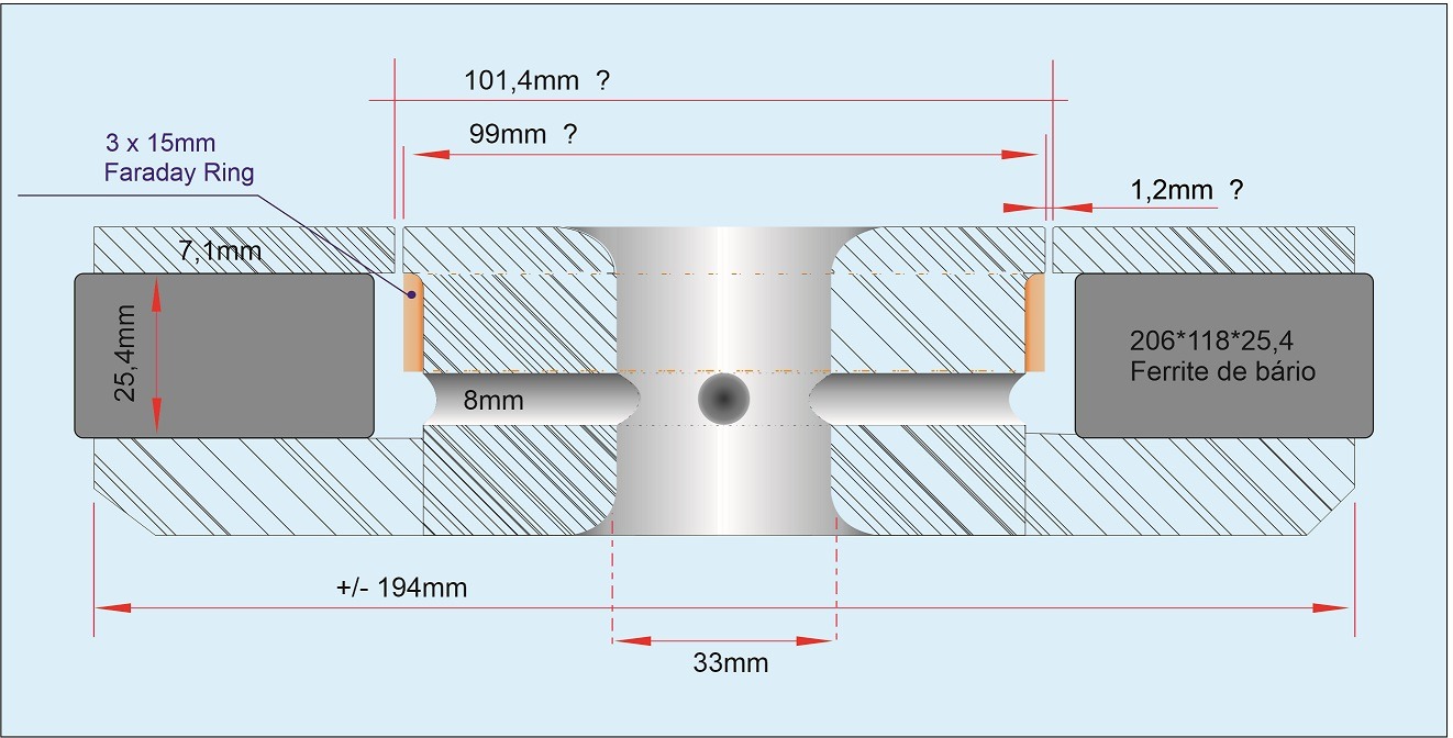

Dear friends, I bring here a challenge from a dream of many years that is getting closer every day.
I am assembling the magnetic assembly to receive the recone kit from a commercial speaker.
It will not be commercialized but made available here in my DIY community, we have good diy amplifiers, but lack of speakers, we have absolutely nothing for a quality residential system.
This drawing is amateur, I'm not a professional designer, but I ordered a drawing in SW that will be ready soon.
*I got inspired by the JBL2235H and made some changes

Hello JMFhey! Thank you for participating.
I had the personalized magnets made, they will be delivered magnetized. Some questions I need support. I don't know if I should buy the medium magnetism factor or the strongest, they are arranged like this: Y30, Y35, Y40.
The basket I intend to buy in China.
https://www.alibaba.com/product-det...00138621911.html?spm=a2700.9114905.0.0.drs7NUAs for the medium-high cabinets that I have not defined, I need my product parameters to be able to decide.

He´s getting the fully assembled and magnetized magnetic circuit, which is then bolted to a cast aluminum frame, which is non magnetic, so no big deal.
Look at the CAD drawing above, you´ll see a ferrite ring sandwiched between 2 iron disks, with a polepiece at the center.

The drawing is amateur, I'm waiting for the CAD SW. Note that I have inserted a horizontal hole so that the air circulation is sucked and pumped from the gap space

I understand now! I didn't realize 1) the magnetic assembly is full assembled, so it will be magnetized when assembled as a unit, and 2) the basket/frame is non-magnetic.
Yes, they are independent, and at a later stage bolted together:
As of magnetic grade, get the highest number available.
Here´s a comparison between Y30, which I find similar to "classic" ferrite, and Y40 which I see as improved.
Classic remanent magnetism Br was 3800-4000 mT (milli Tesla, I still call them Gauss, go figure , whitebeard Engineer here ;) ), modern ones not only improves that to 4400 and above, but also very important, are much "harder" so you can use thicker gaps without much magnetic loss or use thinner rings , saving money and weight.
It also makes it harder to magnetize :(

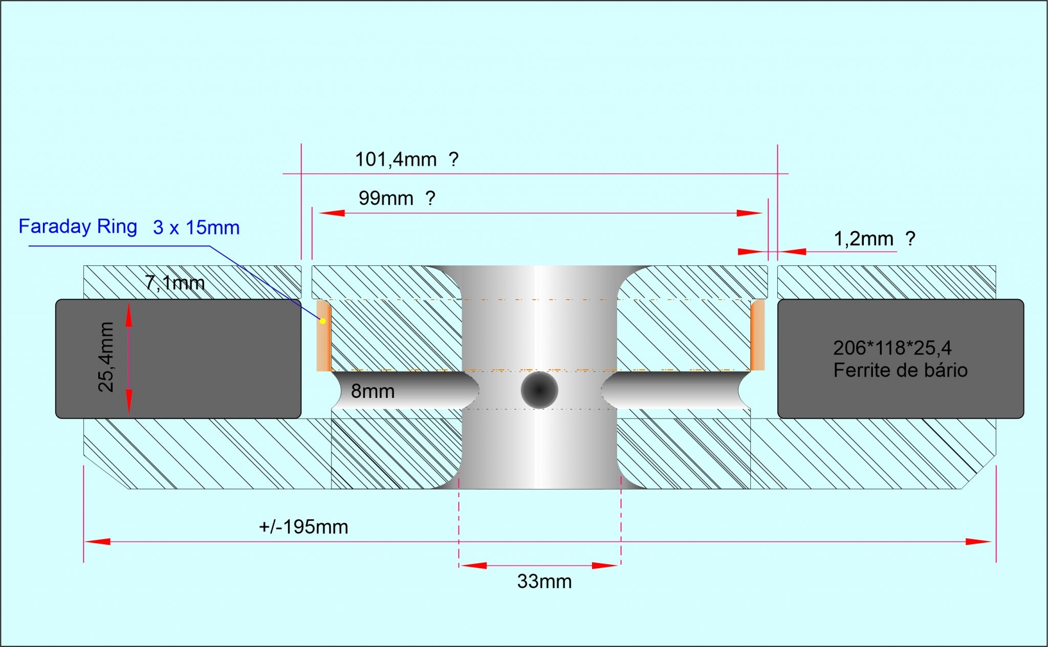

I had a problem:
The company that makes the magnet is not the same company that makes the Iron Set, Top Pole and "T". It is not recommended to magnetize separately, and I don't have the machine.

You can´t spread it all over the place.
I guess you got somebody with a CNC lathe to make the iron parts, then are buying the Ferrite magnet somewhere else (they are definitely not "making" it for you since smallest batch is 5 to 10 Tons), then assembling it at home then getting it magnetized (you won´t buy a BIG magnetizer, capable of 250-270mm magnets just to make a few).
Unless you are making, say, 5000 speakers within a year, your best bet is to work with somebody offering that service "all under one roof".
Be glad you have one such Company in Brazil:
https://www.koimas.com.br/
they custom make whatever you need, under your own specs; they will give you the ready built and assembled magnetic system, ready to bolt to frame and finish your custom JBL clone.
They make that for Selenium, Novik and many car speaker manufacturers.

CARCAÇA 15.8 Alumínio Injetado 15" Diâmetro do furo 127mm Furação centro a centro: 148mm Bobina 99
CARCASS 15.8 Injected Aluminum 15" Hole Diameter 127mm Center-to-center drilling: 148mm Coil 99
I will study the possibility of buying this aluminum basket from them, which will save me from having to import from China.
I sent a message to the company and I'm waiting for an answer about the possibility of them producing everything in one place.
My capital is small, companies like this demand large volumes, I believe I won't be able to.
The other company sells me 100$ worth of what is in stock, and they produce 300$ customized (it's a small volume so I need it)
