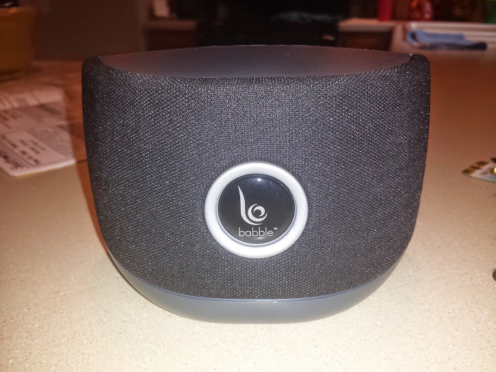

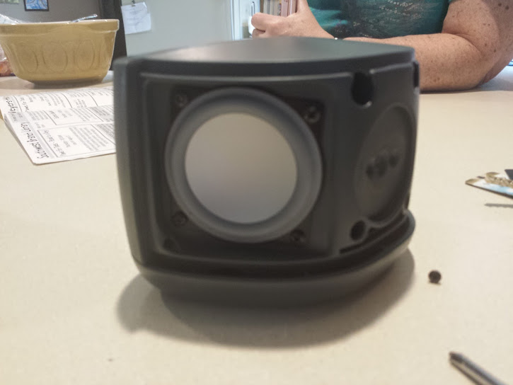

Im trying to roll my own mini boombox, solar with battery backup power. I have some speakers that I want to repurpose, but have a couple questions.

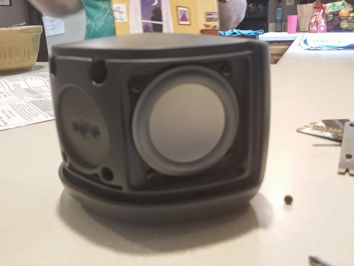

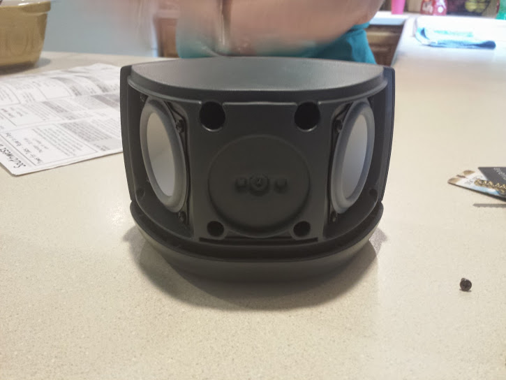

1. The speakers are from a herman miller babble unit. These were some sort of voice masking device for offices, so Im not sure if the speakers will be adequate or the proper type. See pics for the front of the speakers and the back, with specs.

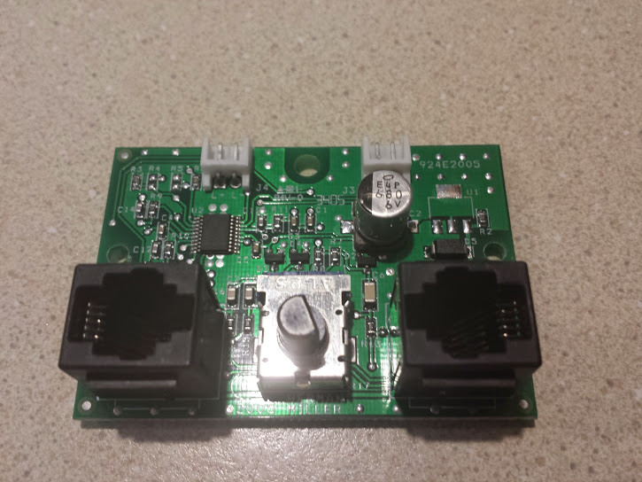

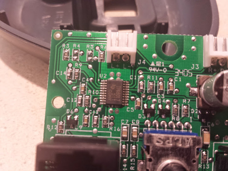

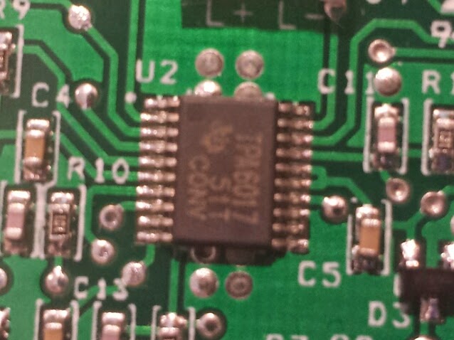

2. The speakers are both powered with an individual amp board inside each speaker, I think they are based on the TPA6017 chip, but Im not sure, as Im not very familiar with audio stuff, but just enough to be dangerous.
(Can I even use this amplifier/circuit to drive the speakers to a proper level for normal use?) See pics attached, for the amp circuit board.
3. I checked the pins coming from the main head unit and it seems to have 6 wires going to it, which I think are two for +5vdc for power, and the other 4 for audio signal, I think, but not sure if they are seperate for high/low frequencies or what, since this is new to me, I have no idea. Looking for some guidance on this. The boards use a phone style plug connection for the wires on the amp, hence the "phone" connectors on the amp circuit board.

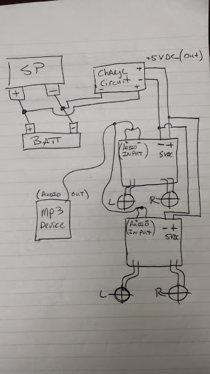

I have a very rough hand drawn diagram of how I think I will need to wire it. I have a (SP) solar panel, with a SLA battery and a usb charging circuit to go from 12vdc to 5vdc for the amp boards. Please let me know if this will work or just shoot holes in my plans so I can put it together right and make it work. I just plan on using an ipod/phone to run audio to it.

Correct, the 6017 is a class AB amplifier.
Honestly, I'd start from scratch on this project. The speakers have unknown parameters, so you can't properly design an enclosure for them. Based on their small size they're probably not all that efficient either - plus if the original application was voice masking, the low end frequency response probably isn't all that great for music listening.
To get started, I'd pick up the following:
- A solar panel - if it's 5 watts or less, you can connect them to a 7aH SLA without worrying too much about overcharging - SLA chemistry will burn excessive charge off as heat.
- A suitable amp that'll run off +12V directly. I'd just buy one off eBay - there's lots of options to choose from, I'd personally snag something based on TI TPA3116. Off the 12V SLA, this will give a peak sine power of ~15W/ch.
For speakers/enclosure, there's a few good designs kicking around - there's a 'Boominator Mini' design which is excellent, but it uses hard-to-get speakers. On the cheapest side of things, which won't be as loud/efficient but still perfectly fine, you could just toss a couple of cheap car audio speakers into an open-backed box.

As a general guide, the battery monoblocs really do need at least 5mm spacing to the next battery and to wall, and the battery compartment needs to be ventilated. And use a comparator to put the amp module to sleep when battery voltage falls below about 9.6V (for 12V battery) to avoid accidently flattening the batteries to their death.
That is far far far too low for an SLA battery.
I would put the cutoff at 11.5v to compensate for voltage drop while under load but also to prevent SULPHATION of the battery.
SLA batteries are already dead at the 10v mark, 9.6v is just torturing a corpse.
