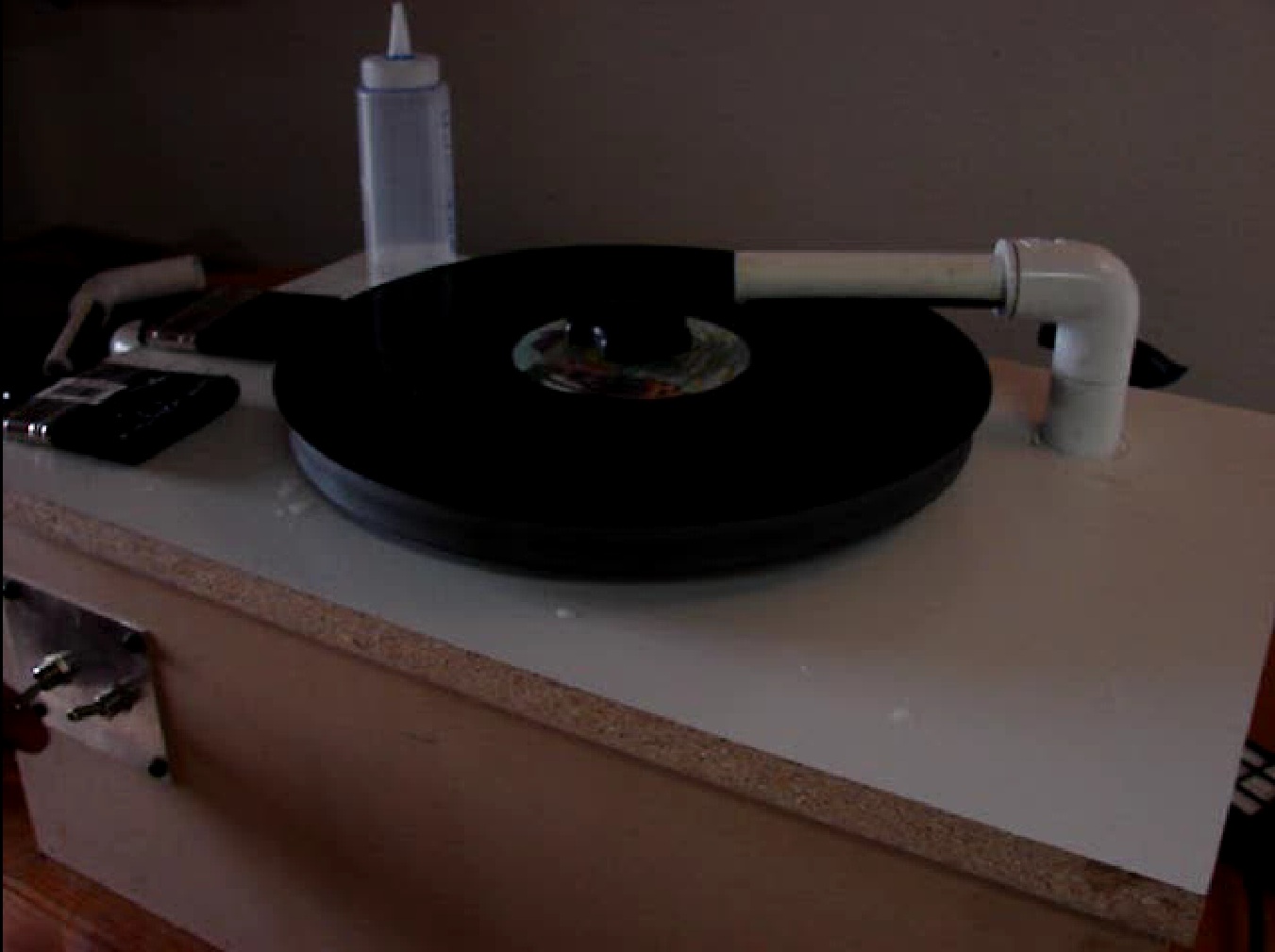

I have been purchasing old vinyl records and needed a more efficient way to clean them. I embarqued in the buildout of a cleaning machine emulating the VPI.
I used materials I had laying around in my garage. The only items I had to purchase was a used Ice cream maker from the goodwill store and the PVC plumbing parts for the vacuum wand. Using off the shelf PVC pars and a spring, I was able to replicate the spring loaded arm the way the VPI machines does it. The machine works quite nice.
I am now giving it the finishing touches. Exernal paint, wood trim on the top and a sealer to the inside chamber. Will post when complete.
I have lots of tools in my garage, so it was not to difficult to build.

I built one using some VPI replacement/upgrade parts a few years ago, and a repurposed low end pioneer (?) or similar TT, generally works well, but in my case the suction is a bit marginal. Works best when vacuumed very slowly. Mine is all manual..
Can't really see your picture - too dark, can you post another?

WOW! That's really neat.
How much did the various stuff cost?
Also, the platter seems to be spinning a bit faster than most record cleaners - has that been any issue with keeping fluid on the record during cleaning? Does the vacuum remove all the fluid well? (I am guessing that there is no problems, just curious...)

He has a link above the thumbnail to a page full of good pictures -
http://picasaweb.google.com/alfredo...?authkey=Gv1sRgCJfv4d7G-vzpcA&feat=directlink

kevinkr said:Can't really see your picture - too dark, can you post another?
As to the cost:
ice cream making machine: $14
vacuum motor: already had from broken upright
Cabinet materials: already had pieces in my garage
PVC plumbing parts: less the $3
Velvet strips: from my wife's bin.
Switches: from my parts bin
Platter Bearing: parts bin
metal wheel with shaft: parts bin
Small fuel canister for water reservoir: $8
plastic discharge tubing: less than $1
Total: less than $26
Tools used: Drill Press, Miter Saw, Band Saw, Plung router, circle cutter, bits, nail gun, air compressor, hacksaw. These tools made it real easy to build. but these are not cheap. Leveraging resources 😀
the platter spins at around 38 rpm. The fluid stays on the record fine, unless i over doit. The vacuum is very powerful, it removes all the fluid. I had to drill a 3/4 in port hole to lower the suction power and allow the motor to work easier.

i just loooked at the pics in the link, the gas can is brilliant!!!!
i was going to reuse a 1 gal milk/water jug, but the gas can is better.
