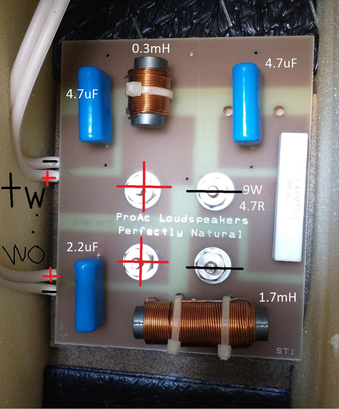

Hey there!
I am aware that this thread is kinda ancient but hope I am still lucky to get some answers here.
I have owned a pair of Proac Studio 1 MK2s and then wanted to attempt building the Studio 100s. So now I have some ScanSpeak 18W/8542-10 and Seas 27TFFC chassis laying around, cabinets are built (although not yet flush mounted) and I tried to assemble the crossover several times. I think I have the right values and did the crossover like this:
I also found this picture of a S100 crossover and have noticed that Tweeter - is different here.
So: tuning is completely off and I don't know why. Any ideas or suggestions what the problem might be? I don't think it's the flush mounting, neither the slightly different version of the woofer (-10 instead of -00). And is the Studio 100 really that bass light or is that also part of my wrong tuning?

Show us the x/o values, schematic, enclosure internal volume, baffle measures, driver positions on the baffle, and I'll have a look at it.
Crossover is not assembled at the moment but I did it the same way as followed:
2 x Solen Cap 4.7uF 400V
1 x Solen Cap 2.2uF 400V
1 x Expotus 9W 4.7Ohms
1 x 1.7mH High Power Ferrite Core Audio Inductor
1 x 0.3 mH High Power Ferrite Core Audio Inductor
all ordered from Falcon Acoustics
baffles are 404 x 202mm ; 241mm deep and made of 19mm MDF
about 10mm bitumen to every side and 30mm foam for damping
bass ports are 50mm internal diameter, cut to 130mm

Your part values are very close to the ones I noted for my Studio One Mk II years ago: the capacitors and resistor are identical in value, and my measured inductor values are pretty close to yours. So it seems the crossover didn't change much from S1 to S100, despite the change in position of the tweeter.
Alex
Alex
Hi Alex,
yes that's right AFAIK. Also biwiring is new but I did not biwire mine. I think the S1Mk2 uses the 25TFFC + 8542-00 and the S100 the 27TFFC + 8542-10, though I am not 100% sure.
