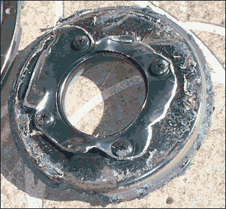

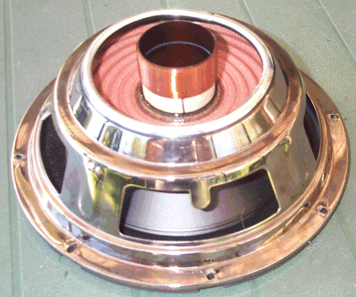

It really depends on the construction.
The driver I'm playing with had the magnet glued and screwed onto the frame. The only way to undo the screws would have been to remove the cone, and I was woried that the spyder, which was glued into place would be damaged.
Since the frame was pressed steel, an old chisel worked well to cut the magnet off. - see attached pic....
The ragged edge left on the frame was cleaned up with some shears.
Had the frame been cast, a hacksaw would have been needed, resulting in a lot of metal dust, which would have gotten into the spyder.
Some grease would have fixed this, but getting it out again would need solvents that could damage other parts. Perhaps a water based gunk of some sort. Decisions, decisions.....

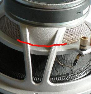

I ended up getting a motor assembly off one sub woofer (B&W) a while back by using wedges between the motor assembly and steel basket. The fasteners just pulled through the holes as easy as.
With driver I was going to use for a PR, the cast basket was going to be cut between the spider and the motor.
