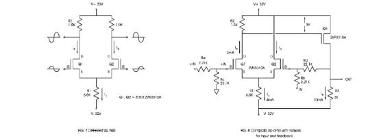

I like to built a HI HI -END , a univesal , true/pure class A opamp base on N.PASS circuit to replace my current opamp in my cd player . I need somebody to help me on this . My dac is SM5872 .
What type of mosfet/JFet should i choose ? Wide feq ,high current
high power low s/r .......s/n ...... ? and i know the voltage from DAC is very low ~ 0.3V i guess. How to mod this circuit to work and output around 2~2.5V ? OR resistor network that i can direct drive my power amp ? thank you ! *** If anyone know the PASS D1 DAC opamp circuit diagram please let me know !****thank a lot !

I think you are a bit mistaken on your facts. The SM5872 is a voltage output DAC and the datasheet gives an output voltage of 2.0 Vrms typical. So you need more like unity gain from your circuit.
Also I think it would be wise to plan at least some sort of low pass filtering as the DAC is high oversampling one and your amp may not respond very well to that amount of high frequency content.

hi there, my cd player is marantz cd67. after the SM5872 i found two opamp JRC 2114 and HDAM . what is that for ? And i check the data sheet the Lo voltage is 0.3V . I'm not sure what is PWM output .U got any idea ? Thank .
In CD67 the first dual opamp per channel is for low pass filtering and the HDAM is for output buffering. I've experimented quite a lot with this analog stage. I have replaced the opamps with LM6172 (similar to tweak on www.tnt-audio.com) and also tried to leave out the HDAM. I didn't like the sound without buffer though. It seemed to be too much for opamps to drive the load and almost all aspects of sound suffered....

The D1 uses DACs whose output is a current
source and is designed to drive a virtual ground;
something that the SuperSymmetric circuit
intrinsically offers.
This type of DAC lends itself best to simply driving
a common Gate or cascode transistor without
feedback, and it works perfectly.
In your case, you have a high voltage output. Perhaps
you can simply put a passive low pass filter on it and
send it directly into your preamp.
