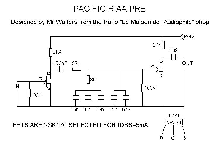

I'm currently trying to build a mc-stage for my diy-ed phonostage 'le pacific', a two-stage jfet Design using the KISS-approach developed by a french audiophile.
It basically works; but while trying out several jfets, there is some strange behavior. It might be a kind of oscillating, I don't know. It produces a frequent and stable popping. Playing with load resistor,, it is possible to 'silence it', but the signal is still modulated with it.
The stage consists basically of a 4K Load-Resistor, a 2SK170 JFET (tried 3,5 and 6,3 mA IDSS), tried 0-68R Sourceresistor, and 0,65uF Cap at the output. Driven with 24V batterie, and this stage is etrxa de-coupled with 10.000uF Elna electrolyte.
Used with 2SK369 the stage works (with and without electrolytes), but lacks a bit of bass and tightness.
Where can I start to track the problem down? I'm more or less experienced with existing designs, but new to try some of my own.

you may need to decouple the stages from one another. circuit are known to oscillate without decoupling. normally go with a RC to form a lowpass filter. I don't have the proper formally for the proper values though. Or try a LC lowpass filter(better no voltage drop). C is normally 220uf-470uf , R is normally low 10 ohm.
Try searching for power decoupling tutorials, you will learn alot from it. Also used a good cap for c (BLackGAte,ELna, Muse etc). You used a 10uf Elna only that is actually bypass only. Doesn't totally isolate the stages from one another( sk170 at input and the sk170 at the output). Decoupling is much better. For bypass try blackgate high q nx work like magic but cost like hell. Just my two cents
P.s batteries supply has high impedance , use caps to bring it down. High speed caps is a must here

NickC is on track with his advice. Are you adding another gain stage to what you have now to give you the extra gain you need for the MC pickup?
If so decoupling the power supply between stages and bypass caps should make a big difference. Bypassing needs to be done locally at the gain stage for it to do any good and every gain stage needs it in low level, high gain amps.
You may want to think about using pcbs with a good ground plane. This may also help. Others may think differently about this but it has always worked well for me.

have to agree, my one FET MC headamp also went better with a grid stopper oops gate stopper.

My one FET single-ended MC-headamp used 12V supplied by AA NiCd batteries, it used one 2SK43 per channel, 2SK240 also is usable. drain resistor was 1k, input load resitir also was 1k, both tantalum oxide. Output coupling cap was 0.5 µFSiemens MKV 25839.
PS caps were huge Siemens electrolytics, 100.000. µF bypassed with 2x1nF silver mica.
If you use the search engine, you may even find a pix i posted.
Gate stopper was added later so i remember, nonmagnetic SMD, 100Ohm. Or was it 50?

in my case, (correct) decoupling was the way to go. Found two 47R Resistors and soldered them in.
@HDTVman:
It's a three-stage design now. The last two are as described in the circuit, the first one as described in my first post.
What do you all mean by 'gate stopper resistor'? 100 Ohms in series? This is already the case.

I tried those first in my mc-stage. They work, but lack bass and tightness. That is the experience of hifidaddy as well.
I wouldn't use them. This phonoamp is supposed to be a quite good one, really high grade.
My current design does not sound bad, though it is not a killer by now.
There are suggestions to try 2SK240 double-fet instead.

I suggest that You implement a RF-filter at the input.
2k ohms in series and 100pF shunt to ground.
I have designed a RIAA-stage comprising one 2SK170 and one OPA2134 per channel. It works excellent with extremely low noisefloor.
