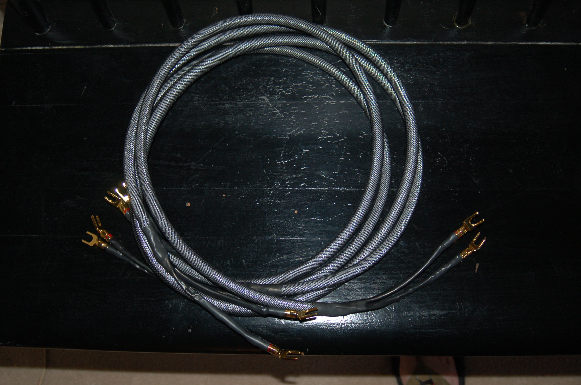

All they are is nice looking Canare /Star Quad and cost me next to nothing![]()
I was looking at them and they are described as "microphone or line level cables".
Do you have positive experience with them as speaker cables ?
They seem to sound fine.
4s11 star quad with a flex coating, some shrink wrap, and Nakamichi spades
Works great and cheap to
