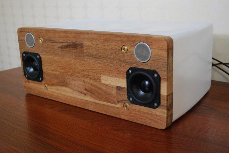

If you're not afraid of some woodworking this one was fun to build.
http://www.diyaudio.com/forums/multi-way/148807-transmissionline-ipod-docking-station.html
It uses a TA2024 amp and Peerless P830986 fullrange drivers combined with cheap ebay ribbon tweeters. Placed in a corner the sound fills up a normal room quite nice.
Regards H@kan
