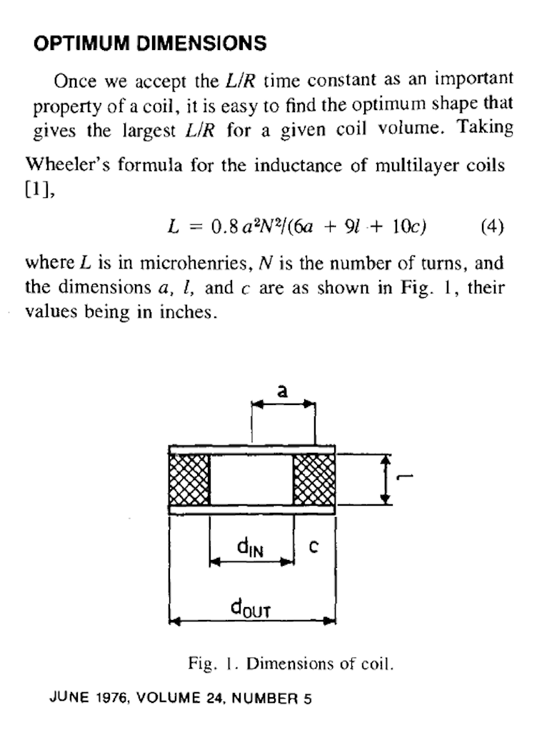

Thiele merely applied the appropriate formula that he found in Wheeler's 1928 paper. Thiele cites Wheeler's paper as his bibliographic reference [1]. Screen capture image from Thiele's AES paper, below.
Besides the wonderful web-based "calculator" linked in post #9 of this thread, there are a bunch of other websites that present and discuss Wheeler's formulas. Here are a couple nice ones:
Wheeler Formulas for inductance
http://www.thompsonrd.com/induct2.pdf

Q:
A] I don't see any mention of wire diameter in the Wheeler equations (Inductance Calculation).
B] How does one calculate the amount of DC the coil will handle?
A:
A) Wheeler (And many other, see the Langford-Smith book) formula is an approximation. There is no exact formula for real world inductors because their inductance is affected by a multiplicity of factors;
Wikipedia comfirms my previous knowledge:
As a practical matter, longer wires have more inductance, and thicker wires have less, analogous to their electrical resistance (although the relationships aren't linear, and are different in kind from the relationships that length and diameter bear to resistance).
B) DC inductors without iron cores or with open magnetic circuit, are usually based in maximum resistance to DC, or sometimes, self rigidity to vibration and movements. In RF large copper diameters are used and in extreme cases, they are silver plated at UHF frequencies to reduce skin depth effects.
Joined 2011
Wire diameter is not included in the Wheeler inductance formulae for multi-turn coils; because its effect is extremely small. The formulae are accurate to 1-2% even when neglecting wire diameter entirely. Thus the effects of wire diameter amount to less than 1-2% of the total inductance of a multi-turn coil. Wheeler, an engineer, considered it negligible. And he neglected it.
