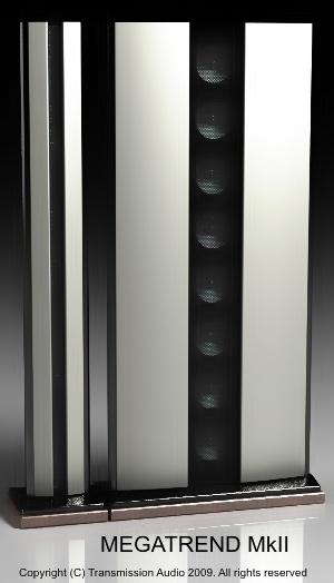

I don't know of a true ribbon dipole driver that is efficient and is also a *long* line source - that is commercially obtainable.
The resident expert on DIY long ribbon drivers would be Paul W. (..but he has personally moved on to large horns).
These people appear to do custom orders on longer line ribbons, but list neither the cost nor the measurements:
Transmission Audio Inc.
