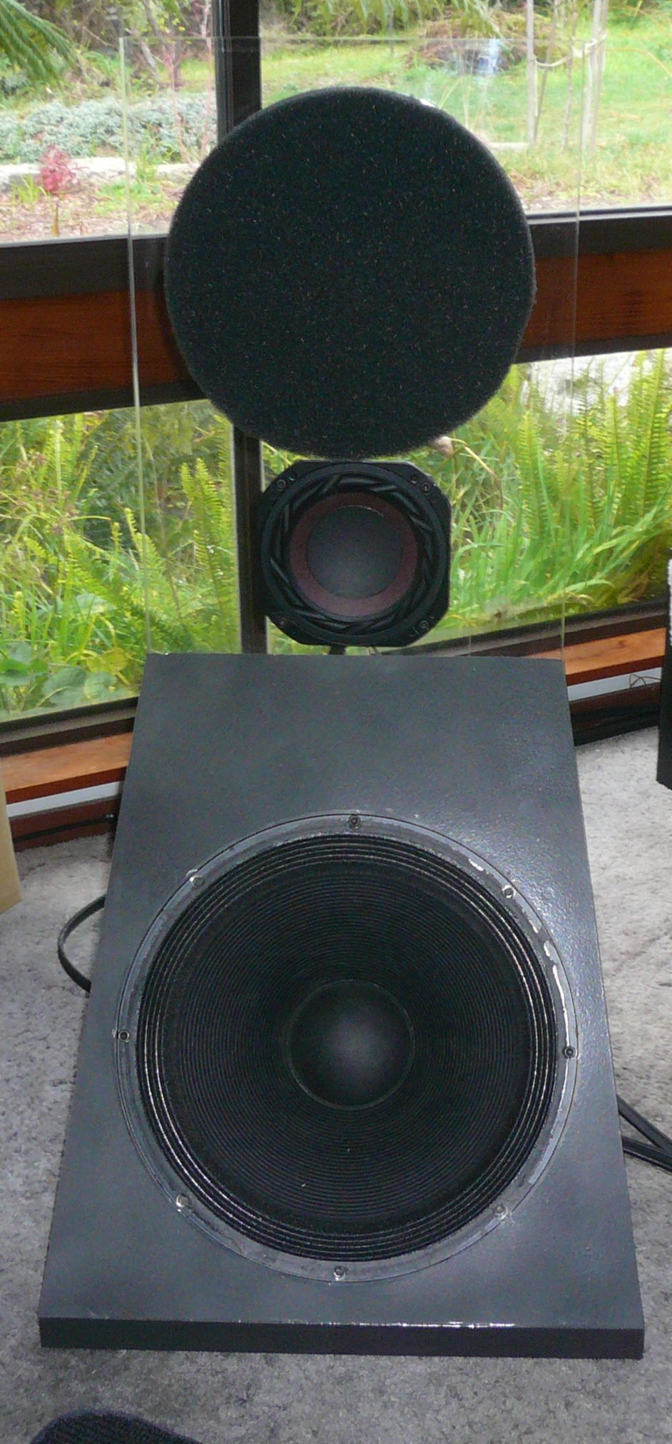

Hi Enzo.
I've made a baffle with plexiglass (25mm or 1" thick- very expensive)!
I discovered that it is too flexible, even at that thickness, to resist the vibrations of a woofer.
I mounted the woofer on a sub-baffle that didn't touch (which I think is a good idea anyway for a flat baffle).
I have seen a picture of a Supravox mounted on plexiglass, but it was reinforced by- wood?
David

I made open baffle speakers using 1/2 inch plexiglass actually LEXAN.
I made H frame woofers according to MJK's articles found here in the diy audio site (full range forum). I made four sets of those. One in solid maple for my daughter, two out of MDF for my brother and my friend, and one for myself out of maple plywood.
For the full range speakers, Three were made out of Lexan. Just for the two full range speakers (open baffle) (one piece) 2' X 2' it was almost $80 per pair!
It worked out well (is a inherently damped material).
I used a drill bit that I filed down so that the angle of the tip was flatter.
This causes the bit to not dig as quickly, and reduces the likelihood that the plastic will crack while drilling.
If you want to glue pieces together, you could try acetone. It will "disolve" the plastic, then clamp them together, and "voila".
If it migrates much, it might make the surface hazy. Give it a try on spare pieces first.
To attach the drivers, I drilled holes through the plastic, and used bolts, you could try this for attaching the side pieces to each other also.
good luck, I think it will be quite expensive.
Hope this helps,
Paul

ps.
I got some scratches in mine while working on them, especially cutting out the hole for the driver.
Get some auto polish, and some polishing pads from your optometrist (used for fabricating eyeglasses. Apply the polishing pads to a block of wood apply polish liberally, and rub!
Paul

Plexiglass has some excellent properies, but you need a milling machine to produce a baffle. Very likely companies that produce illuminated signs can make parts for you. Make a drawing in a CAD program or in Corel Draw, save it as vector file and solicit a quotation.
An excellent glue is ACRIFIX®
When choosing a glue, get proper advice from the seller. There are different glues for extruded and for cast material. If you don't get the right glue, your piece will suffer from a lot of cracks.

Lexan is the brand name for polycarbonate, not PMMA(acril\plexiglass)..1/2 inch plexiglass actually LEXAN..
had you glued PC with acetone
Why not do a magnet mount of the woofer? That way it would be decoupled from the plastic baffle. The baffle will still vibrate simply from air pressure, but not nearly as much as having a 12" woofer bolted to it.

before you start cutting expensive plexiglass, have you determined the suitability of the 12" woofers for OB?
Actually, the question is how are you going to EQ them, and at what frequency would you like to cross them down to the subwoofer? I would guess that a single 12" woofer used OB would only be good down to 80Hz or so, at best. But that may be a good place to bring a sub in. Similarly, you will have a very very difficult time developing the EQ/crossover if you aren't doing any measurements. This could be a very time consuming project, just so you know.
I've worked with plexi/lexan some - it is seriously prone to breaking if not cut right. Milling may be your only option, and I would absolutely make a test baffle first out of wood. On the other hand, I don't think that you will be losing any sound quality by using plexi/lexan. I second magnet mounting all the drivers.
