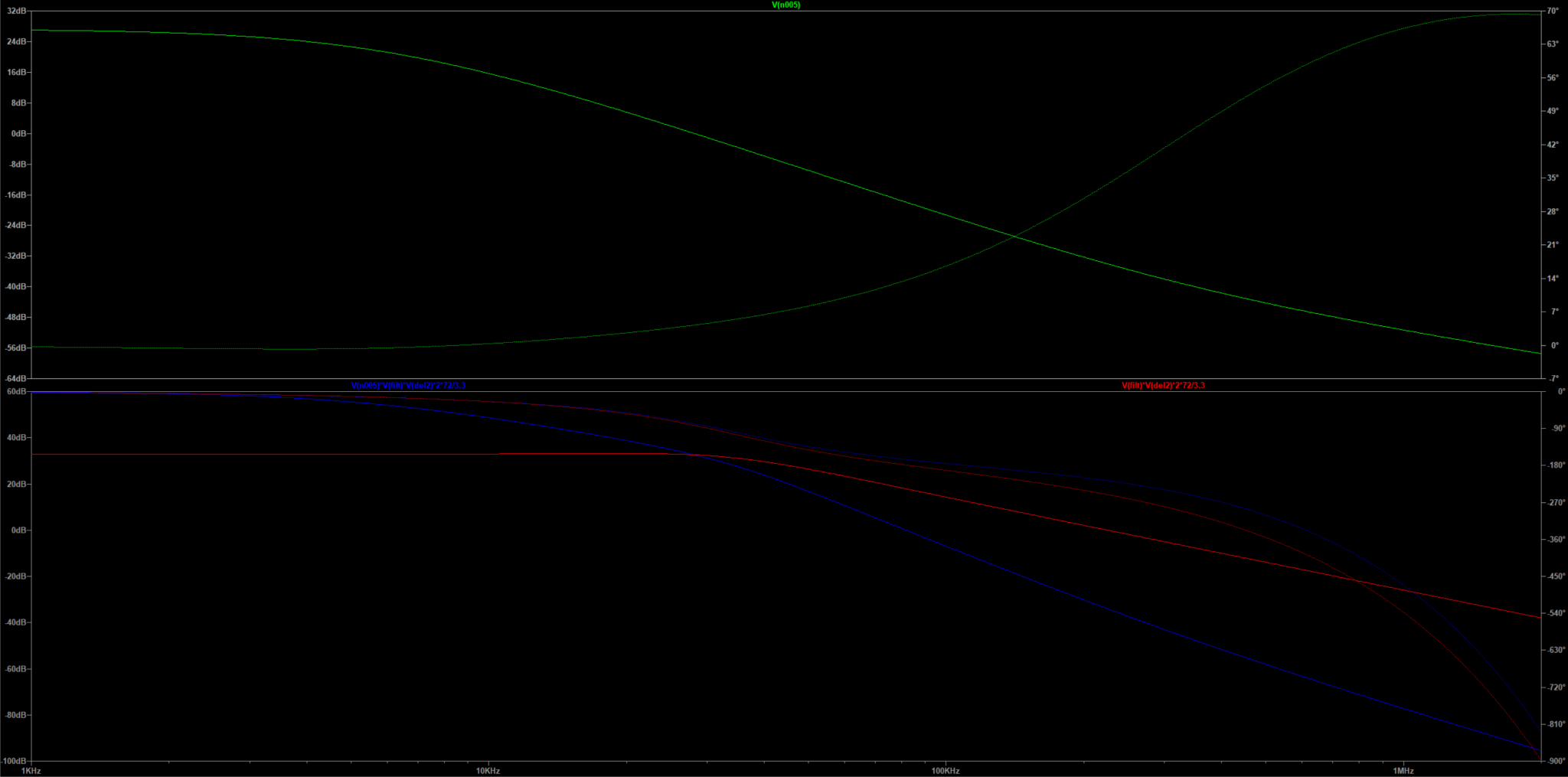

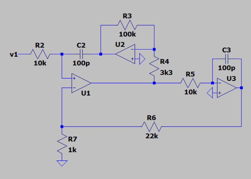

Couple possible things I found to increase stability:
Paper about distributing delay which could be accomplished by running both the Certus-NX's ADCs a couple pipeline cycles apart. I'm not too sure on this one's feasibility or effectiveness for this use case, but I found it interesting.
The second one is a 2nd order integrator configuration that adds some phase lead at higher frequencies. Top plot is just the integrator, red is output filter + delay, and blue is the two multiplied. Right now I have about 10db of gain margin, which can be adjusted. This seems too good to actually work though, like I'm having my cake and eating it too?
