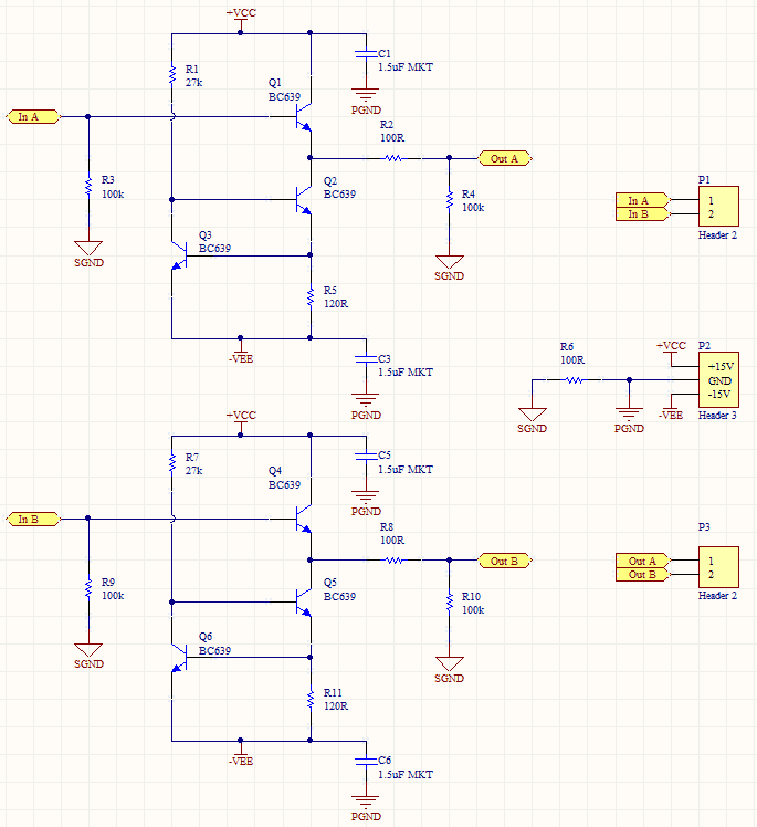

This is my version of the class A BJT transistor buffer from Building a buffered Gainclone chip amp. ("Simple class A discrete buffer circuit"). I've omitted the DC blocking capacitor as my power-amp circuits (LM3886 units) already have them on their input.
Will four 1.5uF MKT capacitors be sufficient for decoupling? It will be powered by a regulated +/-15V supply.
Other than that, just running this design past people more expert than myself (there are a lot of you, trust me) to see if my version is sane and workable before building it.

I assume you simulated this circuit or at least adapted from something successful,
but why the 1 amp BC639? Sure, this a class A output stage but what do you have
in mind as a load and your planned quiescent current? If you need high output current
capacity and hence will have high quiescent current and dissipation, the T0126 version
BD139 is a lot easier to arrange cooling for. OTOH, if this is a marginal rating issue,
BC327 or 8 are no slouch at this type of duty.

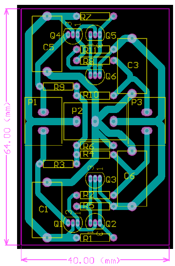

A simple buffer will not have many layout issues provided your supplies are well filtered
for the current required. Bypass requirements are pretty much related to that too.
Not sure that placing the power input terminals central and running the 15V rails between
the in and out signal terminals is a good idea, though. Generally, keep them well apart.
Good luck and watch pinouts if trying substitutes!

Thanks for comments. As it's driving a chip-amp, the load is small, way way below, as you suspect, the 1 amp 639s specification. The choice of BC639 was dictated by what is locally available in retail stores. There are many other choices but that unit was the only one the original article at Decibel Dungeon mentioned that I can source locally, so at least I know it works without any major problems. I may get into trying different BJTs in the future (in case it turns out I don't have a life after all - you never know). Your point about the supply rails going close to the signal lines is an excellent one - thanks for pointing it out.

from my experience the 1.5µF caps should be way sufficient for local onboard buffering of the supplies.
Especially when there is only an intermediate load to drive like 10k.
Wouldn't run the buffer on much lower load impedances than that though without increasing the standing current, as the max out voltage before (current limit induced) clipping is 0.6V/R5*R_load.
Also take a look at your voltage-regulators in combinination with the buffercircuit, and what else may be running off them.

R3 and R9 seem like very high value for a bipolar input. Are you feeding this circuit from a DC coupled source?
The current source emitter load is around 5mA. This means, assuming an hfe of 300 (my guess), the base current of Q1 and Q4 will be circa 17uA. Across a 100k bias resistor this is a voltage drop of 1.6V - which translates directly into loss of headroom. Ugly.
Most source equipment (CD player, iPhone/iPod)now days will easily drive 10k, and 5k is usually no problem.
10K is more reasonable for R3/R9?
I expect the input will be a CD player or the output of my PC's Xonar Essence sound card, so, no, not DC coupled.

it would reduce the offset, as bonsai pointed out.10K is more reasonable for R3/R9?
Of course if you had a source that can't drive 10k then the circuit is pointless.
What is the input impedance of your gain clone. if it is somewhere around the 10k your source should have no problem driving it, again as bonsai pointed out.
So if that's the case (your sources beeing able to drive the GC directly, and the ones you mention very likely are able) then there is no technical reason to add this stage.
Only if your going to drive loads with significantly less impedance than 10k like 500 Ohm, because then your buffer would clip at levels of around 2.5Vpeak (see my first post for the math) which is roughly the level of CD-Player outputs (correct me if I'm wrong here).Do you recommend changing R5?

Does one omit the feedback resistor in the ESP design for 0db gain? I'm familiar with NFB in op-amp ICs but have much to learn about fundamental transistor and amplifier theory. Am looking into doing an EE course at the TAFE (apologies to foreign readers: TAFE = partly government funded vocationally oriented polytechnic-like tertiary education organisation).
The only complexity of the ESP preamp circuit is due to inclusions like quiescent current adjustment and some linearising circuitry, including a little feedback. In practice, you'll need to do some things to your buffer to establish acceptable operating conditions and, since they will be a critical part, the power supply(s) too.
Note that just removing the feedback resistor R5 will disturb the DC conditions of the input transistor and lead to some problems you won't need.
Feedback also determines the gain of the amplifier by the ratio of the voltage divider formed by R5+R4, so the appropriate change is to increase R4 which, due to the cap., only affects AC gain. You won't be able to remove all gain and the reduction of feedback will result in increased distortion. However, this is a good testbed for checking the amp theory out and show you the problems ahead for such simple buffer designs.
