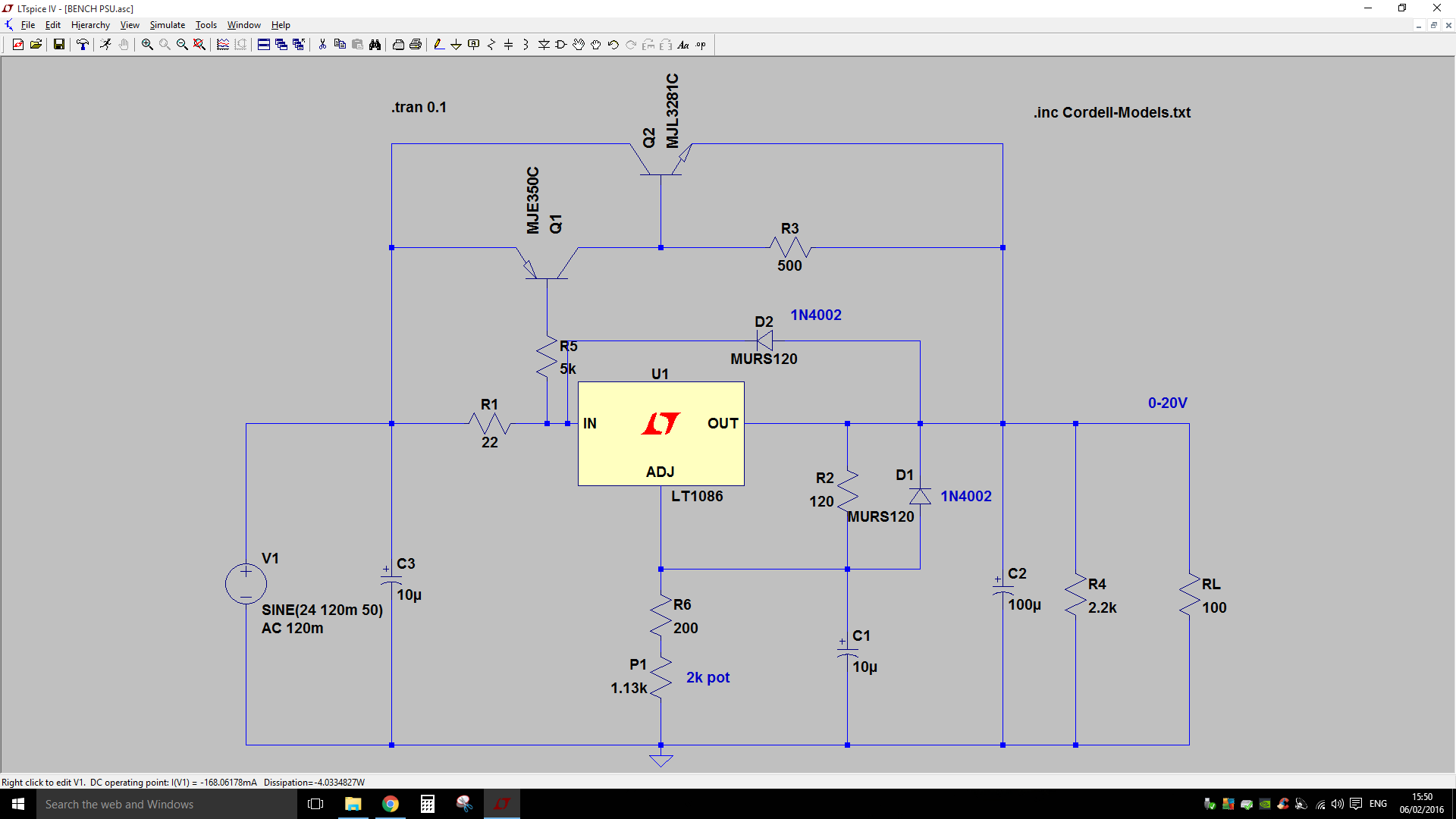

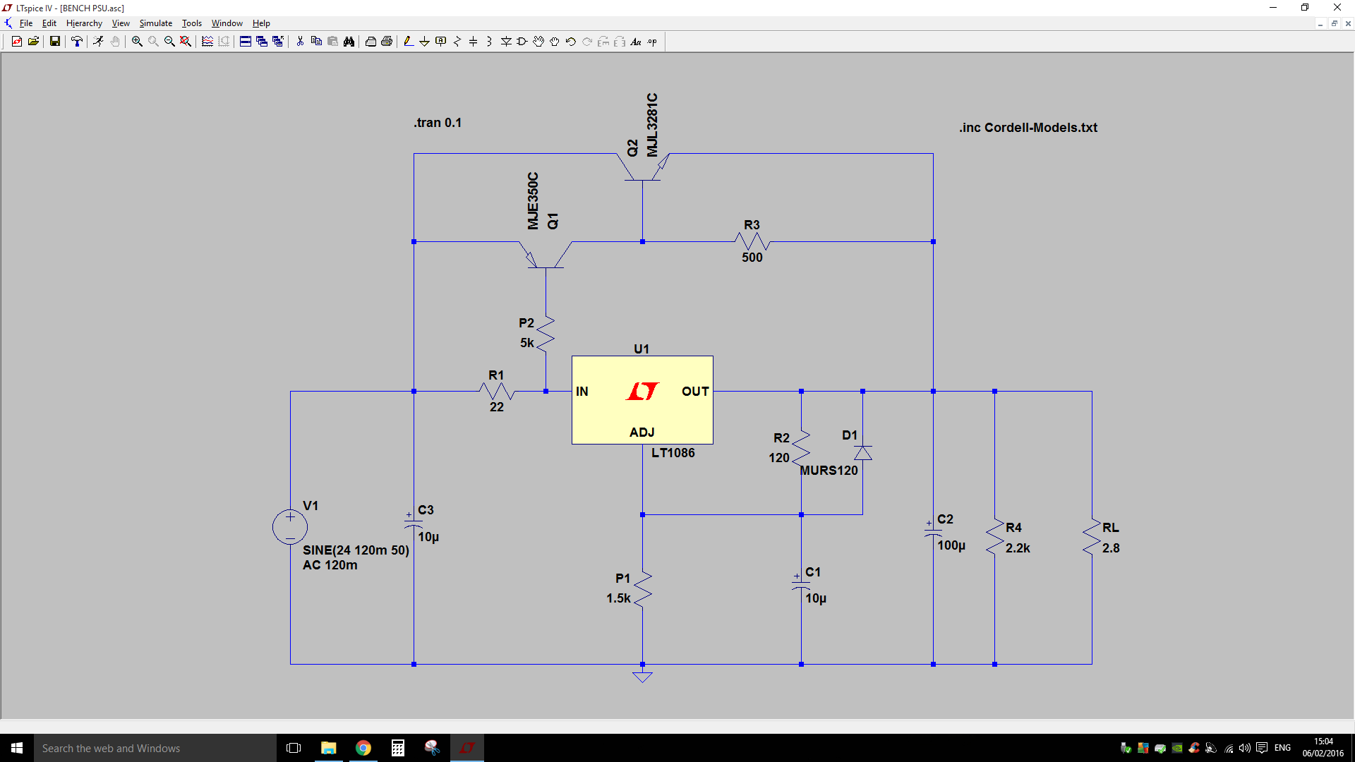

Keep in mind that you'll need a huge heatsink if you don't want to put something between Meanwell and sketched regulator. In theory up to 100W per rail.
Indeed a big heatsink is needed. I just realised that LT1083 is capable of 7.5A so I might just use those. Not on digikey or mouser though hmmm...
You wont be able to lose 24V @ 5A through a single LT108X.
You will need to spread the heat loss through several pass transistors, or parallelled regulator IC. For the later there is a lot on the net. Might even be some examples for the LT108X ICs. They are expensive though...

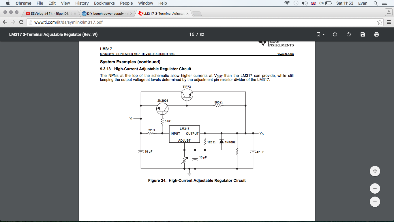

For the former, look for schematics aswell. Most powers upply schematics deal with rectified AC input and a large cap, you have a good DC voltage (albeit with some HF ripple and noise)

It's nice but a bit too complicated for me.
I think I will do a pair of bipolar channels with direct output from the SMPS up to 5A, and then add a couple of adjustable bipolar channels up to 1A.

Since the output voltage of the SMPS is 24V regulated, you don't need a regulator. One pass transistor and a potentiometer should be fine. Current limit can also be realized, if needed, with few components.

just a note for ya > the 2 resistor string R1, P1 controls the voltage, so the actual connection should be near the panel jacks (use smaller wires) for precise control at higher current draws.
