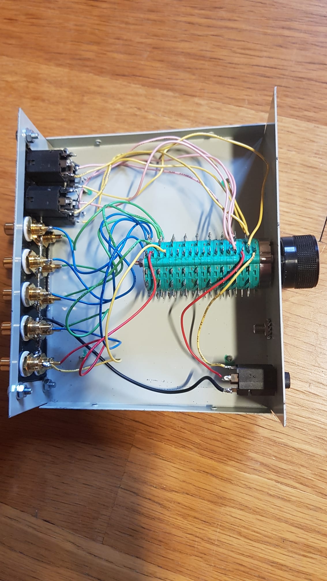

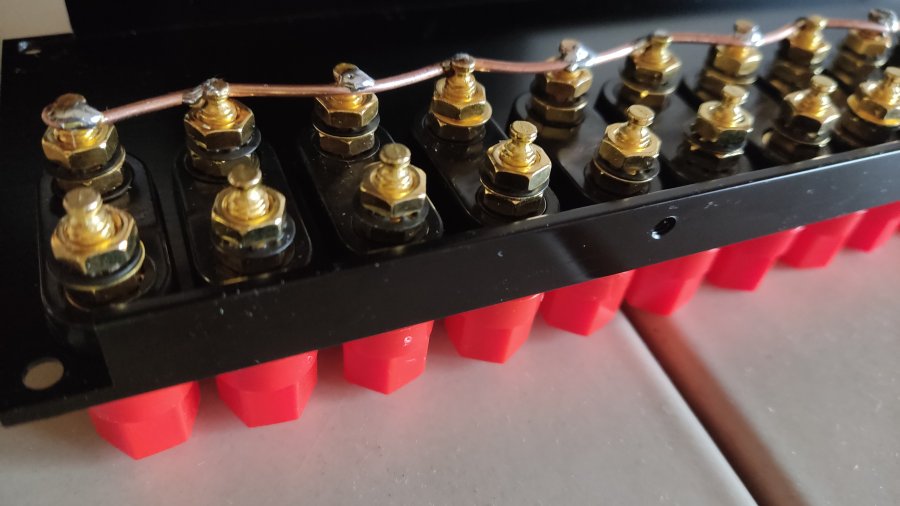

Hi Folks,
I needed a switch for upcoming A/B double-blind testing in the coming weeks (more about this in an upcoming topic - stay tuned!...).
While such simple switches are easily available online, I couldn't find any that could switch sources and outputs at the same time.
Being a big fan of reusing/modifying stuff as opposed to buying new, I had the idea to repurpose an old LPT Printer switch, which allows to switch between 4 printers connected to a single PC. I saved that unit from the scrap (actually, I took it out of the trash) in Montreal about 15 years ago, knowing I would need it one day. Well, the day has come!

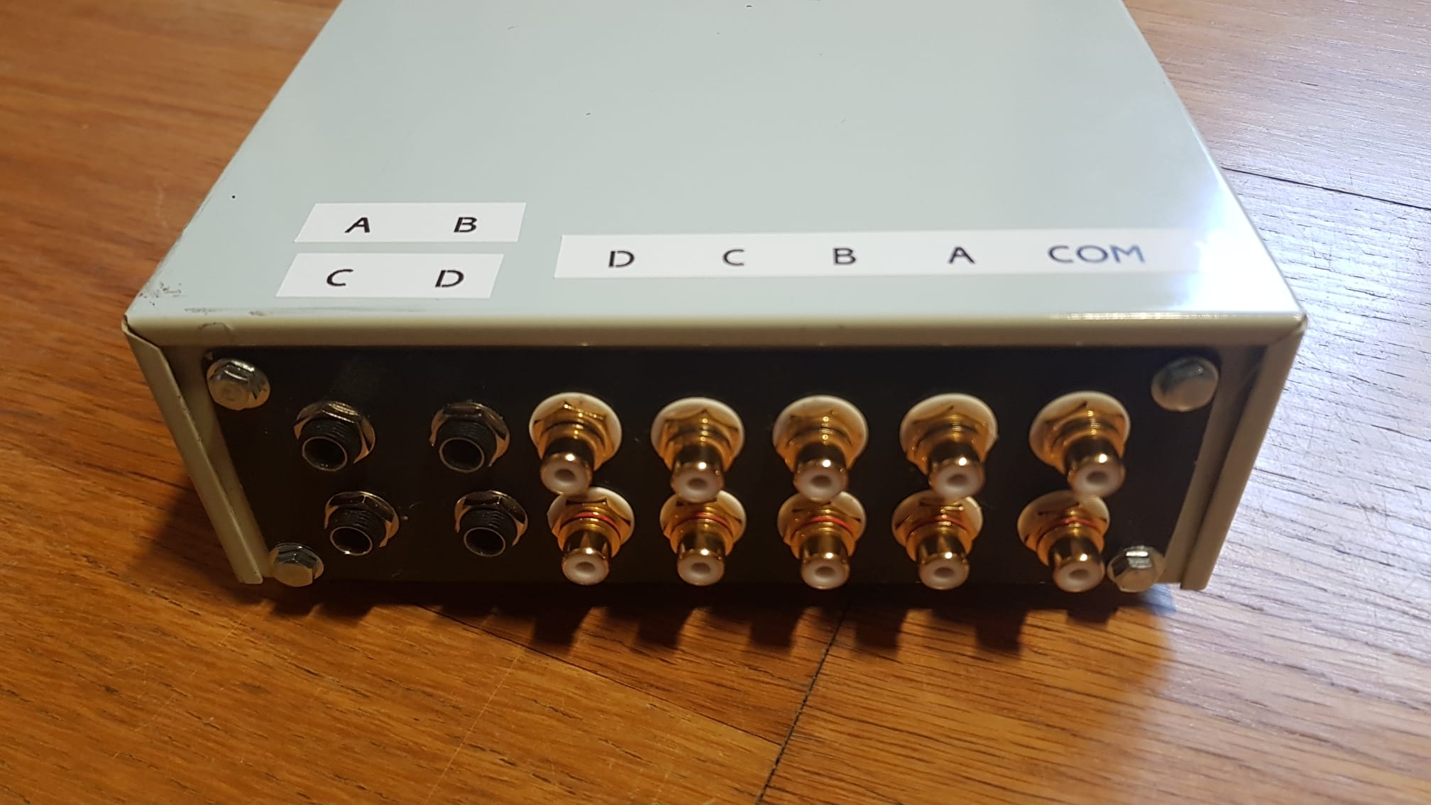

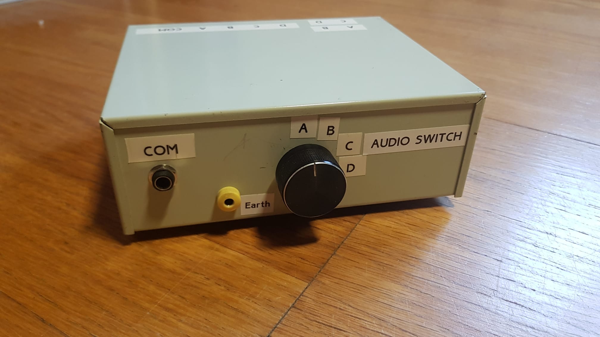

Here are a few pictures of the modified box. I added a 4mm banana-connector on the front to connect the metal enclosure to earth if needed. Earth and signal ground are or course isolated from each other.
It turned out to be a 4-way A/B/C/D switch instead of only 2 positions...even better! Now I can tests 4 devices at the same time!
For each of the 4 positions, the COM jack on the front is connected to one of the jacks on the back, and simultaneously the COM RCA is connected to the corresponding A/B/C/D RCA's as well. But the jacks and RCA's are completely independent. Therefore, I can use this box either as a jack switch only, as an RCA switch only, or both at the same time, which is perfect e.g. for testing different headphone amps by switching the signal between the source and the amp's input via the RCA's, and the outputs of the amp via the jacks (the headphone would be connected to the COM jack on the front).
The switch itself is of very, very high quality (in fact, I use the same ones on DIY preamps). It has silver-plated contacts, nice solid feel, extremely durable...). the switch alone costs way more than 30 EUR if you want to buy it new.
I wanted to share this, I hope some of you will find it useful!

I did two of them in a similar way coz I have four receivers to test.

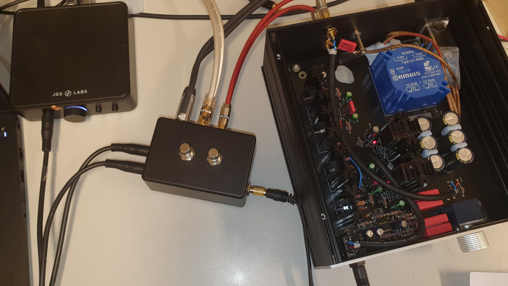

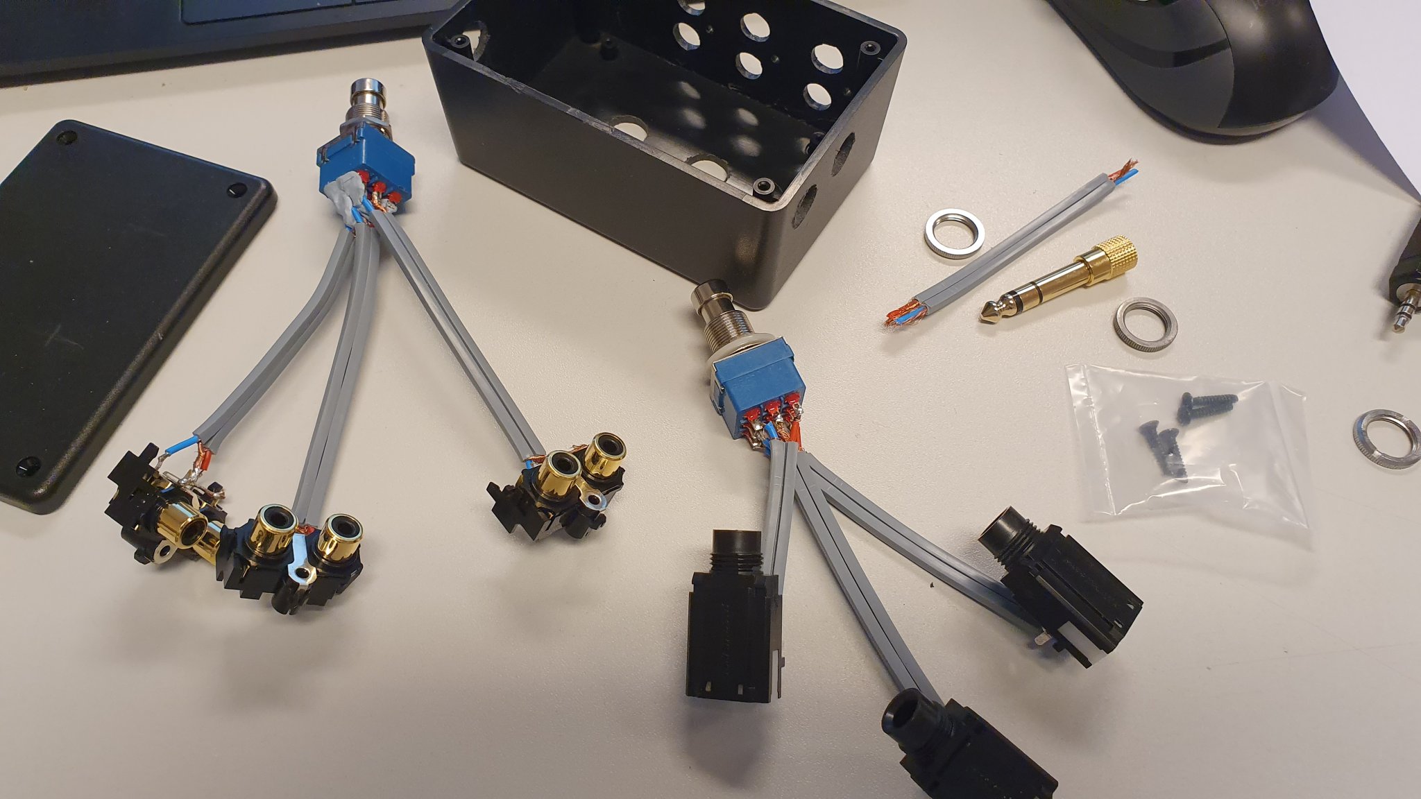

This reminds me of a switch I did using guitar pedal foot button, it could swap both RCAs and Jack, here used to compare two headphones amplifiers (Whammy and JDS Atom)
Oh that's a nice idea too to use 3PDT stompbox switches!👍

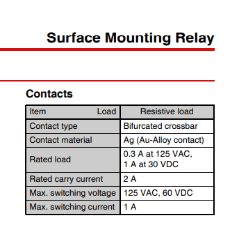

The switch contacts are silver? How much current will be switched? Is the switch for line level signals? If so, then you should be using gold contacts. Silver oxidizes and needs a minimum current density to break down the initial high resistance.
Also, the pics show the RCA connectors are wired to produce a large number of ground loops. The ground loops probably wouldn't be so many in normal operation of the system. Of course ground loops don't just carry line frequency noise. They can carry EMI/RFI which can then cause veiling of the sound and obscure small differences.
However, if you switch grounds with gold switch contacts, the contacts will likely pit before too long due to arcing. It means you need a set of silver contacts to close across the gold contacts while the gold contacts are being switched (again, only needed for switched grounds).

Gold over silver is probably the most common contact material for small-signal relays. A brief summary by another forum member:
https://www.diyaudio.com/community/threads/audio-switching-relay-recommendations.348883/post-7336353
One small signal relay datasheet shows the contacts use gold-alloy material:
https://components.omron.com/us-en/sites/components.omron.com.us/files/datasheet_pdf/K106-E1.pdf
Also, gold plating is used for contact material precision audio attenuators:
https://www.goldpt.com/info.html
"All current models employ thick, hard-gold plated switch contacts"
OTOH, sliver oxide is used on power relays because of its tolerance to arcing. However, a minimum current density is needed to breakdown resistivity of the surface layer.

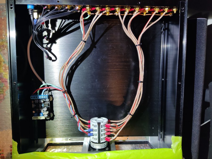

I also have created mine AB tester, but used relays, and a RaspberryPi controlls them. I have written a simple Python program for that.
This approach is better for me, because I can switch from the listening position.
And if its computer controlled it can be double blind without needing someone else, by using random generator.
