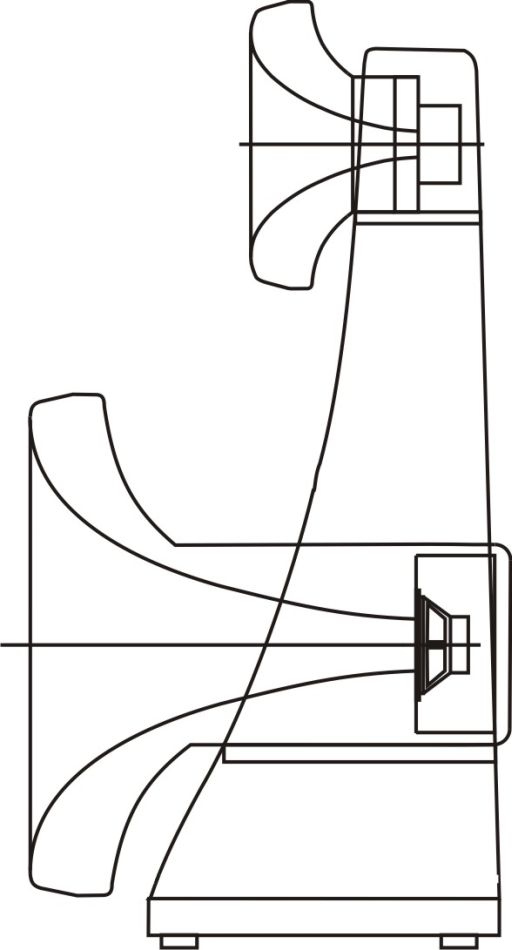

i am building a 4way, full frontloaded Hornsystem. It will be a pair of hornloaded subwoofers, and a pair of 3 way satellites. midbass and midrange channel will use round MDF tractrix horns. At the moment i am working on the midbass horn channel. To turn it, i made a big lathe. The mouth part of the 38" horn weights over 50kgs. Fotos and videos :

cross section
The midbass horn has a normal tractrix profile, but a littlebit more curved on the edge, similar to JMMLC. The horn cannot be turned as one peace. The lathe would not support it. The mouth part is turned separately, and afterwards another two blocks, and then the 3 blocks are glued together. See the last pages on my blog. There is a tutorial step by step, how to build them. I will employ a Fane Studio 8m, 8" driver.
