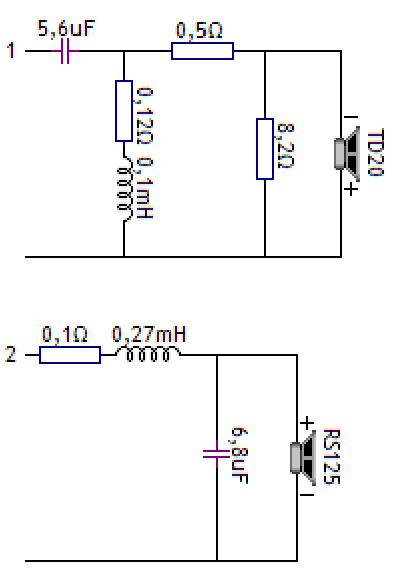

I'm about to finish my first 2 way speakers. I have a problem where my speaker seem to be clipping at a certain volume (DIY 2-way speaker "clipping" - YouTube). It does that no matter the amp. Could this be due to a bad crossover design ? Or a result of my driver reaching its max power handling ?

Bad crossover design > bad impedance/phase seen by the amplifier

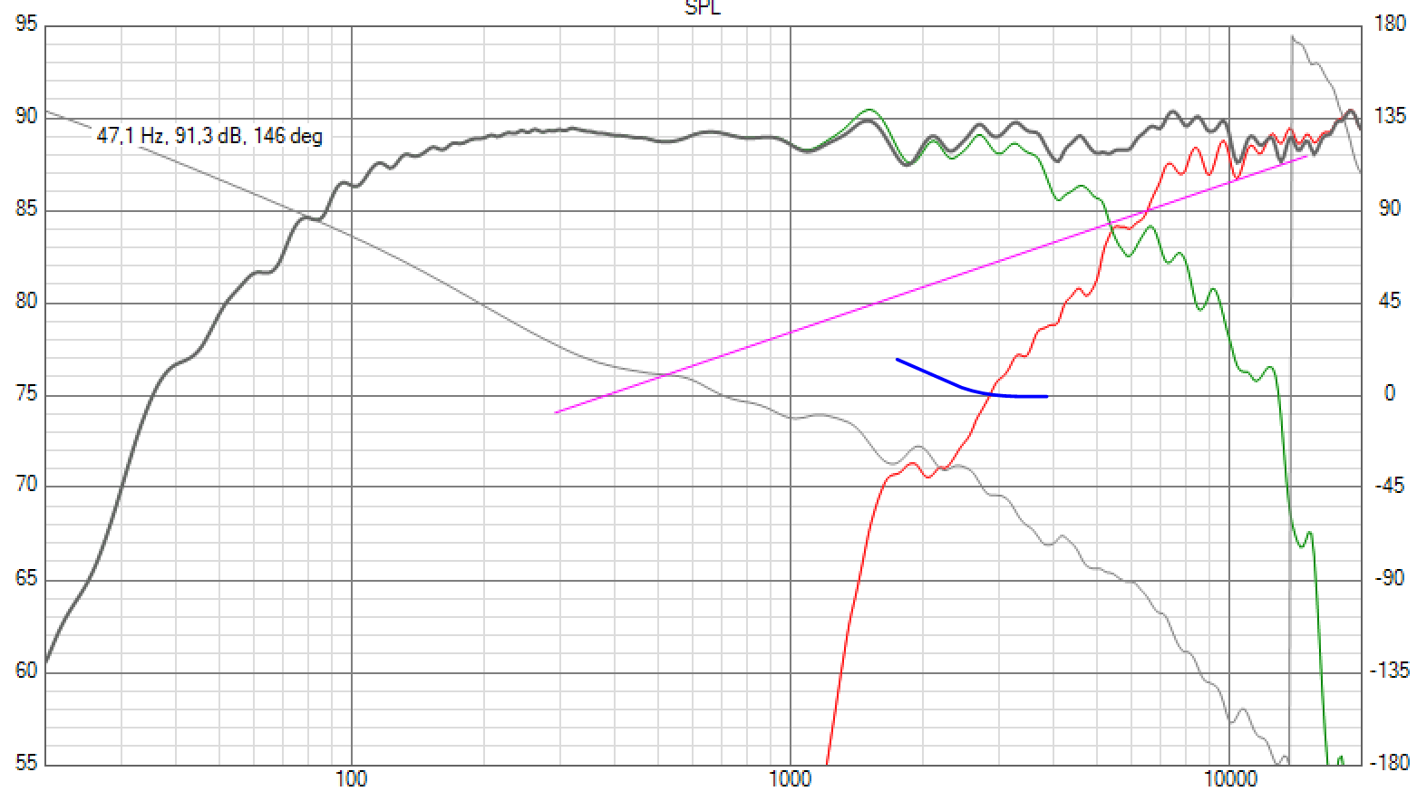

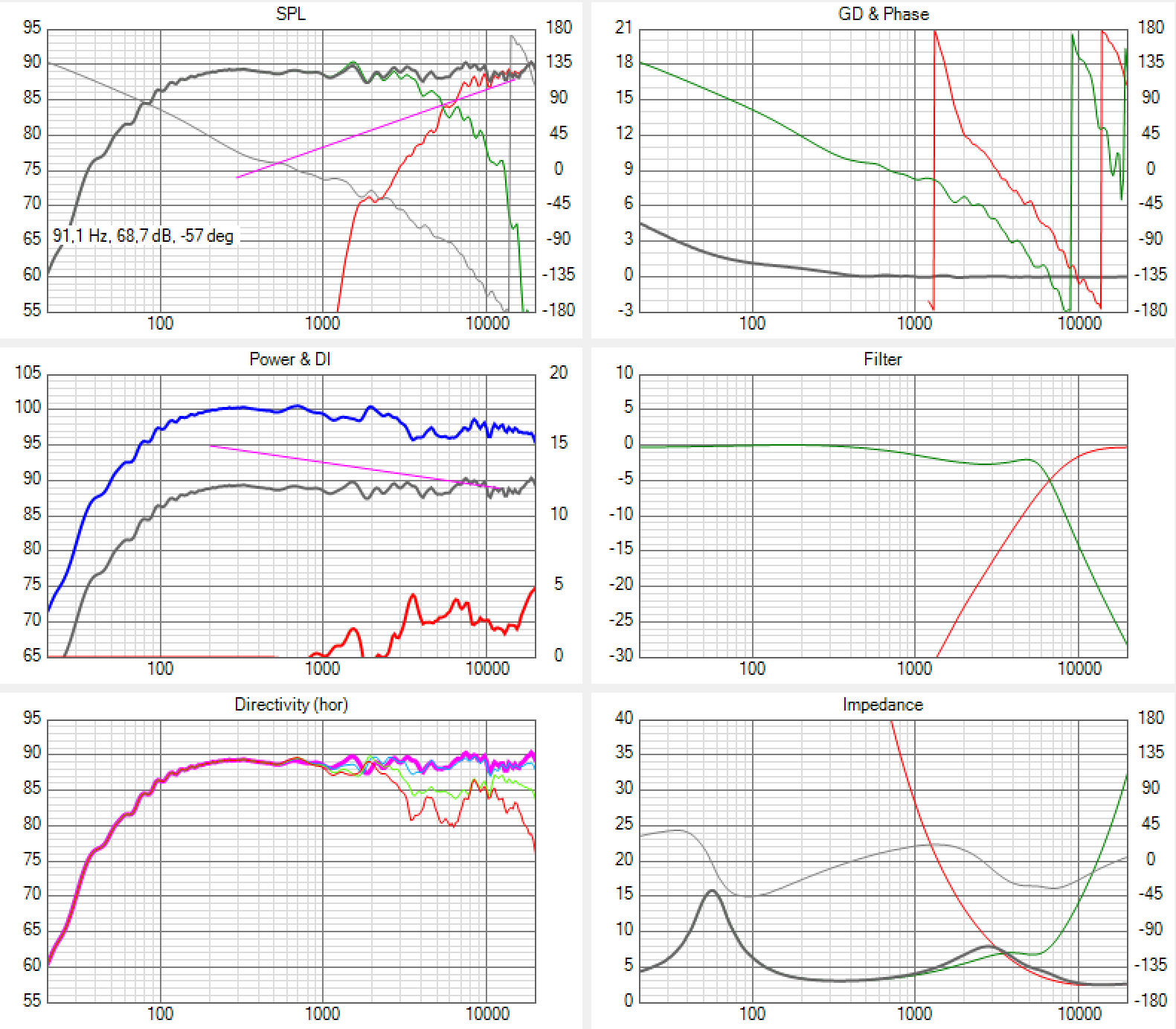

The impedance drops to just over 2 ohms in the high range, this is probably too low for most amps and they go into protection. You might want to increase both resistor values of the L-pad. Anyhow the low impedance in high frequencies seems strange. All drivers increase impedance with frequency - usually!

Your impedance curve dips pretty low in two places over a fairly large area and if your amp isn't designed to drive 4 ohm loads, it will probably go into protect mode because of this.
