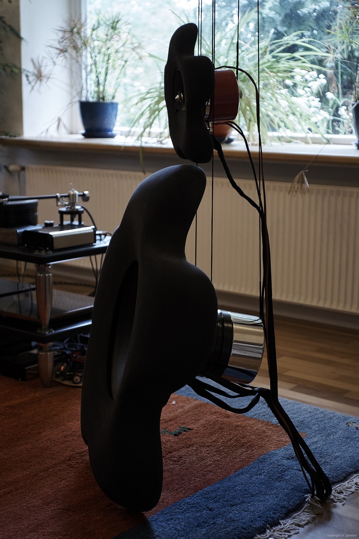

Hej Defo,
I might offer some personal experience gathered over all the years, but please keep in mind it´s just this: personal, no proofs, questionable and so on:
- the wider the dispersion, the further distance from reflective surfaces (walls) is needed. A CD (horn, waveguide, synergy) speaker may be close to the frontwall or corners, but of course this involves other problems. An omni speaker should be wide away from walls.
- In audiophool lingua: controlled (narrow) dispersion gives you the "i am there" illusion. You will notice more of the original recording acoustics.
The wide dispersion (OB, dipole, bipole, omni) speaker gives you the "they are here" illusion. You will notice more of your own room acoustics.
- I have a feeling that a narrow dispersion speaker might be better suited for large orchestra (although I personally would never attempt to try to create the orchestra illusion in a "small" room of 20 m²)
- The wide dispersion speaker, well implemented, might do a better illusion of small (jazz, chamber music, girl/guitar) musical events in a relatively small room.
- The narrower dispersion speaker might be better in precise phantom source localisation (but that depends on many other design criteria as well).
- The wider dispersion speaker might be better in creation of a large "soundstage" (but that depends on many other design criteria as well).
- Any sudden changes and discontinouities of dispersion along the speaker´s passband are not good.
My personal compromise out of this is an OB (but not dipole over the whole passband) system, which can give best of both worlds, but I´m not listening to large orchestra symphonics at all. Instead I like european, especially scandinavian modern jazz. The illusion works, Karl, Tord, Tore and others are here every evening in a 4x6 m room...

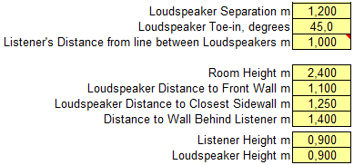

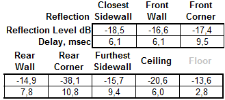

[FONT=Fira Sans, sans-serif]James Heddle[/FONT][FONT=Fira Sans, sans-serif] has developed an Excel-spreadsheet[/FONT] [FONT=Fira Sans, sans-serif]which computes early reflection data for omnipoles and dipoles in rooms of a given size. You can download it at http://www.linkwitzlab.com/LX521/Dipole First Room Reflections SL rev4-b.xls
[/FONT]

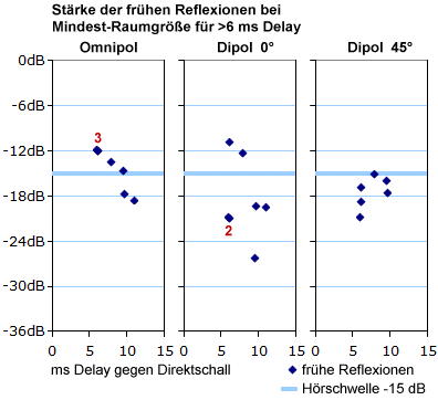

[FONT=Fira Sans, sans-serif]The results for a room of 3,7 x 3,5 m are promising, especially if the dipole is toed in at 45°:[/FONT]
[/FONT]

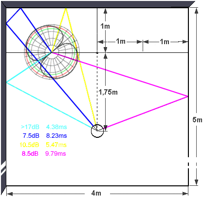

[FONT=Fira Sans, sans-serif]A comparison for an omnipole and dipoles at 0° and 45° shows the advantage of the toed in dipole. All seven first reflections (except floor) stay below -15 dB and above 5 ms delay.[/FONT]
[FONT=Fira Sans, sans-serif]Next figure is an example of a bigger room in which some of the first reflections are demonstrated: closest sidewall (light blue), front wall (yellow), front corner (dark blue), furthest sidewall (red). It is helpful to damp the front wall and corner reflections. The side wall reflections don‘t need attenuation.[/FONT]
Keep in mind that this is valid for a real dipole-8 only. You will need a 3-way system for that. A single fullrange driver above a big woofer won't do the job.

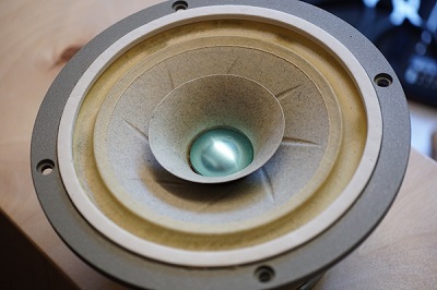

Hi classical,
if you like the Maggies (and there´s a lot to like, had active 1.6 myself for a long time...), try it in your room and try different variants, keeping the speaker clear from the walls.
As your situation in a small room will end up with your goodselve pretty close to the speakers, you might also try a well-balanced fullrange driver which "integrates" well over short distances. This don´t need to be expensive - have a look at the Fast-5 thread.
